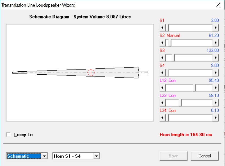

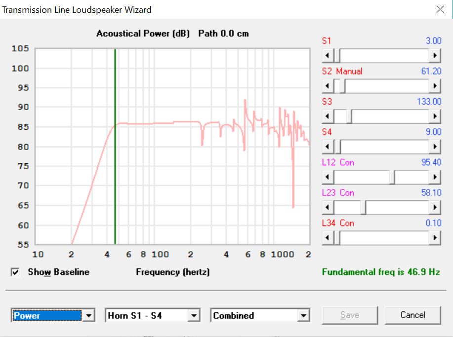

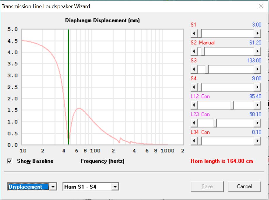

I'm modelling a woofer for a compact TQWT project I am working on. It will, in turn, become a 2 way system within a yet to be decided tweeter. My aim is for a short and compact pair of floor standers for medium to near field listening.
The mid-woofer is the SB Acoustics SB12PFC25-4.
4" SB12PFC25-4 :: SB Acoustics
4-5mm XMAX and low FS so I feel I should be able to get politely low on hertz.
154cm line (not including the mass loaded vent)
Can Anyone give me feedback on this please?
Am I pushing this driver too far?
Cheers!

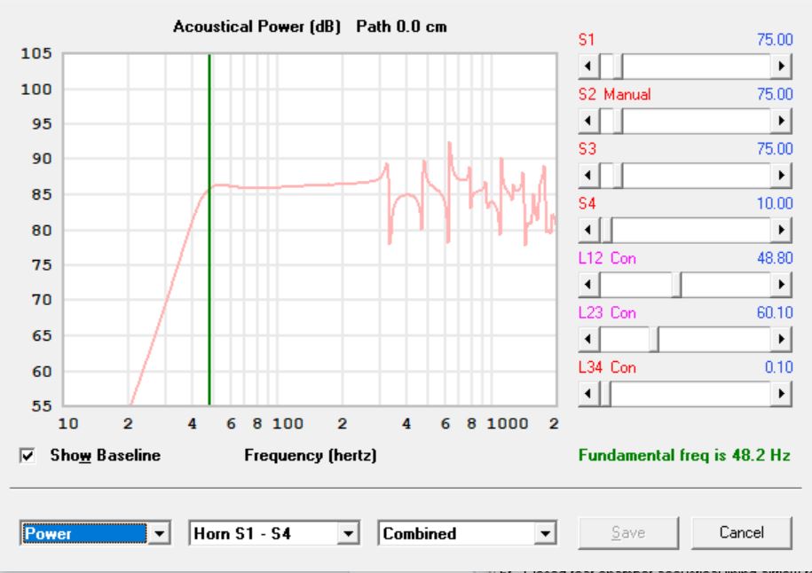

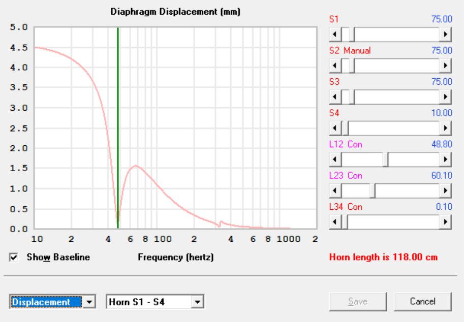

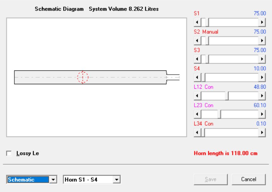

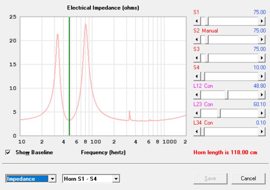

Straight MLTL
Here's a straight MLTL as an alternative:
109cm line length (not including port)
75cm cross section
9cm x 3.5cm port
Fundamental frequency is 48.2hz
attachment.php
attachment.php
attachment.php
attachment.php
Thoughts anyone?
Cheers!

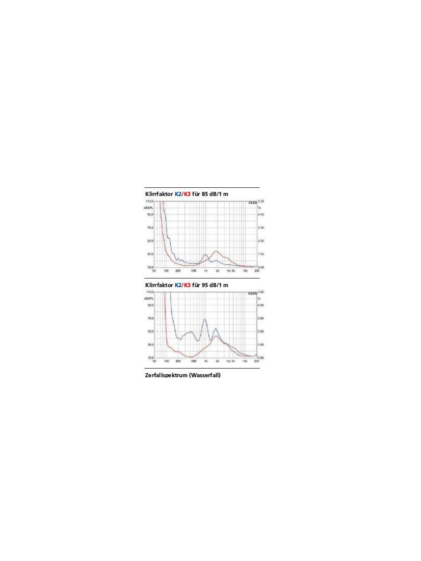

FWIW My BR model has it reaching an F3 of ~36 Hz in 12L tuned to 40Hz. IIRC, these PFC drivers all have a distortion plateau at ~ 1Khz, so it might be better used as bass support for a full ranger such as Dayton PS75 or Peerless TG9... in which case I'd use the 5" version...

Based on published specs, this is what I'd recommend. Lowest practical reflex tuning is a 1/2 octave below Fs = ~0.707*58 = ~41 Hz, so you're fine.
GM
Thanks, Greg! I always gleen some wisdom from you! But, how to push the driver lower? It doesn't behave too well, plot-wise, below 47/48hz. I will continue to tinker.

This is all academic at the moment as the drivers have not arrived yet and I haven't heard this distortion nor been able to find any info on it. Perhaps Pete can help me out here, please?
It may be that a normal crossover configuration works just fine for this budget build but we will have to see once they get here!
I think Klang & Ton did tests on all the PFC drivers when they came out, Google & you're sure to find them. I have them, but not sure which computer they're on... I'll have a look
edit: K&T June/July 2017 p46

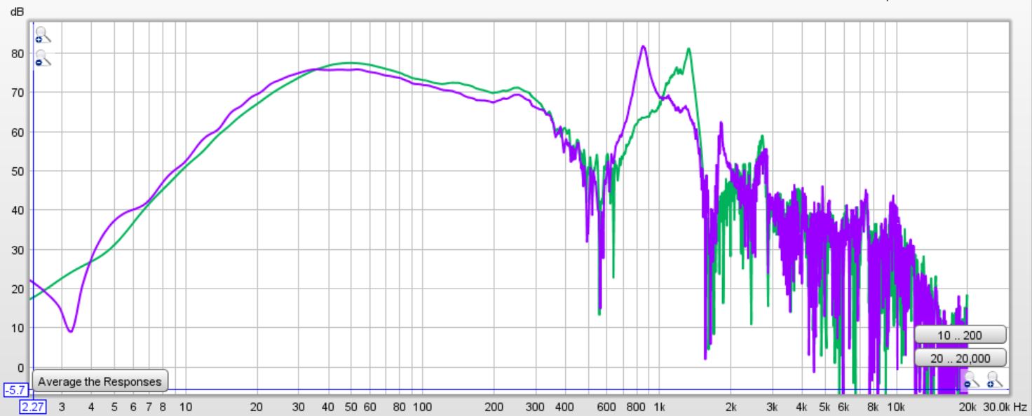

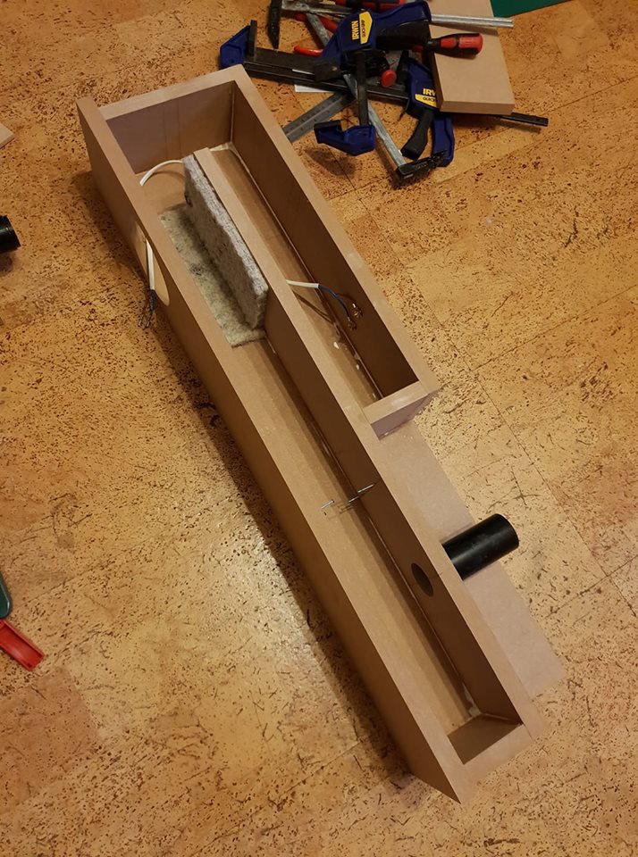

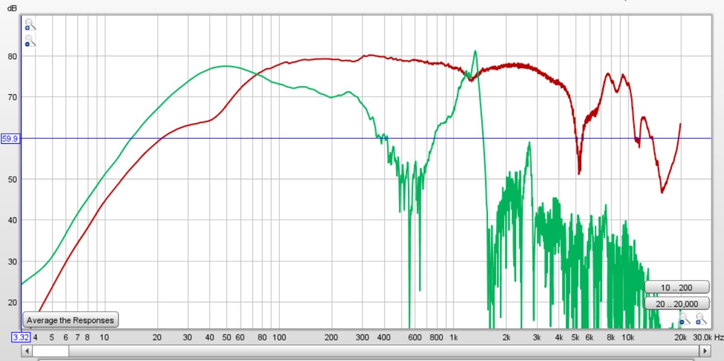

Evening all. Here is the measurement of the single folded prototype. 80g of stuffing, I think I will revert back to my initial 60g.
But what is really weird is the measurement I got from the port on its own. There is a massive spike between 600-1800hz. It doesn't appear to effect overall combined output but what the hell is it?
I shifted the port up to 15cm from the bottom but I expected to see less ripple not more?
Measurements summed and adjusted by -6.6db in xsim.
I had a moment this evening to test a couple of things.
First of all changed the driver for the second one I have for the pair. No dice.
Second of all I thought I'd see what happened if I added some length to the port to see how the FR reacted. I added 2 inches of pipe and the peak has clearly moved. I am now thinking that I have just picked a really awful spot for the port to be placed (15cm from the bottom of the line).
I have expoxied two more ports on my previous prototype to see if in the unfolded version the port placement gives the same results in the unfolded version. The second port I glued was the same diameter but at the bottom of the line. Let's see..
Green is correct tuning and purple is with 2 inch extension.
