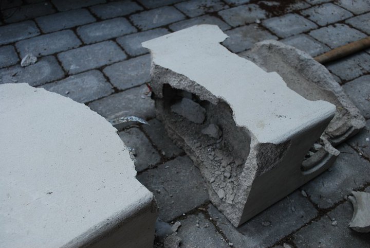

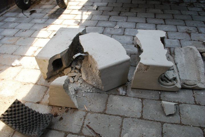

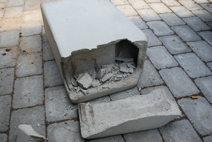

Yesterday I was cleaning up behind the garage and find this, one year old, speaker :) I didn't manage to get hold of any high concentration delimonine so I didn't tried that out. There was never a #2 of this speaker.
Before I threw it away I crashed it with a sledge hammer to see how good I had managed to get the EPS out.
The result, shown in the pictures, was quite good. Some fragment are still left but my guess is that 99% is gone.
Regards Håkan
