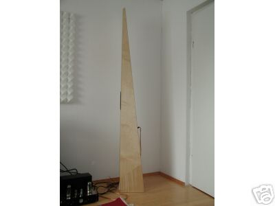

Me and my friend are about to build our first pairs of fullrange speakers.
We will use the new Fostex FE166ESR drivers.
A tall tapered nonfolded quarterwave constuction.

Please elaborate further why you choose the original backloaded horn construction. My friend favours that one, I like the estetics of a tall, slim speaker.
The drivers are recently just ordered so we are in no hurry to build. I will follow the other thread to see what conclusions you guys come up with. The hybrid Karlson/Transmission Line cabinet looks interesting.

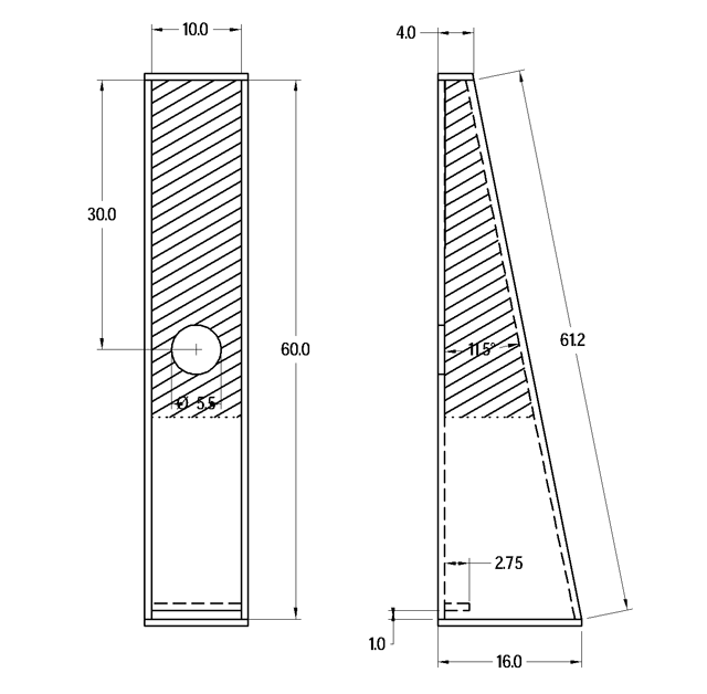

I have built number of MLTLs and decided to go for something different. Plus the back loaded horn sounded interesting and I have heard good reports on its performance with this driver. Not a lot of deep thinking went into this decision.
If you decide to go with the TQWP, I suggest you use a round tube port. I put a slot port like that in one of my designs, and it did not behave like I expected. I had to shorten it quite a bit, and it was not easy to do. Tube ports are easier to tune. Just something to think about.

The relatively recent ML-TQWT studies have shown that -- typically -- a port smaller than driver area is best.
Actually driver area does not affect any aspect of the design of a TQWT other than that it is a conveinient fixed parameter. The parameter of interest is the Vas.

What it looked like you were considering building, from the drawing at least, is a mass loaded TQWP. Essentially the air in the port helps to determine the tuning frequency of the enclosure. It's sort of a bass reflex, TQWP hybrid.
I believe the suggestion to make the terminus equal to Sd is from an older "rule of thumb" type approach TQWP design. My first speaker project was like this-and while it sounded quite good, it was far from optimal. I think you can get more predictable, and far flatter response from a mass loaded pipe, like MJK's mathcad worksheets allow you to design.
The way I approach this, is to start by modelling a BR enclosure for the driver I want to use with a program like WinISD (free too!). Then I use the recommended box volume and port geometry as a starting point for a design. I model that as a tall thin tapered pipe in martins ML TQWP, or BR worksheet. Typically, you will need to shorten the port considerably, and play around with Vb. Start with a reasonable line length-usually less than 60". Begin with the speaker at 1/2 of the line length and move it up or down to flatten out some of the ripple caused by the 2nd or 3rd pipe harmonic. If you try to vary only one parameter at a time, then you can get a feel for how different changes affect the response, and zone in on a near optimal design. I like to design with no stuffing, it allows me to see how close I am getting.

FYI, it's no R-O-T, but what is required for peak efficiency at Fb and actually is spelled out in the original bass reflex patent of 1932. What has been learned in recent decades is that you don't necessarily want peak efficiency at Fb.I believe the suggestion to make the terminus equal to Sd is from an older "rule of thumb" type approach TQWP design.

I'm a newbie at speaker construction, so this feedback is highly appreciated. I will download the WinISD and make my virtual model from there. Feels a bit odd to start with a BR construction, but with the port it makes sense. Some of the terminology and parameters that is used is unknown to me.
