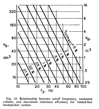

My knee-jerk response is you'll need an amplifier to drive the speaker and you can't fool Mother Nature, so box size will need to meet these acoustic limitations [attached].
Good luck with it!
GM, thanks for the graph.
I forgot to mention that the current volume of the guitar body is 91 dm^3 , so it is comparable to the size of the Guitarrón Mexcicano, and the acoustic line length is roughly 1.7 meters, that is the dashed line.
As far as I know the 3/4 double bass's displacement is about 110-120 dm^3, and I was just thinking, that the size could be reduced with 20 something percent with some trick :)
You're welcome!
Well, can't beat the graph, but you can 'cheat' in that with the right driver at a 2:1 CR [Sd/2] + 4x power gets an = SPL. The problem then becomes finding a [compact enough] driver with sufficent power handling to do it.
Not saying you can't do it, but don't have the time to research it as I don't keep up with what all's available driver wise.

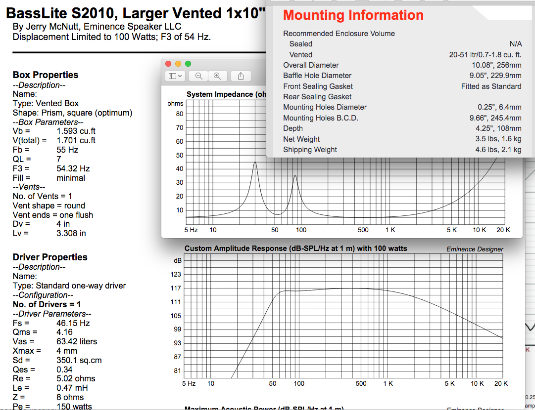

4)I have included an example below of a design that could be incorporated into a Guitarron sized instrument, using a relatively thin and lightweight (3.5 lbs, 1.6kg) neodymium magnet driver. The amplitude response with 100 watts at 40 Hz (just below Low E on a bass guitar) is 105 dB, one watt would produce 10 dB less, or 95 dB.
5) With the example given, the volume (total) is 1.7 cubic feet, about 48 liters. The 40 Hz output could be slightly increased by lowering the Fb (box tuning frequency) from 55Hz to 46 Hz, with a slight decrease in the range from Fb to around 100 Hz.
This example uses larger driver than Luigiman’s bass instrument, because of the increased sensitivity, it would require a fraction of the power to achieve the same output level.
6) By “enclosure resonance”, I meant Fb.
Speaker box material for sound reproduction is generally desired to be non-resonant to avoid “ringing”. Most use bracing to reduce upper resonances without much weight penalty, but using exceptionally heavy materials like concrete, sand sandwich construction is sometimes employed.
For a musical instrument, the upper resonances of light wood are desirable.

Art,
To be honest, I learned more from this last reply than in the past few days, trying to gather some theory from here and there..
As a newbie asking beginner's question on an other forum, like for example Stackoverflow I would have been kicked off wihtout hesitation :D
The next thing is (now with a basic understanding of loudspeakers), to try to make a simulation myself, like the one whose results you attached
And again: thanks very much.
Gabor
Gabor,
I used the Eminence example because it was available with no work other than copying, they have several cabinet designs available on line for almost all their speakers.
Comparing them is a good introduction to speaker simulation, helps to see mistakes when you get started that can make it seem like you have just designed the greatest little sub, then find it was 300 instead of 30 litres..
