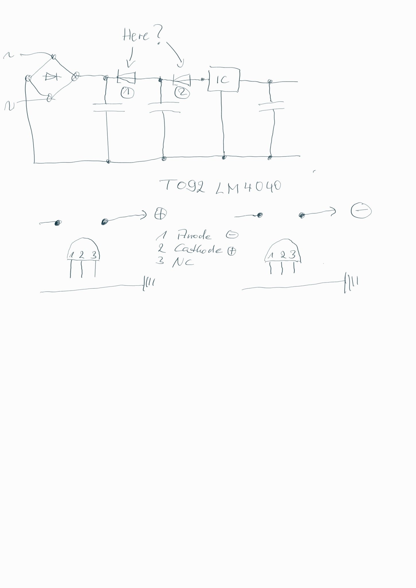

Thanks for the answer Jan.
I have to apologize for my following somewhat stupid questions. I am experienced and good at building amplifiers etc. from a schematic. Also on a grid board or point to point. Thank you dad for the lego you gave me as a kid🙂.
,I understand Ohm's law and recognize all components in a circuit diagram.
But I'm too stupid for anything beyond that.
If I understand correctly, a zener diode is connected in series in blocking direction to the + line or vice versa to the - line. The voltage that is written on the zener diode then drops across the zener diode. I have to dimension the diode for the burned VA. For example, I would use a 2.1V zener diode with >/= 1 watt load capacity.
What is the best position (1? 2?) to place the diode?
How would I fit the LM4040?
For fools: Which leg do I solder where? I would prefer to use the version with TO92 housing. The TO92 needs a heat sink, doesn't it?
Thank you very much for your help and patience with me.

Clearly you are not stupid, maybe less experienced. That will chance fast!
Actually position 1 is interesting, but I would not do it.
Why? The current there is not DC but is a pulse, everytime (in the mains rhythm, or double that) the cap gets charged.
A small zener may not like high peak-to-average currents.
Pos 2 would be fine.
An LM4040 works just like a zener, both are a shunt regulator.
The most pos point is the anode, which is the same as the zener 'Z' symbol side.
So your schematic sketch for the LM4040 is incorrect. And it has no ground connection, just use it as the zener. NC means no connection.
Makes sense?

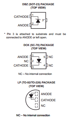

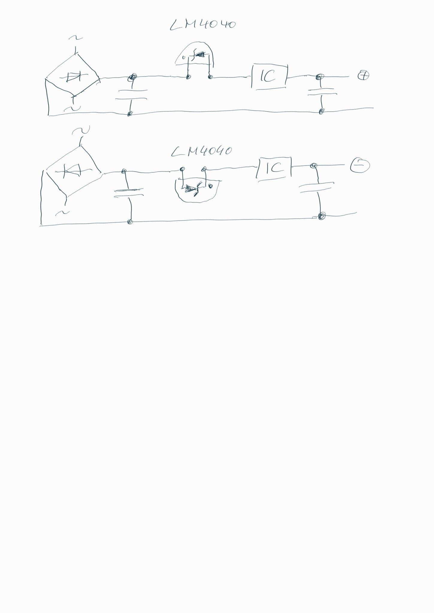

Hi Jan,
I think I got it. Just to be on the safe side, I recorded my findings in a sketch.
Can you please give me a short confirmation that the circuit diagram is correct.
I also attached the pinout of the LM4040 for comparison.
Thanks again for your help.
Best, Niels
Best, Niels
If you are using linear regulators and the raw voltage is too high, then using an active rectifier is twice a bad idea. If you must use those LDO's then a pre-regulator (~cascode) is the best plan as it will drop more or less as required. It could be a LM317HV or similar if you don't want to do it with discrete transistors, which could be almost as simple. But I also think that these LDO are a bad choice for an output voltage so near the max raw input.
