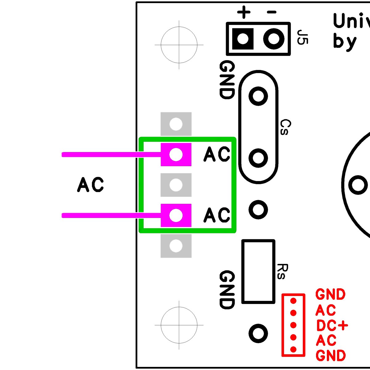

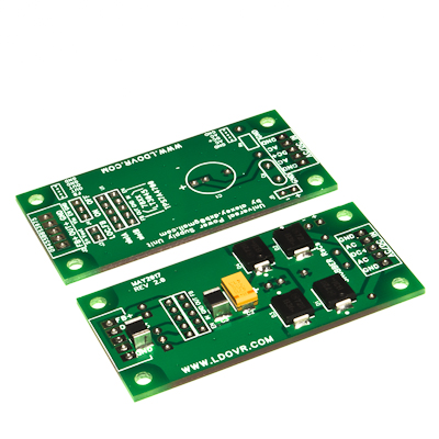

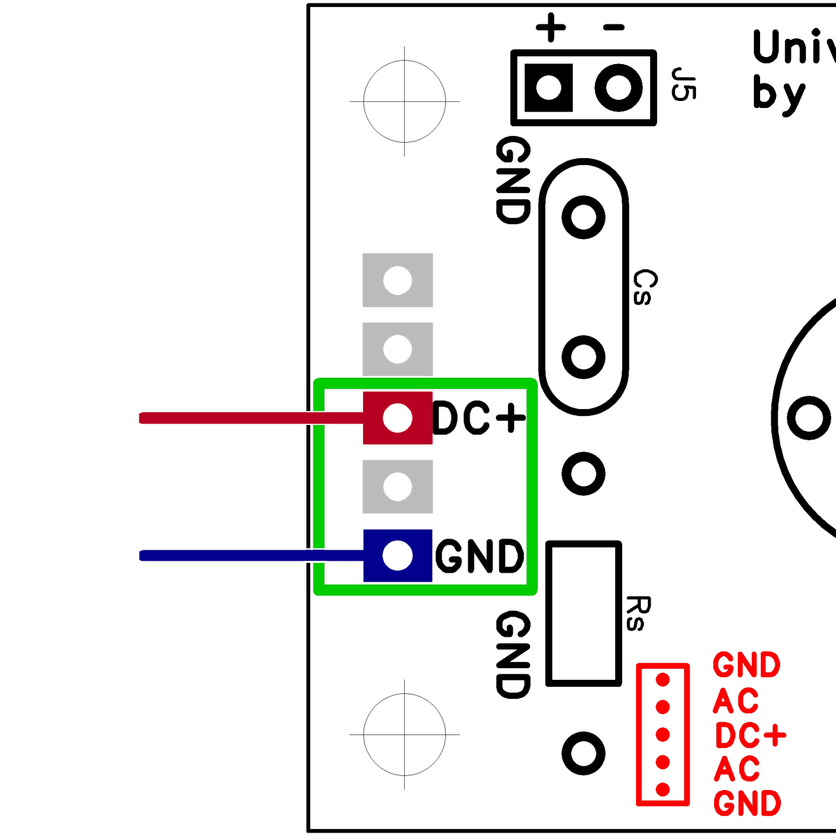

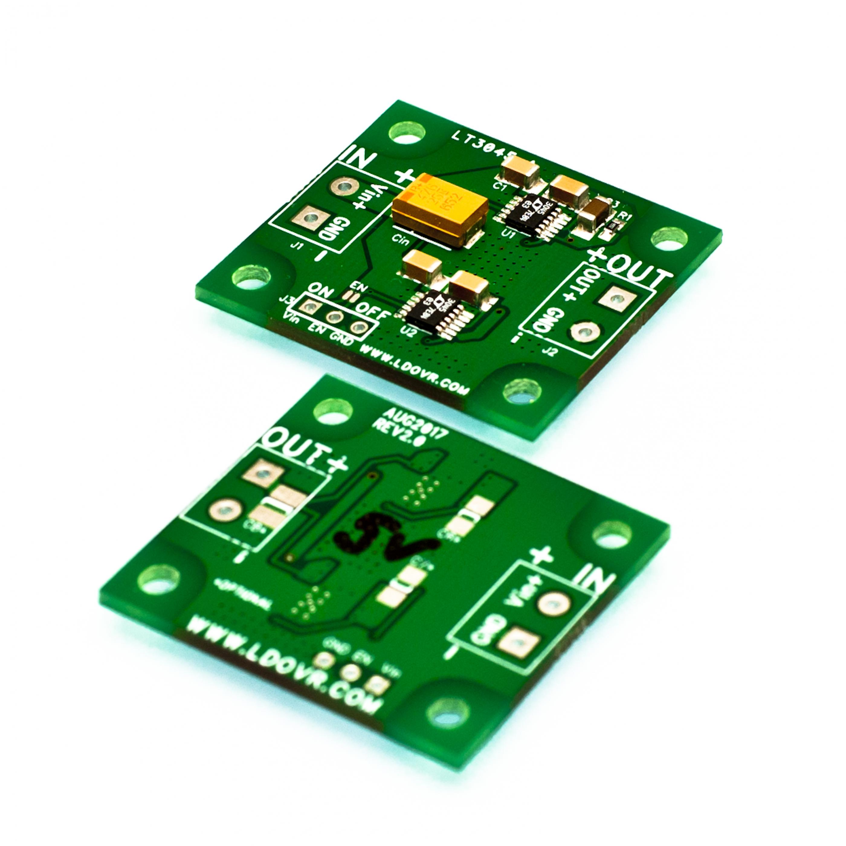

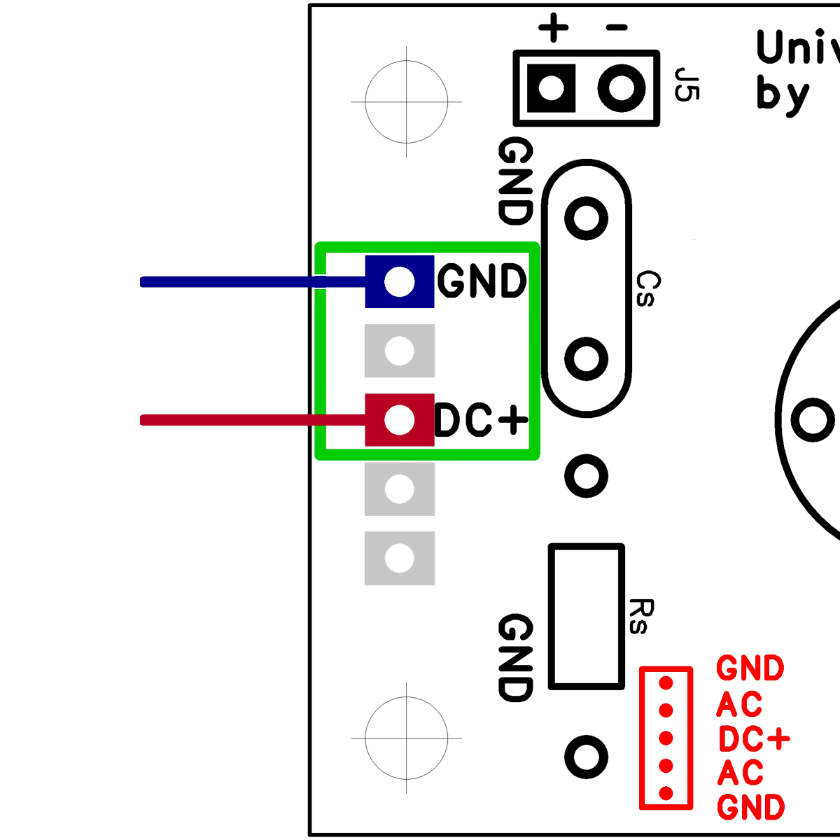

Redesigned Power Supply PCB
Redesigned Power Supply Main PCB v2.0 released
Different options for Power Supply inputs and outputs
- AC input
- DC input (bypassing rectifier)
- 2 wire load connection (if external feedback not used you can install 2Pin Power Screw Terminal Connector
- 3 wire load connections with external feedback

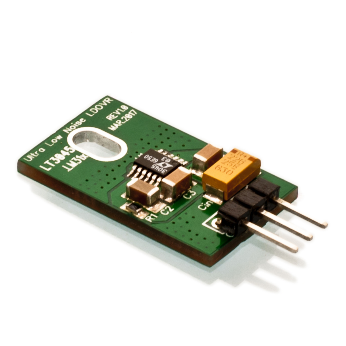

Can be used with TPS7A4700-78XX 5PIN reg board or LT3045-78XX 3PIN Regulator Board (for LT3045 boards - no ON/OFF and external feedback functionality)
- AC input
Dual Polarity Power Supply re-stocked @ www.ldovr.com and Ebay
redesigned Power Supply Board
including
- AC input
- 2 wire load connection - if external feedback not used you can install 2Pin Power Screw Terminal Connector
including
- AC input

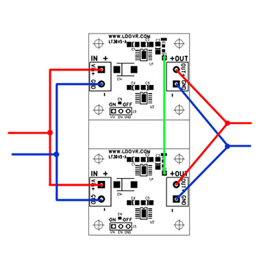

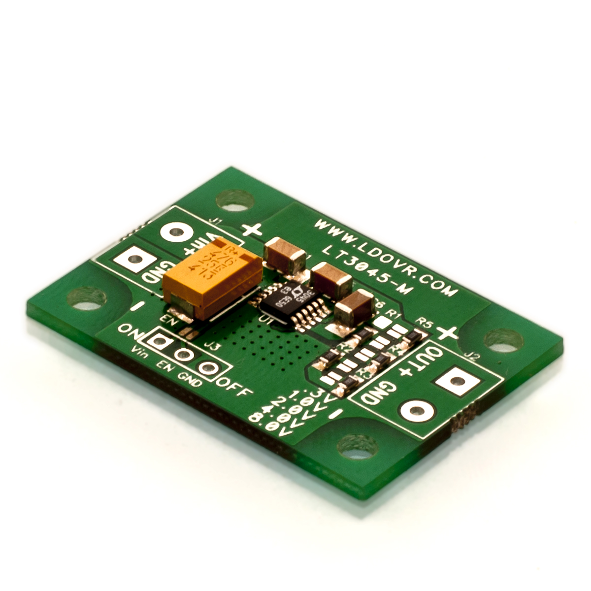

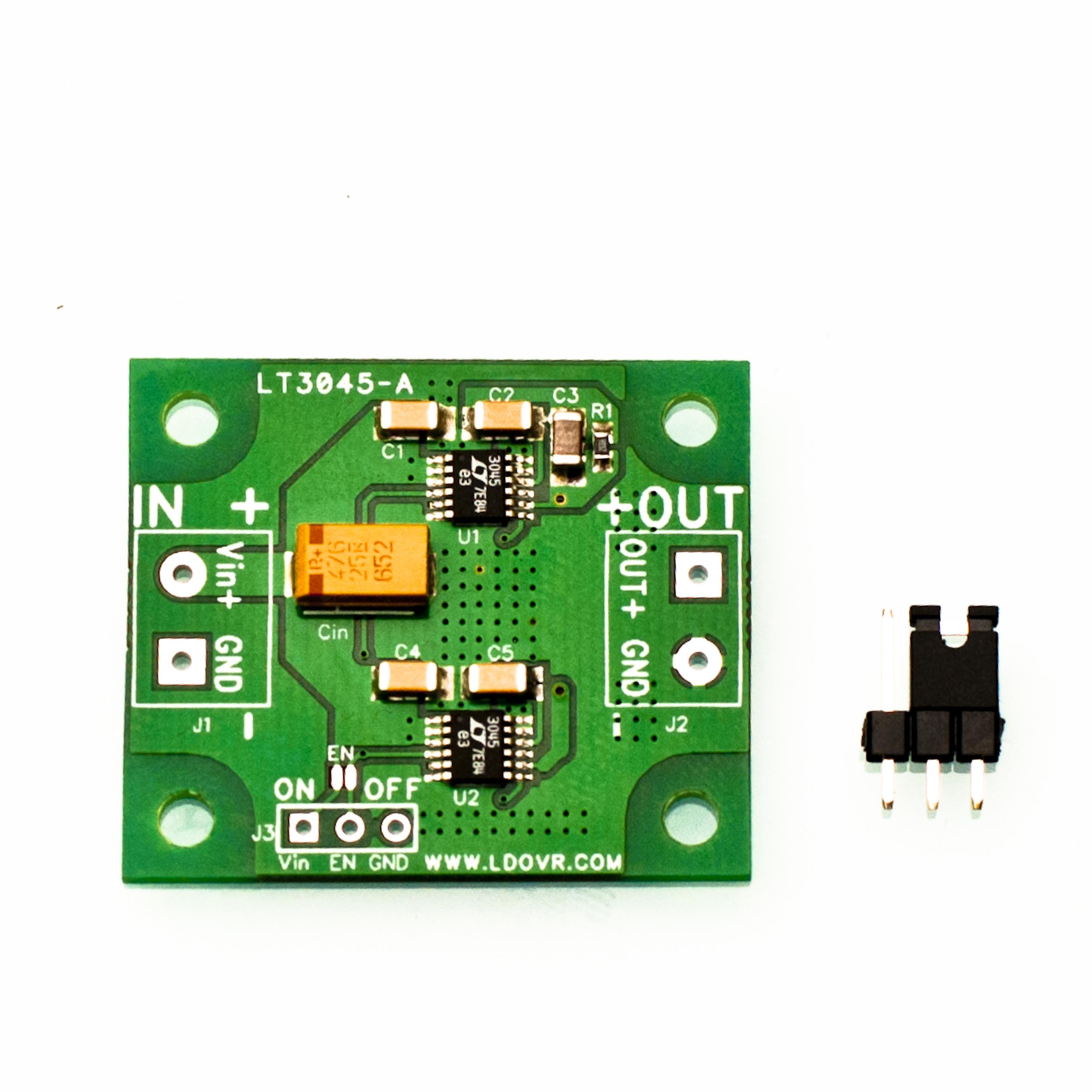

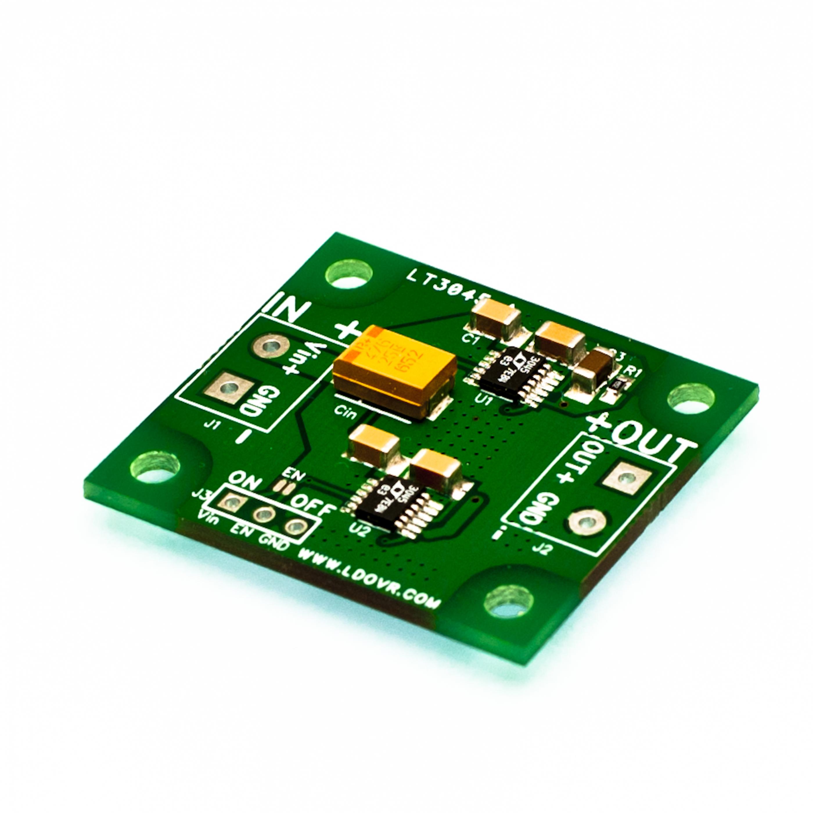

Recent revision of dual-LT3045 (1A) board can be easily paralleled to get more current (2A, 3A etc)

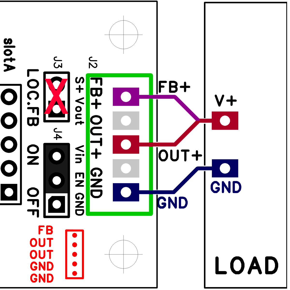

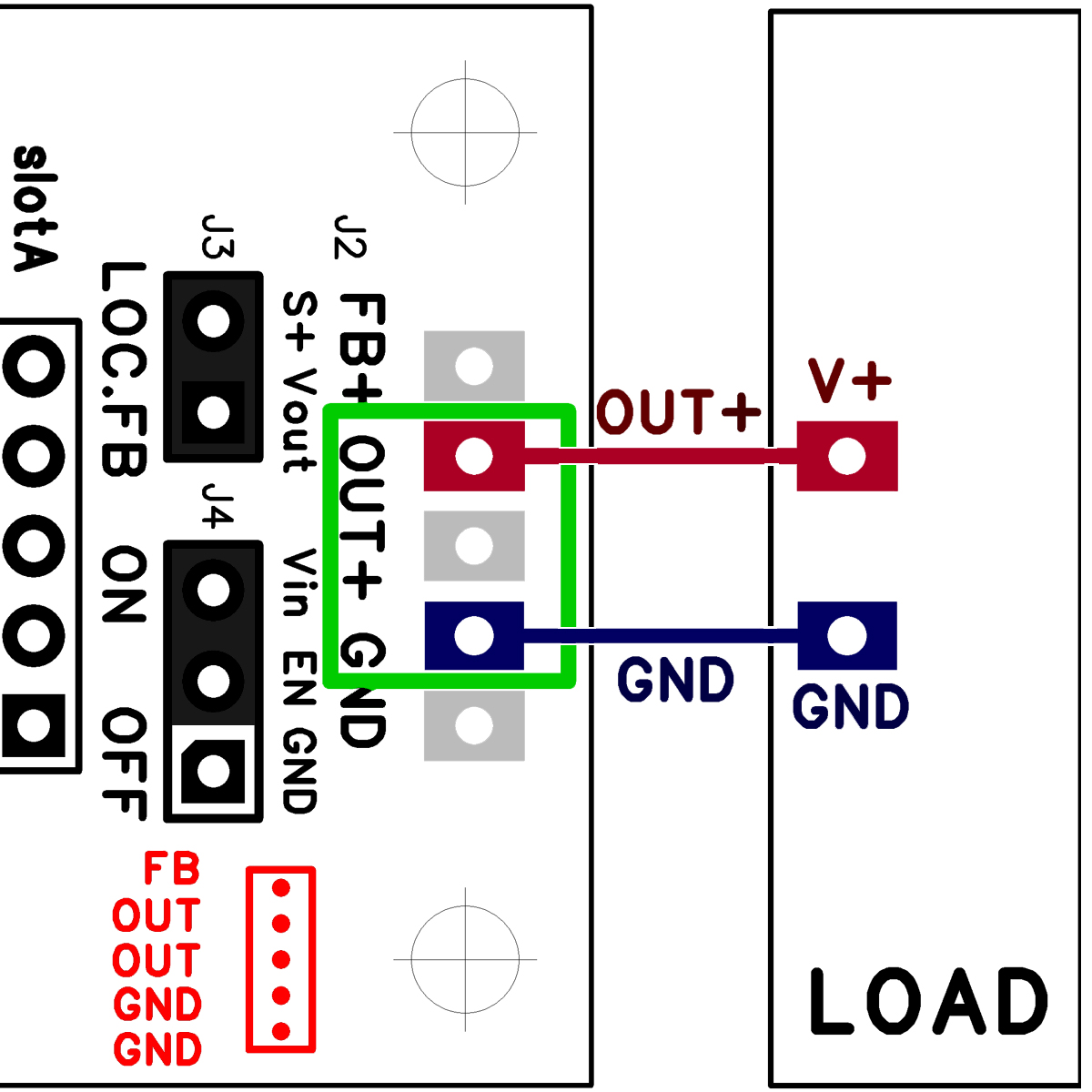

Two questions:
1) what is the purpose of the jumper EN?
2) what is the purpose of the green line joining two boards?
Thanks!
I beleive the En jumper and the solder pad enable you to use the regulator without feedback from the load- Kelvin sense. I use mine with the jumper.
The green line lets you link two boards and common the output of both for current sharing duties.

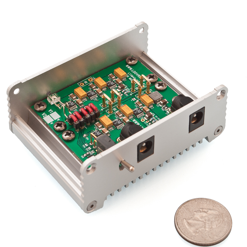

I have one, it works well on modest current's but I need a solution for heatsinking it at 12v/12.2v and 1 amp. Think i'm going to use a heat spreader on the underside.

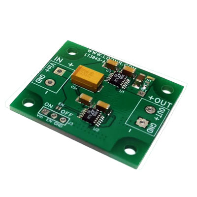

is it necessary to heatsink the dual Lt3045 for higher loads, is it even possible with this board? anyone try?

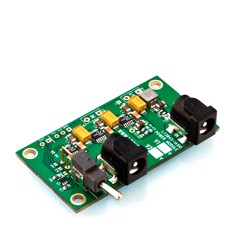

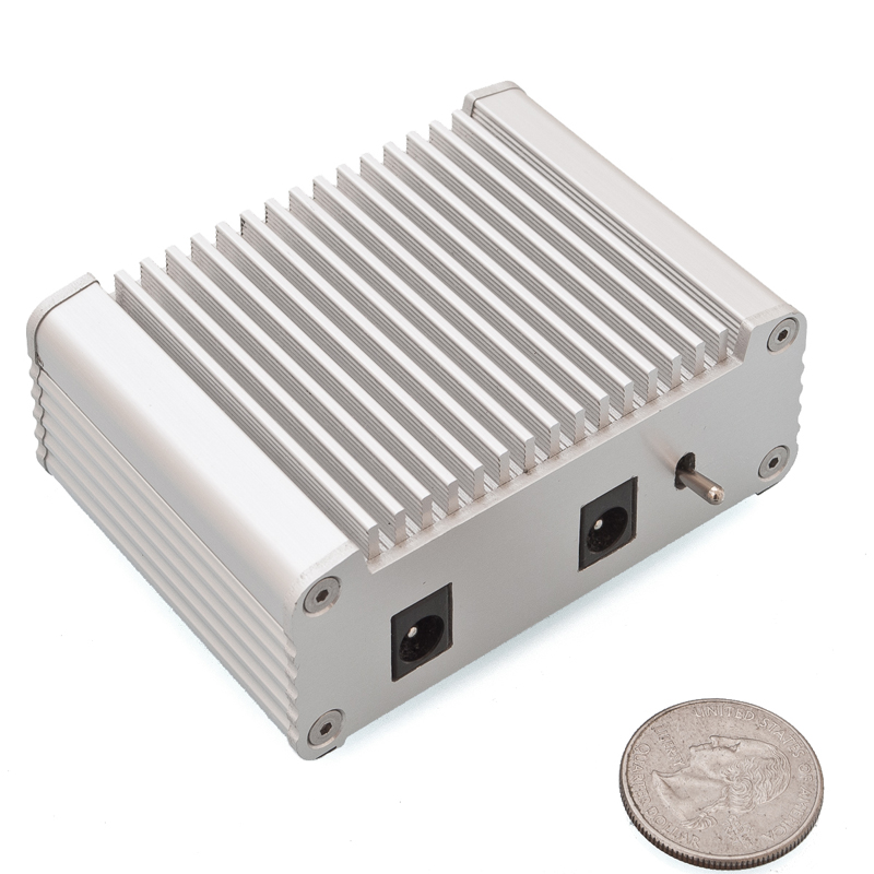

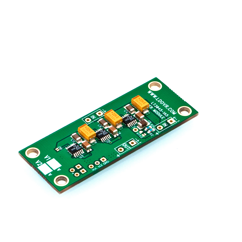

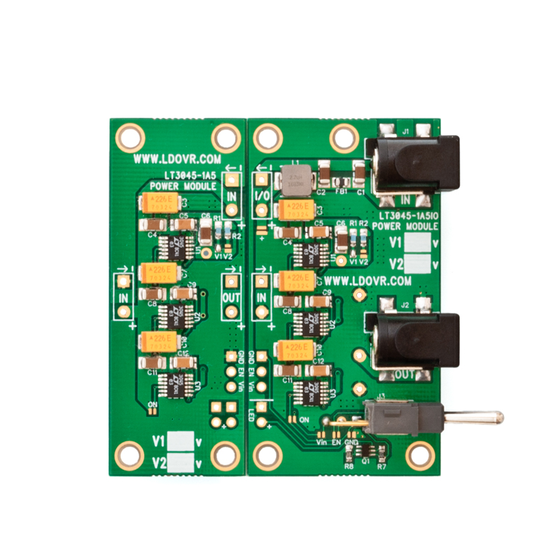

2 new boards released
LT3045-1A5IO (32.5mm x 60mm)
3 x LT3045 Board, 0-15V, 1.5A
2 x setting resistors (can change output by soldering one of two setting pad)
LCLCL Input Filter
5.5mm x 2.1mm DC Input and Output Connector
On/Off Switch
Power LED
Current Limiter circuit for Power Led (Led Brightness does not depend on Input voltage)
LT3045-1A5 (23.5mm x 60mm)
3 x LT3045 Board, 0-15V , 1.5A
Enable Input for external On/Off Switch (can be permanently enabled)
Matting with LT3045-1A5IO board layout for easy interconnection (serial connection)
2 boards can be paralleled

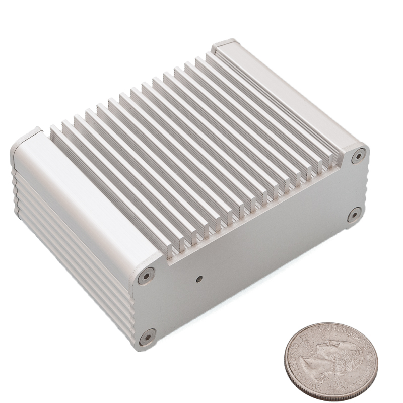

Heatsink chassis coming soon
PM for more details
LCLCL Input Filter
On/Off Switch
Power LED
PM for more details
Very necessary, mine craps out after 30 seconds at 12v 800mA with .2v drop.
These cases look good, I'm in.
are you talking about LT3045A board?Very necessary, mine craps out after 30 seconds at 12v 800mA with .2v drop.
Should work (can work with upto 2W dissipated power with ambient temp 25C)
0.2V drop not enough for LT3045
