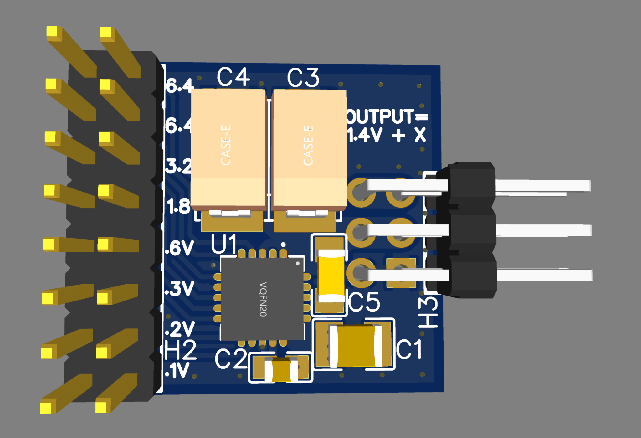

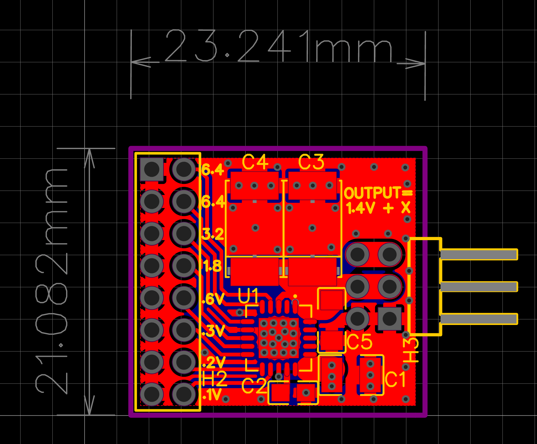

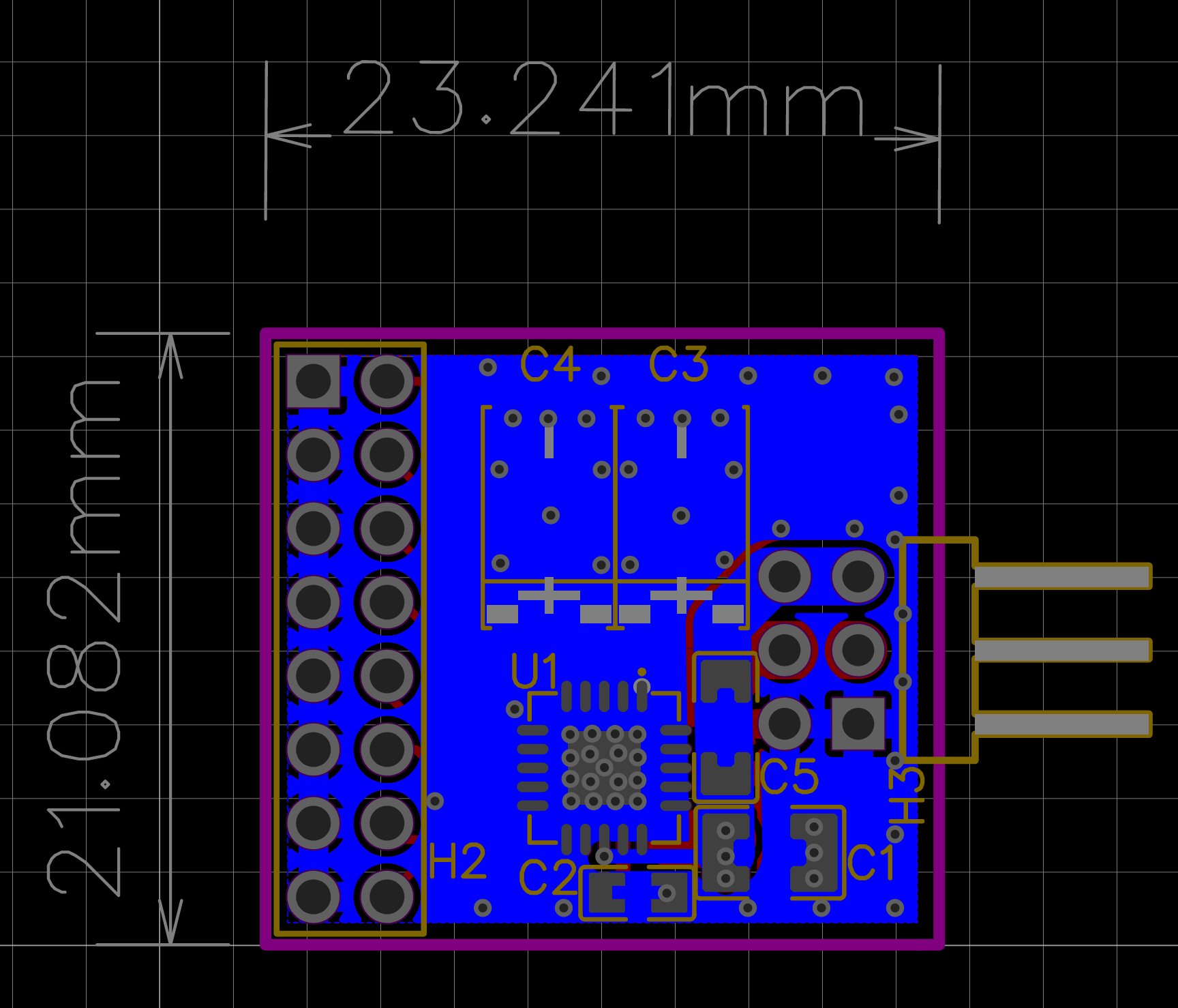

this is how it looks now:
Looks also more tidy with the tant caps 🙂
i watched a video about 2layer vs 4layer, so the important part is to keep the overall "loop area" in mind right? i think i done a fairly good job now to keep it small... the tant output caps have the largest loop area, just because of the size
Also i saw the ldvor board uses many vias under the TPS chip, i guess for heat desipation, i also added those
im not as concerned about the tant output caps, they have together only 30mohms ESR + the 100nF C0G
