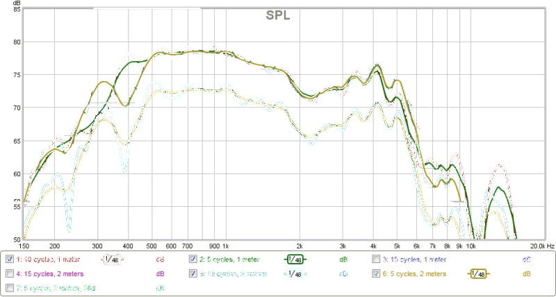

Comparison seems to suggest the shape close to the back of the driver could be affecting the highs and the depth might be affecting the lows.

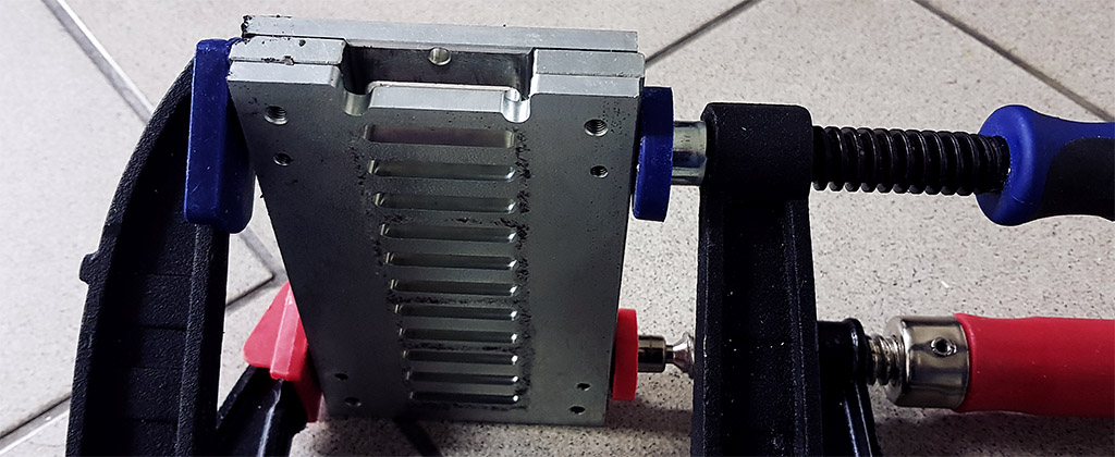

So first I attach the virgin frame to my cnc machine frontside up.

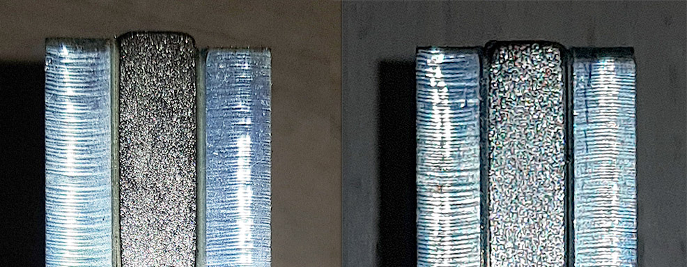

Started to drill. Decided to put 3 medium size holes to each bar. Didn't want to go overboard.
Then added a 45 degree chamfer to the slots. And why 45? Had this cutting tool already, so just used that one.
Finished and wire brushed the top to clean the burrs. But the most laborious part was to clean the magnet gap inside. The magnets are super strong and what goes in wants to stay there. And when you get the big ones out there is a lof of small metal dust there which I removed by using Gorilla tape with strong glue. Took hours to do a perfect job. 🙄

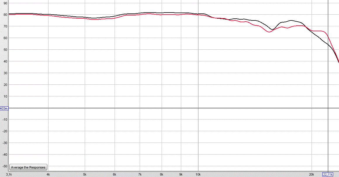

Sensitivity dropped exactly 1 db, which is good. 2 db would have been a little too much for my taste.. Of course it depends on what you compare it to. If some change really is beneficial to the sound quality and you can't find a product from the market which would be similar, then you just must accept even a 3 db drop.
I didn't know how the changes will effect the frequency response, but I did pretty much guess, that making the front more open and uniform cannot make it sound more worse. And it didn't. I haven't had time to listen very much, but the first tests were promising. Also the measurements showed a surprise.
At 19.5 khz the responses are still even, but then my version extends all the way to almost 22 khz. Now, since I'm not 15 anymore, I can't hear this high, but it's an indication, that the playback might be more natural a bit lower also.
Btw that dip that you see on both responses at around 15 khz, it's not there anymore, when you take the microphone more far away from the wave guide.
Also it's good to note, that the back chamber was not attached during the measurement. I haven't used that in years because it's so bad. Instead, there was some damping material and behind that a pillow as you might see from the previous posts picture.

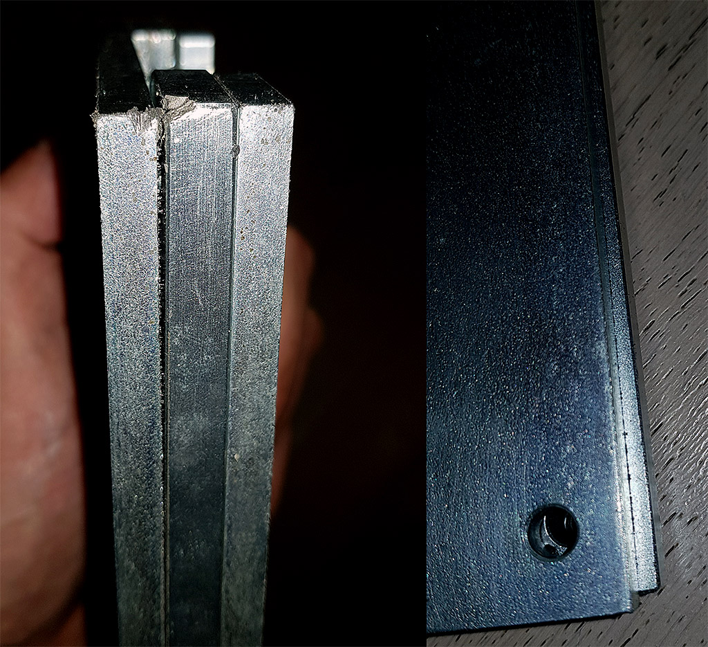

I live in two places, so I sent the tweeters for my other location for listening. And while there was plenty of cardboard, something sharp and apparently made of hardened steel had pierced the packet during shipping and hit the tweeter. Disaster! I thought. At least I had been smart enough to put the membrane to my backback instead inside the frame, because it would have been crushed on the sideways movement.

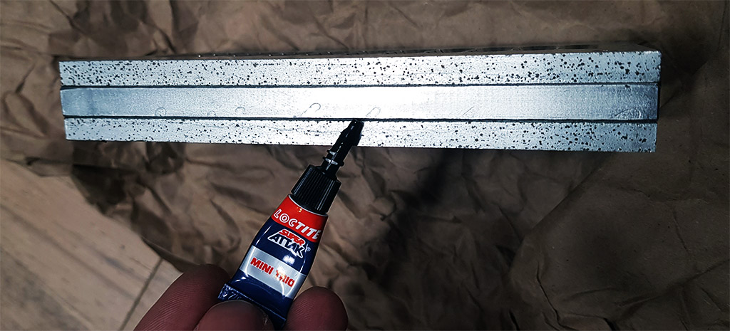

It was a lot of work to modify the tweeter so I decided to try to sort it out. And luckily my method worked perfectly. First I aligned it sideways,
then finally crushed the plates tightly together also.
And what was strange I decided to take a look of the other tweeter that didn't get hit in the shipping. It was also a bit off (on the left). So I repaired also that one. (on the right)
So it's possible these are not glued together at all from the factory. Maybe they rely on the really strong magnetic field. In any case, I didn't want them to move so easily in the future, so I applied some very thin and free flowing superglue which got sucked in to the gaps on all four seams.
