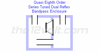

Here are 8th order enclosures.
HR has an 8th order function.
Right that is a classic 8th order made out of Helmholtz resonances ..... .....
We are swapping out the Helmholtz resonances for Quarterwave and cavity resonances... Requires a different model , so with the Paraflex we get creative with TH mode using the "Rear Vented" chamber .....
With the Super Planar 8th we use OD (with "Rear Vented" chamber) or CH mode and stagger the resonances in a strategic way .. .
