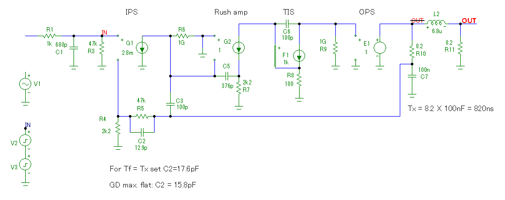

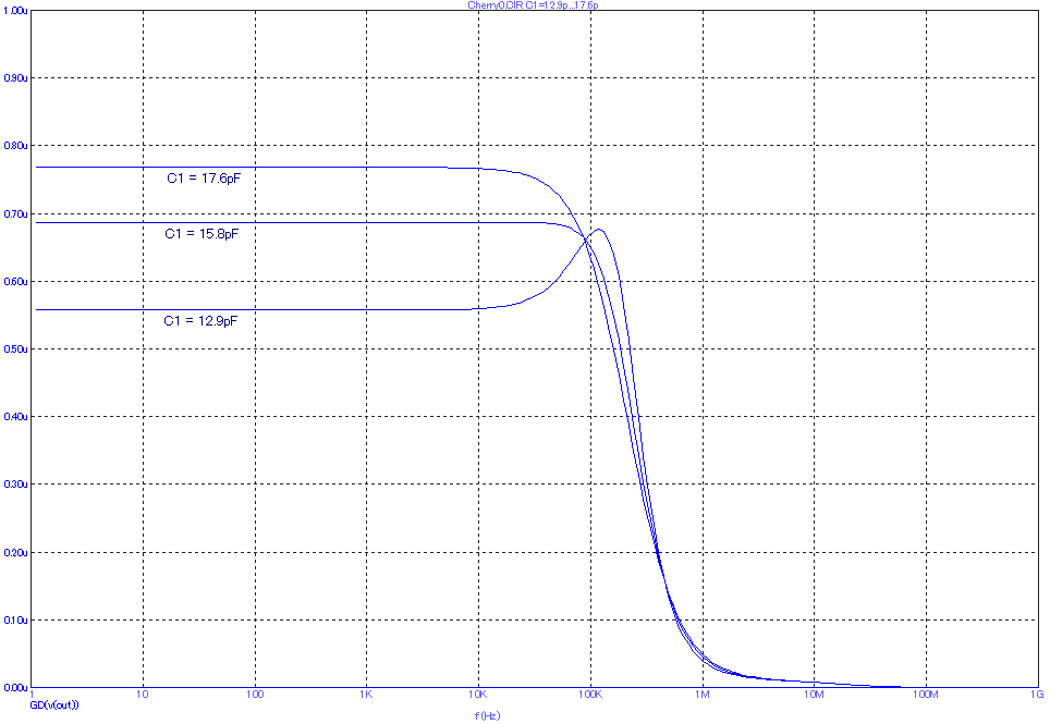

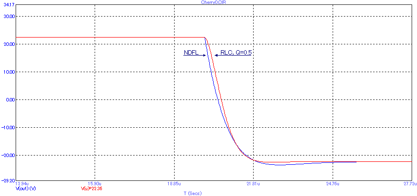

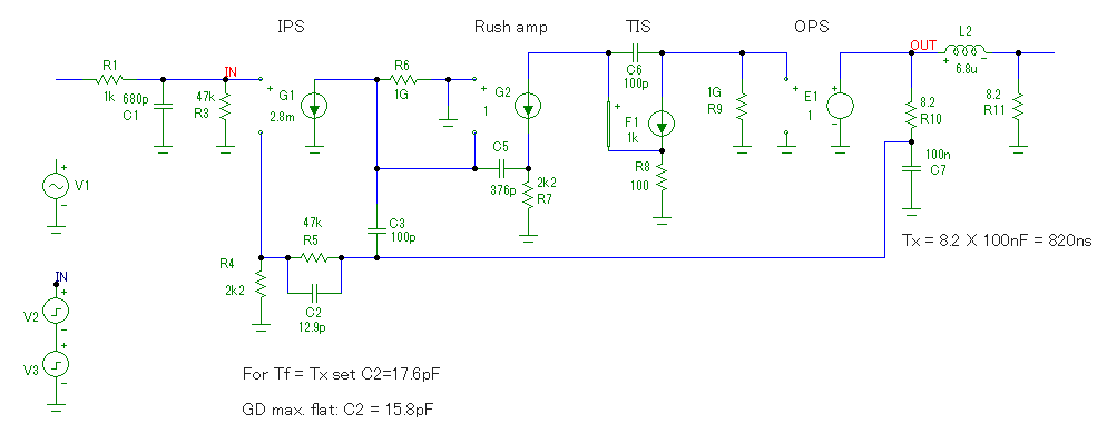

Hi Richard,
Agreed, for a maximally flat group delay Q should be1/rt(3), thus Tf = ( rt(3) -1 ) * Tx or C1 = 12.9pF. With this value I got some overshoot. Okay. That's also what I found in the textbooks. But I'm still not satisfied.
First, the overshoot is much larger (10x) than reported by Cherry (0.5%).
Second, a simulation of the group delay is far from flat (see pic).
For maximum flatness I had to increase C1 to 15.8pF and for critical damping (Q=0.5) to17.6pF.
Because of above discrepancies I'm not sure whether Cherry's NDFL circuit is just a ordinary 2nd order (Bessel) system. Besides, also the onset of the step response looks different (more like a 1st order LPF). Could it be that Cherry's analysis is a little oversimplified? 😕
Cheers, E.
As you've confirmed, the condition for no overshoot is Q=0.5
The Bessel WILL show some overshoot on an unlimited bandwidth input. I'm not sure which Cherry amp you are simulating but they will all have some input filtering which will reduce the overshoot.
Whether you choose
  • Q=0.5 Critical Damping
  • Q=0.5774 Bessel
  • Q=0.7 Butterworth : No peaking. Probably my choice
is just another design decision
But there is another consideration. Once you start nesting loops, the system is no longer 2nd order but only approximates it at LF and becomes seriously wonky at HF.
As I said earlier, for higher order systems, the relationship between the amplitude response measures like Q [*] and time response overshoot become more complicated.
[*]Q is a direct measure of peaking at the 'resonant' frequency of a 2nd order system. eg Q=1/rt(2) gives -3db response, Q=2 gives 6dB peak etc
Hi Richard,
The simulating is based on the circuit from JAES, Vol. 30, No.5, 1982 May, p. 303. The semiconductors however, are replaced by ideal components like a VCCS, CCCS and VCVS, see below. The 2nd picture shows the step response of the NDFL amp (blue curve) as well as of a simple 2nd order critically damped LPF (red curve).
Cheers, E.
errata previous post: That's mostly the case here. should read: That's most likely the case here.

The rt(3) factor comes from a 2nd order Bessel filter eg Table 1 row 4 of RaneNote147 A Bessel Filter Crossover, and Its Relation to Othersl
Postscriptum
Finally, after all those years, this magic factor makes sense to me. All the time I've overlooked that Cherry not only included the R-C Zobel part in his analysis, but also the L-RL part. I should have read his paper more carefully. :headbash:
On the other hand, I still consider it a little weird to include the L-RL part, because RL (the speaker impedance) is an unknown factor. Therefore I prefer to exclude the entire Zobel network from the analysis and treat it as a separate entity.
Anyhow, if we look at the signal after the Zobel network (see pic), and assume that RL is indeed 8.2 Ohms, then we are dealing with a 2nd order system and this magic factor makes sense and C2 should be 12.9pF for a maximally flat GD.
Cheers, E.
Well spotted Edmond.
Cherry isn't the only competent amp designer that has rather naive ideas about the loads speakers present.
