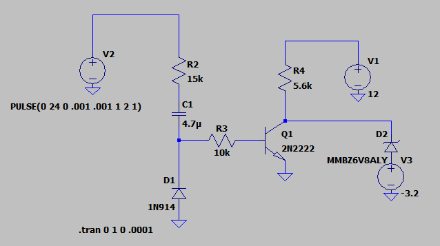

Treat D2/V3 as a 3.6V zener...the lowest zener available was 6.8

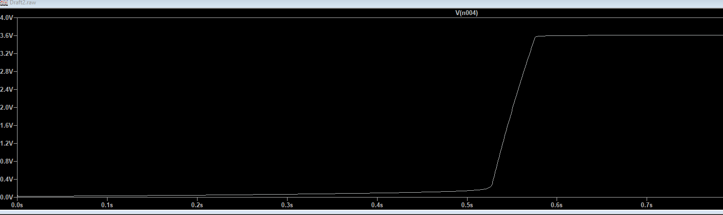

Trace shows Q1 collector voltage
