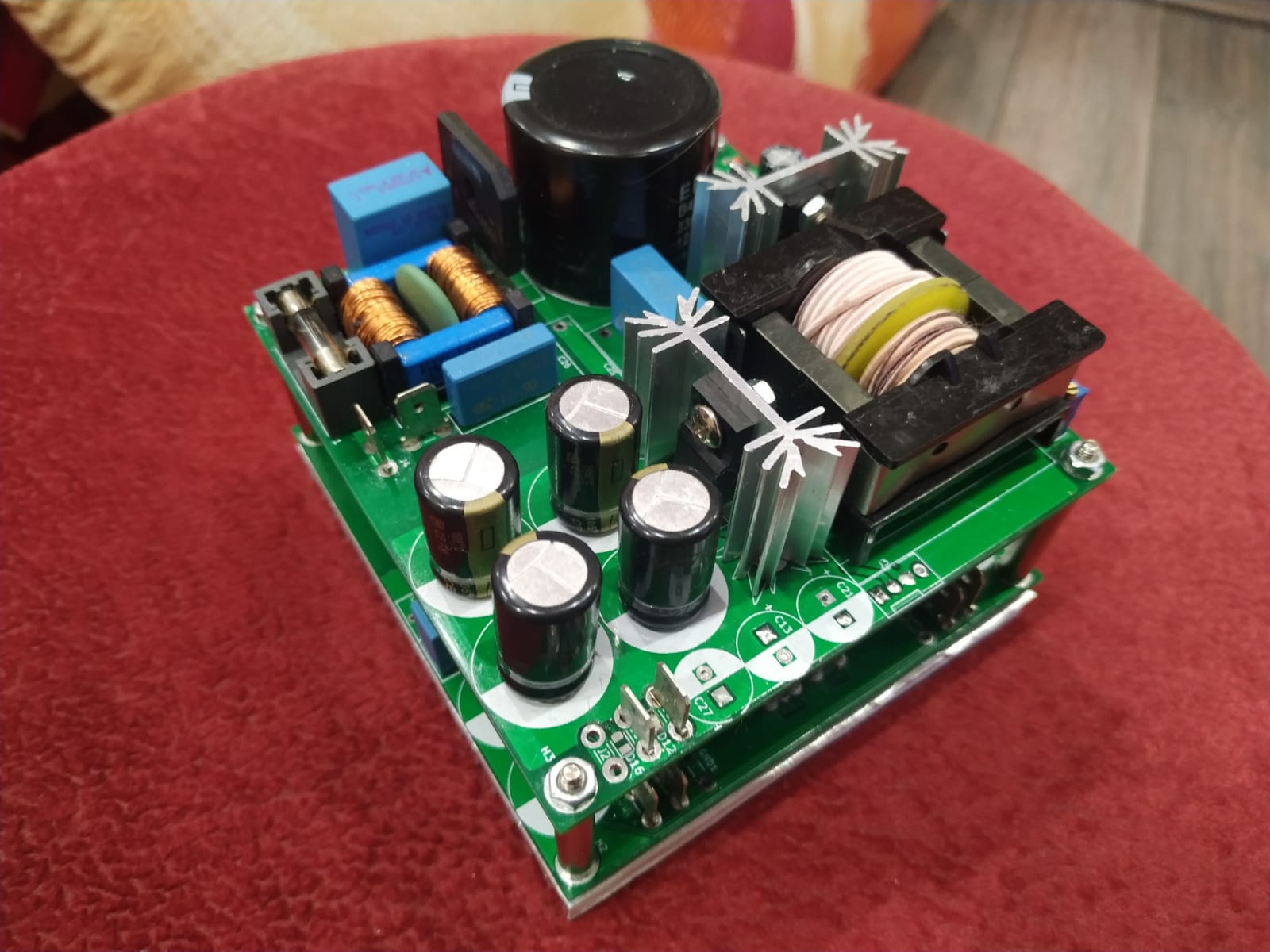

TPA3255.
1x torroidal current transformer isolated Small low impedence graphene doped double insulated laminate 24v secondary.
1x isolated Gan Fet driven high frequency high voltage regulated ac to dc rectified to 48vdc
Graphene super capacitor bank rated for 600W clean DC voltage source.
I like isolated components for electical noise isolation and greater options of use and design.

drMordor: If I wanted to put a 12V fan inside my case with your all-in-one 3255 amp will it be ok just to use the boards +15V & GND secondary out pins and use a LM7812 before the fan? I’d use the minimal recommended setup (0.33uF cap IN to GND and 0.1uF cap OUT to GND). No need for a whole regulated LM317 or LM7812 circuit out from the 15V pins I’m presuming?
Thanks, Pete
