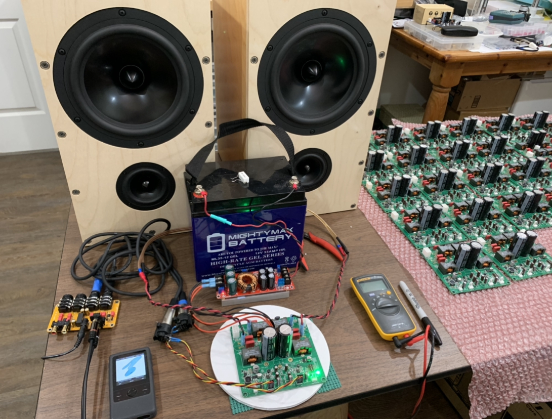

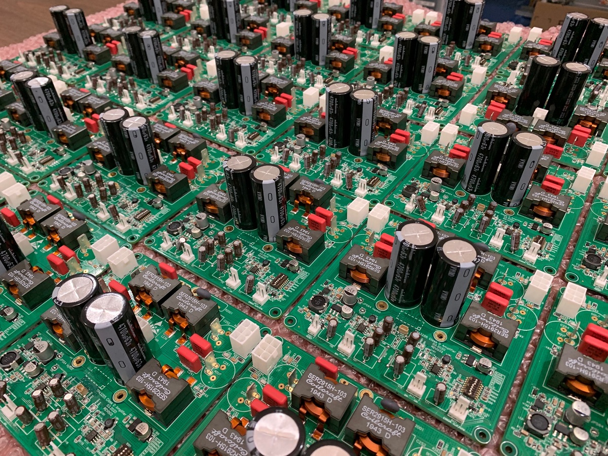

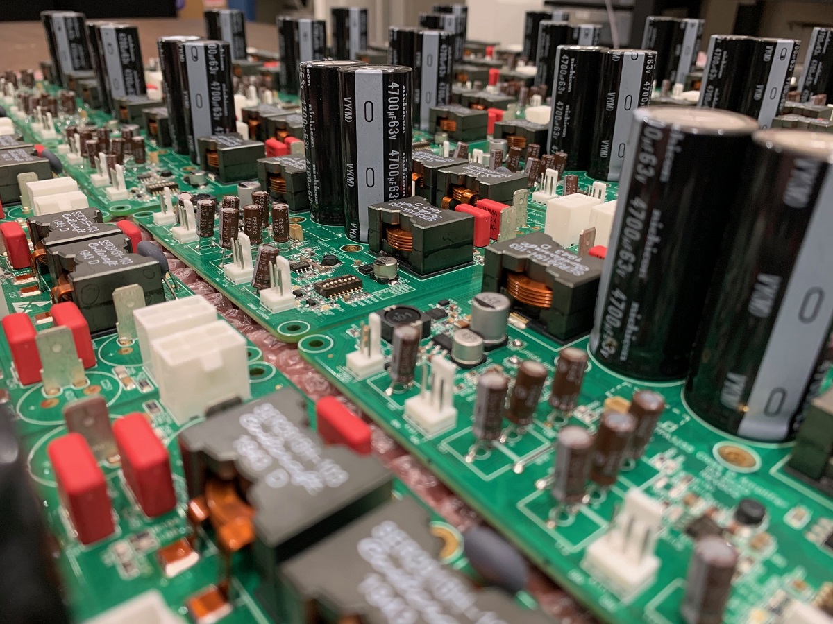

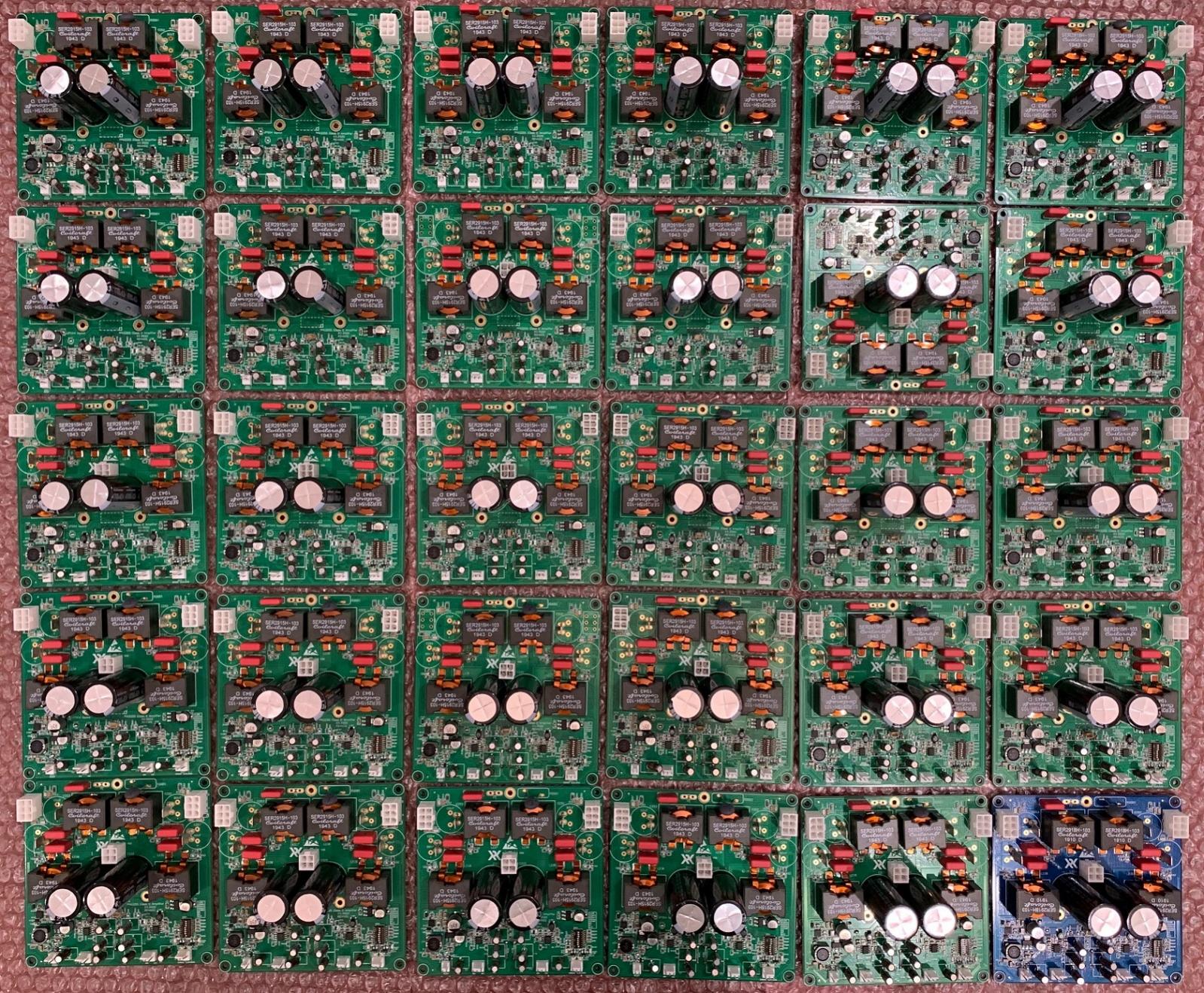

The amps are in! They look great - they all have a "tested" stamp on them, but I will have to check each one for myself to make sure they all work. The one blue one is leftover from the pre-production check build. I am still waiting for the mating PSU and audio input connectors to come in from Mouser. I will include those with the amps so you can start using it right away. Thank you for all your patience on this GB.
X
It looks like a drone shot of a city of amps:
X

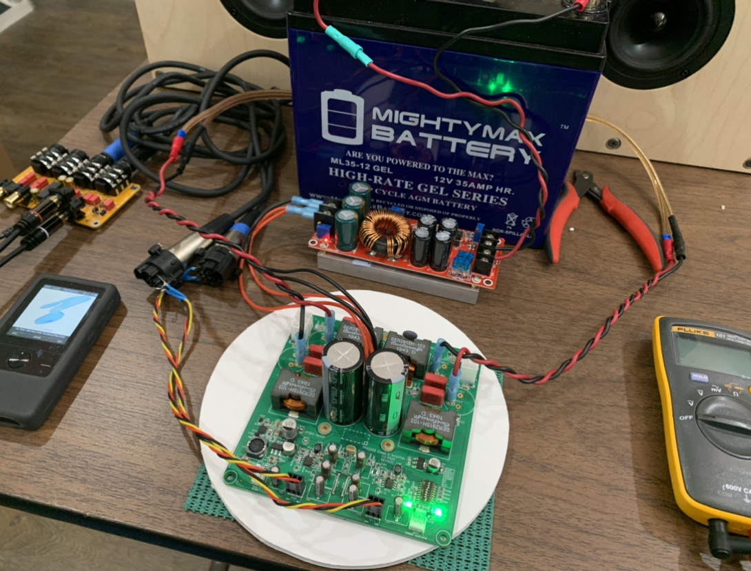

All amps tested and only 1 did not work. I believe it has a damaged 4.7uF cap on the DC-DC buck circuit as no 12v or 3.3v stays lit. No big deal - looks repairable. The order of the connectors for the power, audio in and audio out Molex Minifit also arrived. So I will start shipping out tomorrow!

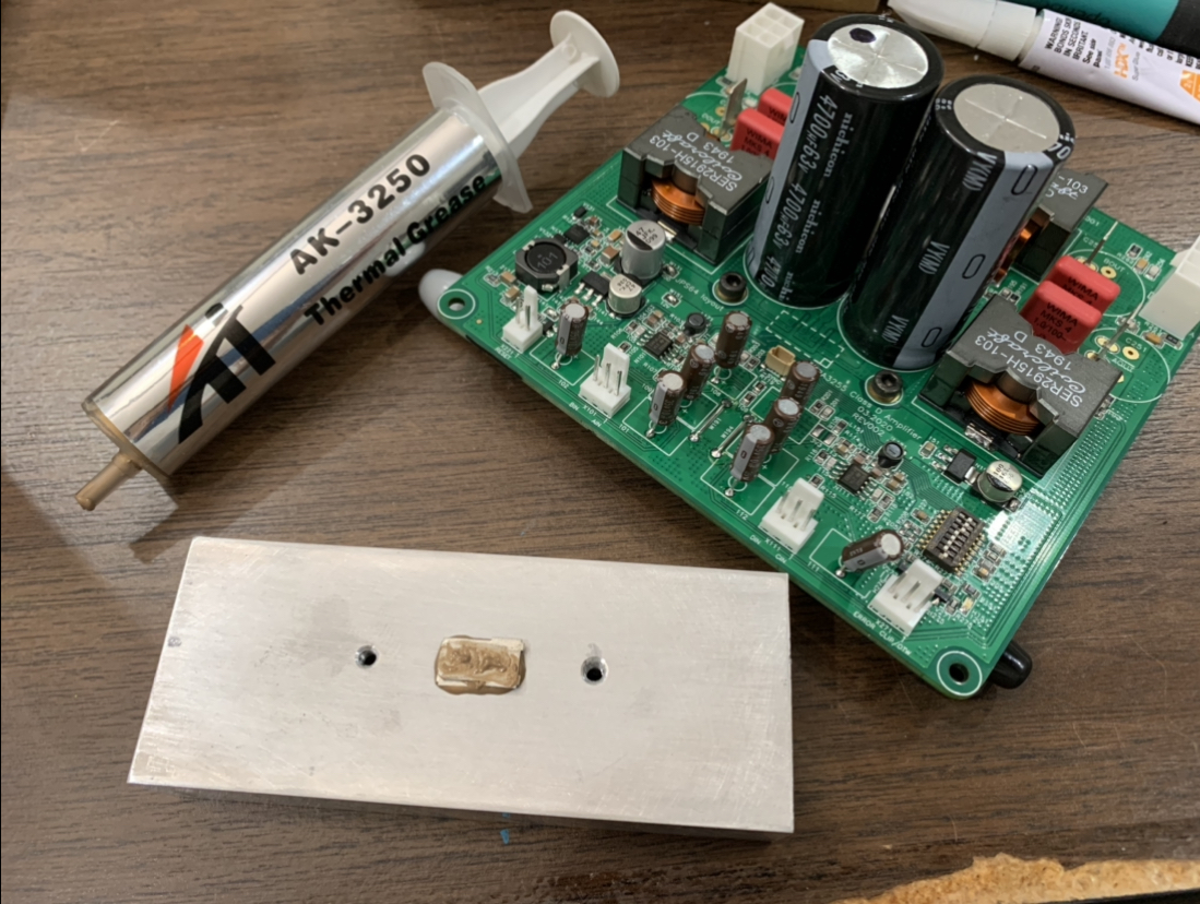

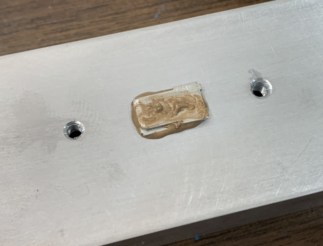

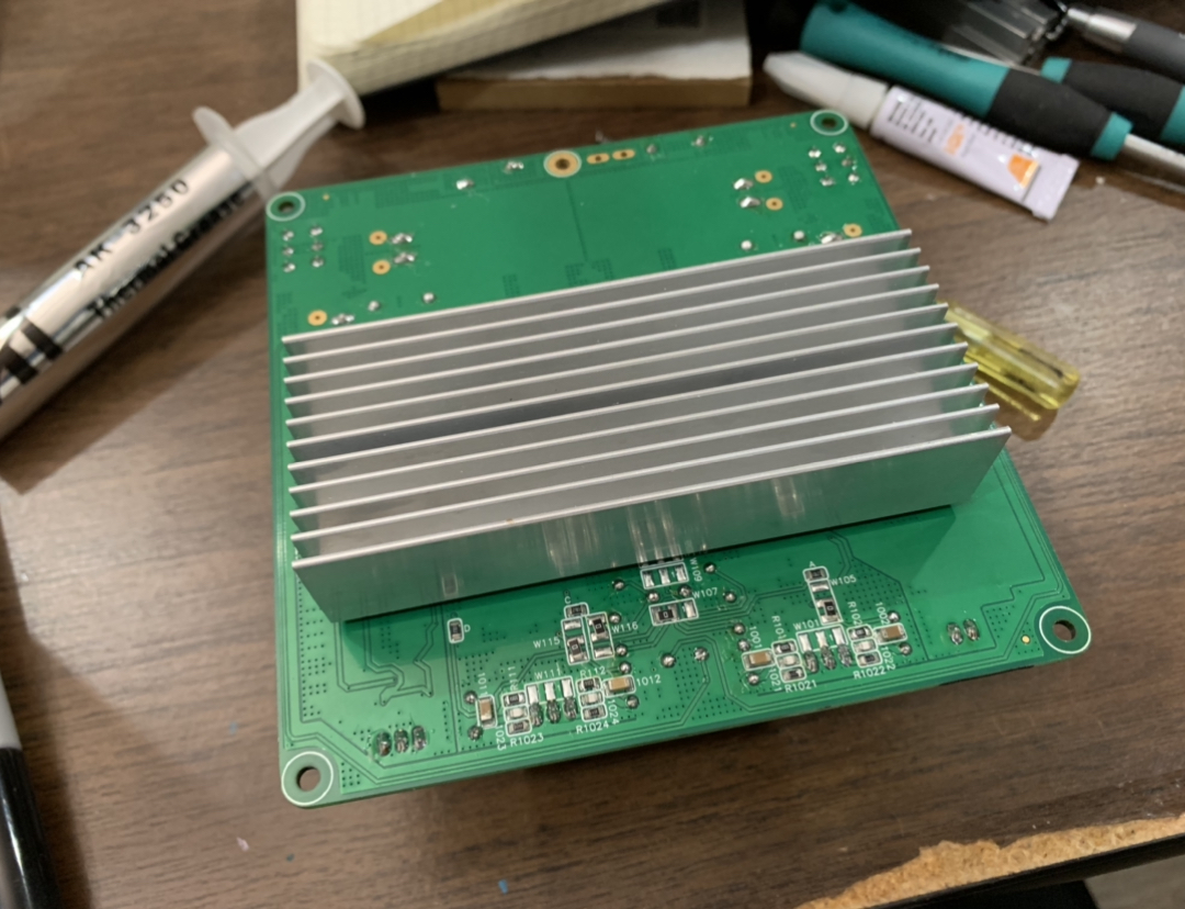

Some detailed photos on how to install a heatsink if you are not going to thermally bond to the chassis floor.
Two M3 holes drilled and tapped 36mm apart, two AMP brand solid copper Faston tabs with thermal paste make a nice 2mm thick thermal spacer to keep the heatsink away from the mounted SMT components. Drill and tap the holes in between the fins for ease of tapping. Be sure not to over tighten mounting M3 bolts and screw them in gently to make sure heatsink is perfectly flat with balanced pressure on each screw. Uneven pressure will not have good heat transfer and may damage the TPA chip with mechanical stress. Also, use preacautions for ESD, like wrist strap.

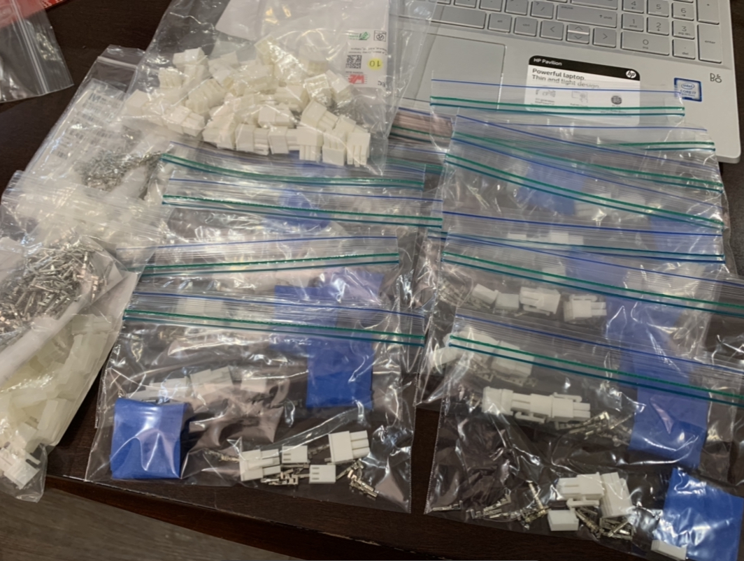

Packaging bags with two 6pin Wurth/Molex quick connects for the speaker outs, Molex 4pin quick connects for PSU in, and two Molex KK 3pins for audio input. Plus all crimp connectors. You would be surprised how long it takes to count all of this out and package it. The cost of the connectors was also surprising - about $3 for some shells and pins. It will save users from having to wait for the connectors to come in from Mouser/Digikey etc before they can use their amp. You do need to get some sort of heatsink though if you want to play it louder than 1W.

Hi X,
So, if we elect to go the heatsink route as illustrated... should we mount the PCB upside down to aid in the effectiveness of the HS - letting the heat rise without cooking the PCB over time? 😕 I most likely will go with bonding the chip to the amp chassis to distribute the heat.
At normal listening levels like sub 25W, that is 5W dissipation output from heatsink and it doesn't reaally cook the board. If you want to run 100w, definitely use a fan, mount to chassis, or even a bigger heatsink and flip up to allow free air flow to cool, as the one shown is good for maybe 7W dissipation.
Note that if thermally bonding the TPA to a chassis, use an insulator like silicone or ceramic thermal pad to prevent chassis ground from touching amp 0v clean ground.

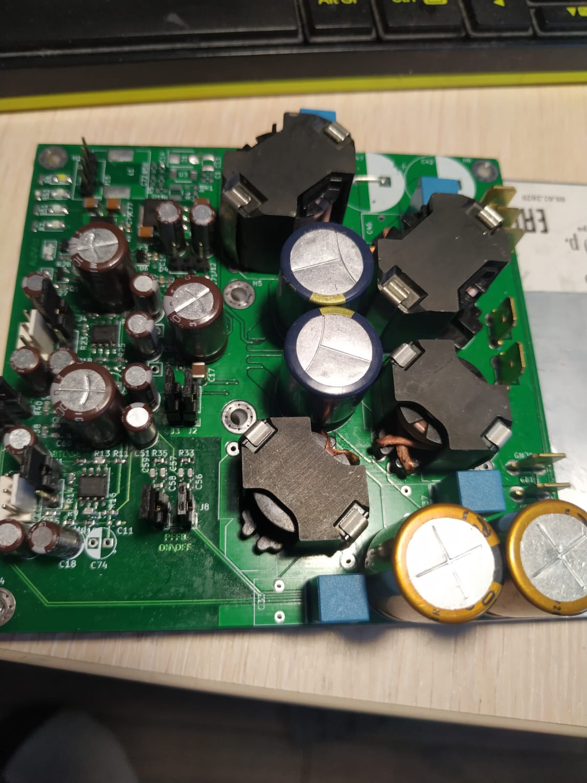

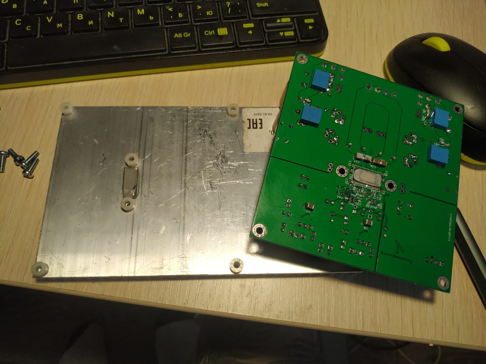

drMordor, Not 100% certain what I'm looking at, but that there looks like a very bad idea.
Hope there's a solid alu or copper block inside that goop pillow you got there, or you're going to have worse thermals than NO heatsink!
Nylon standoffs or bushings of known thickness can work to keep a constant distance, but you will then need some sort of compressible thermal spacer between the TPA and heatsink to allow the best thermal contact. The compliant spacer is then a bottleneck for heat transfer. I find direct mounting of the heat sink without a bushing a simple way to ensure the best and sure thermal contact.
Very much so, "goop" has horrible thermal transfer characteristics, and it's only intended purpose is to fill microscopic gaps to make better use of contact for thermal transfer. The optimal way to use it is by using just the perfect amount to barely but completely cover the contact between chip/transistor/cpu/whatever and heatsink. The ideal goal is to have as fine a surface as possible so there's hardly any cracks to fill, and to use just enough goop but no more than that. If used excessively it is a perfect insulator, so in the extreme you might end up hindering thermal transfer more than perhaps even convection/air cooling with no heatsink at all.
The amps are finally packed. ESD bags, bubble wrap, bag of connectors, box and tape. It’s amazing how much time this always takes. Amps have actually been triple checked - this time on my TL speakers. I want to be absolutely certain that when they are packed, they were working and sounding great. Now, onto making labels. Shipments should go out tomorrow.
