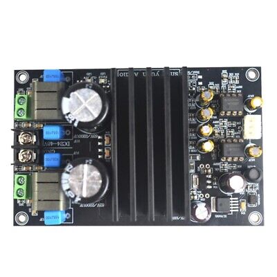

Here's my 2 cents worth. The 3255 chips will take 50vdc just fine. It's the supporting hardware that may or may not like it. Some of the boards use a power management chip (step down buck converter) that will fry if it sees too much DC input. Some of them don't. You gotta be diligent doing research before you pull the trigger on prospects. I did this research before buying anything.
Here's the board I'm using in the frankenspeaker. Shui yuan middle model. It handles 48v just fine. They have a cheap one, same board but populated with generic parts. Top model is a different board, mainly because it has a larger heat sink and more power supply capacitors.

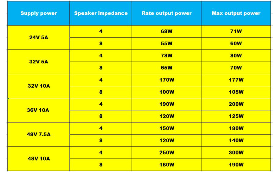

Hi all, I have the AIYIMA A07 TPA3255 Power Amplifier and I'm looking to this 48V 10A PSU:
https://www.amazon.it/NICOLIE-Switching-Transformer-Adjustable-Digital/dp/B07RZ5Y54Z
Anyone used it before? Any feedback?

I would avoid it.
- direct import from China, it does bear the CE logo but safety signs are in chinese and primary voltage is listed as 220V so it is not meant for export. RF filtering may be less effective.
- input is not universal, it requires a manual 110/220 switch. It may be indicative of old design with low efficiency: the fan will spin faster and be noisy.
- no temperature derating graph is provided. You can assume that 480W is specified at 25C with infinite heatsink: available power on real application is realistically 50-60% of the rated value
I agree that this will be a better choice: https://www.mouser.it/datasheet/2/260/MWEC_S_A0012912881_1-2552120.pdf
That said, I will never need continuously that current (look at the table below), just on very few peaks:
Would you consider it not proper for the application?
Do you have the same amp? What do you use?
