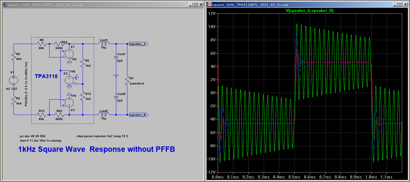

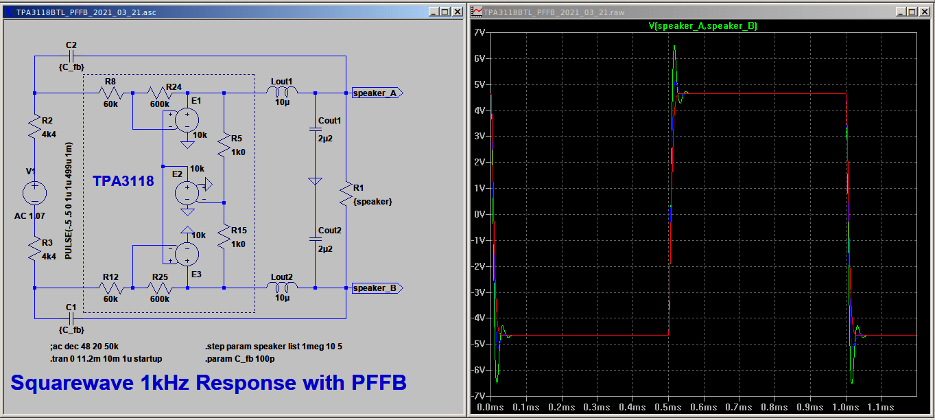

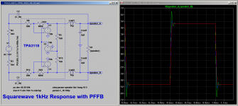

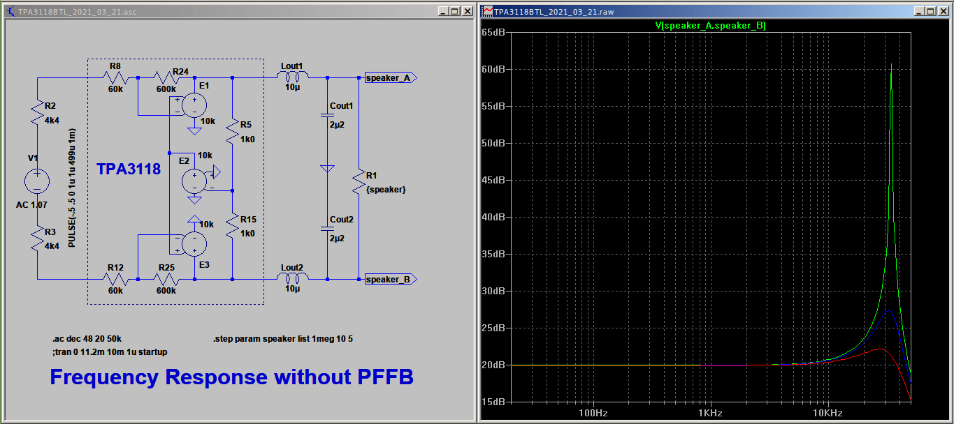

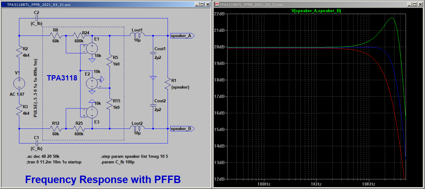

In the meantime I checked my repos and found some LTSpice simulations depicting the effect of differentialting postfilter feedback. Originally intended for TPA3118 these are generic and apply to TPA3255 as well as to many other class-D chips.
