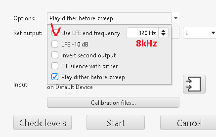

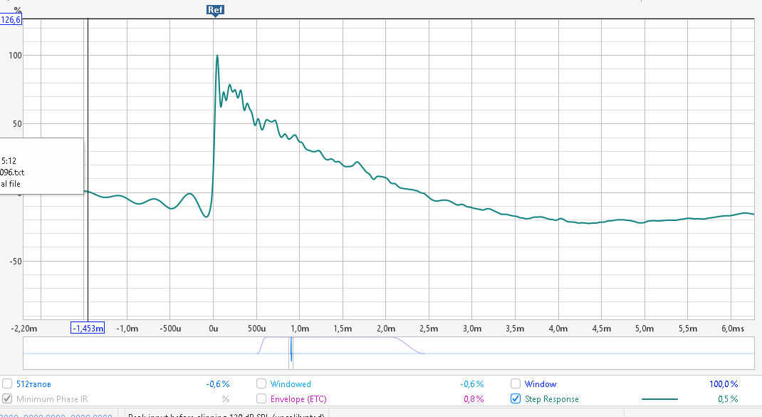

I have a different approach to mixing speakers, so I can't give a precise answer to your questions. I don't use CAD to calculate the resulting crossover frequency response. I think my speaker mixing technique in this thread will be a flood. I'll just say that I use phase-linear digital band-splitting, which allows me to align the acoustic centers of the emitters based on the step response that I get by measuring all three speakers simultaneously.In case of crossover design, where you need to get FR curves for each speaker individually, how do you do?
I think if we specify a frequency of 8 kHz in this window, we will get measurements of each band with a reference time relative to the tweeter. But I'm not sure, I've never done this because I don't need it.Example, suposing around 1m distance mic from speaker
Woofer: 1,00m
Mid: 1,06m
Tweeter: 1,08
