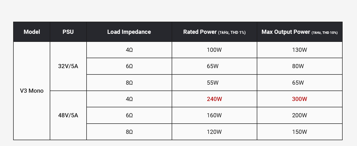

I don't understand this table Fosi Audio V3 mono:
Why can it output so much more with higher voltage?
PSU 32x5=160W and 48x5=240W, so factor 1.5
But at 4Ohm (rated), factor 2.4
I'm using two 36V/6A PS, I thought that might make it heat up less (less stress). Am I wrong?

Sorry, I'll write it another way... Why does 1.5x the PS voltage (32/48V) allow up to 2.4x the output (100/240W). Does the TPA3255 have a favorite voltage... "nonlinear ratio in to max out"?
Of course I expect the amp to offer let's say 50W@4Ohm regardless of the PS used. But will it get less hot doing so with a lower voltage PS? Like underclocking a cpu?

1.5X the PS voltage in theory gives 1.5X1.5 = 2.25X the power because for a fixed impedance the power is proportional to the square of the voltage. So yes the relationship volts-to-power is non-linear.

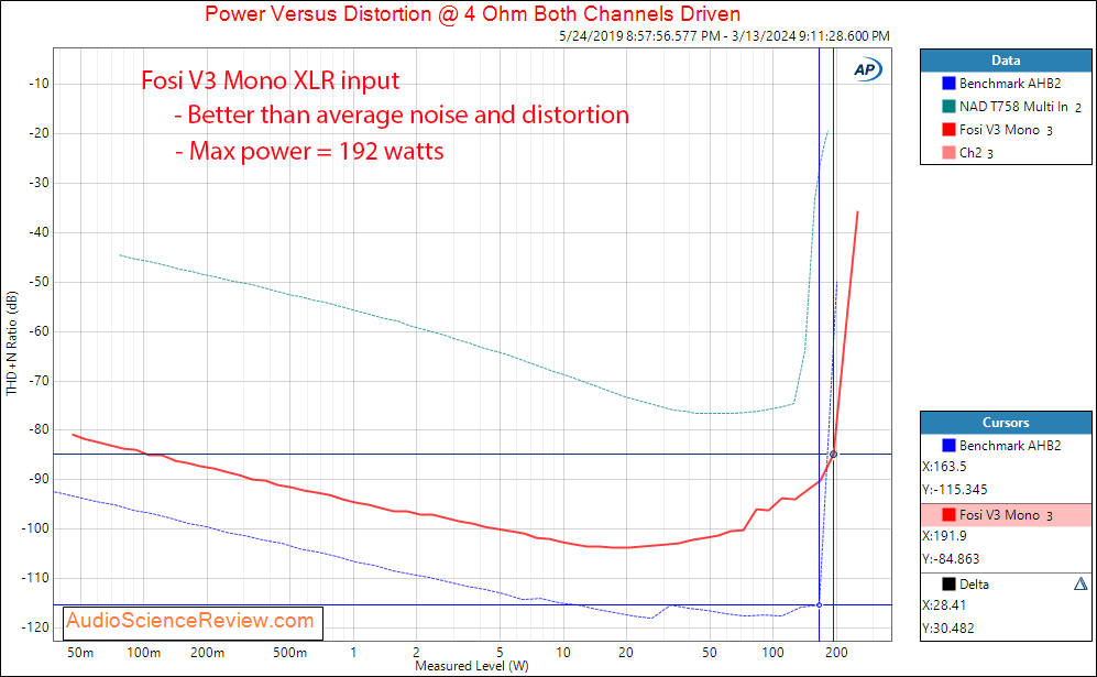

The tpa3255 chip has the lowest distortion at 34 V .
This is the real power output from Fosi v3 mono using a 48V 5A for each amplifier:
This is a bit less than the stated 240W.
Using two 36V 6A supply’s, there will be only a small difference using 4 ohm speakers and the reliability will be better .
