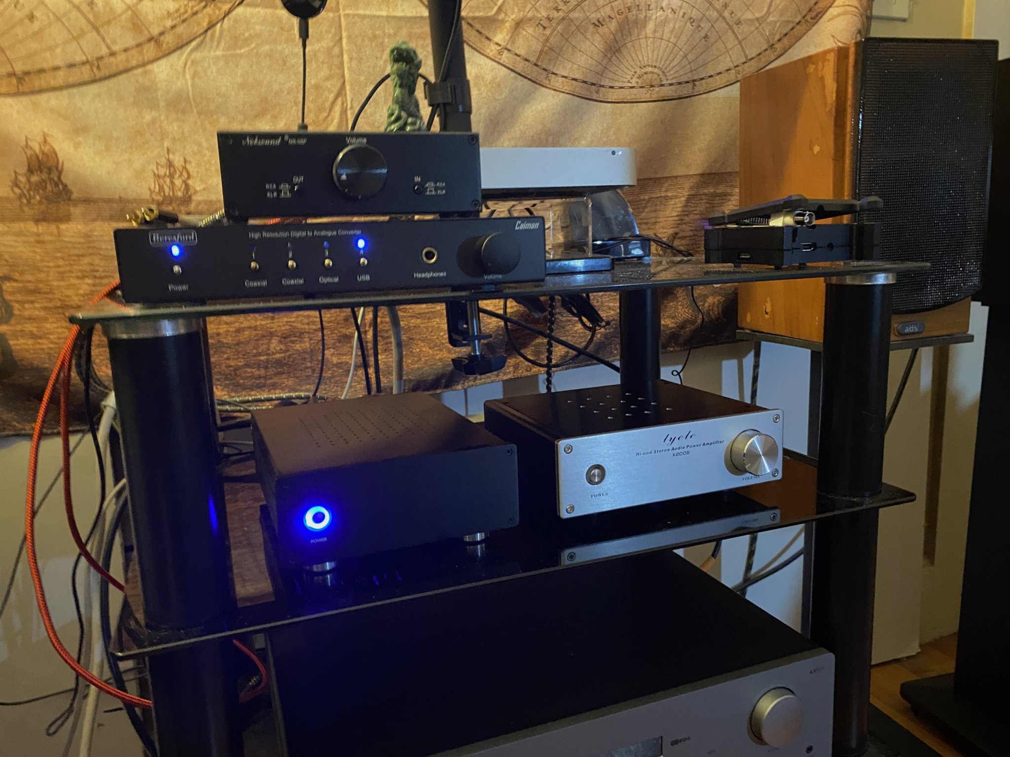

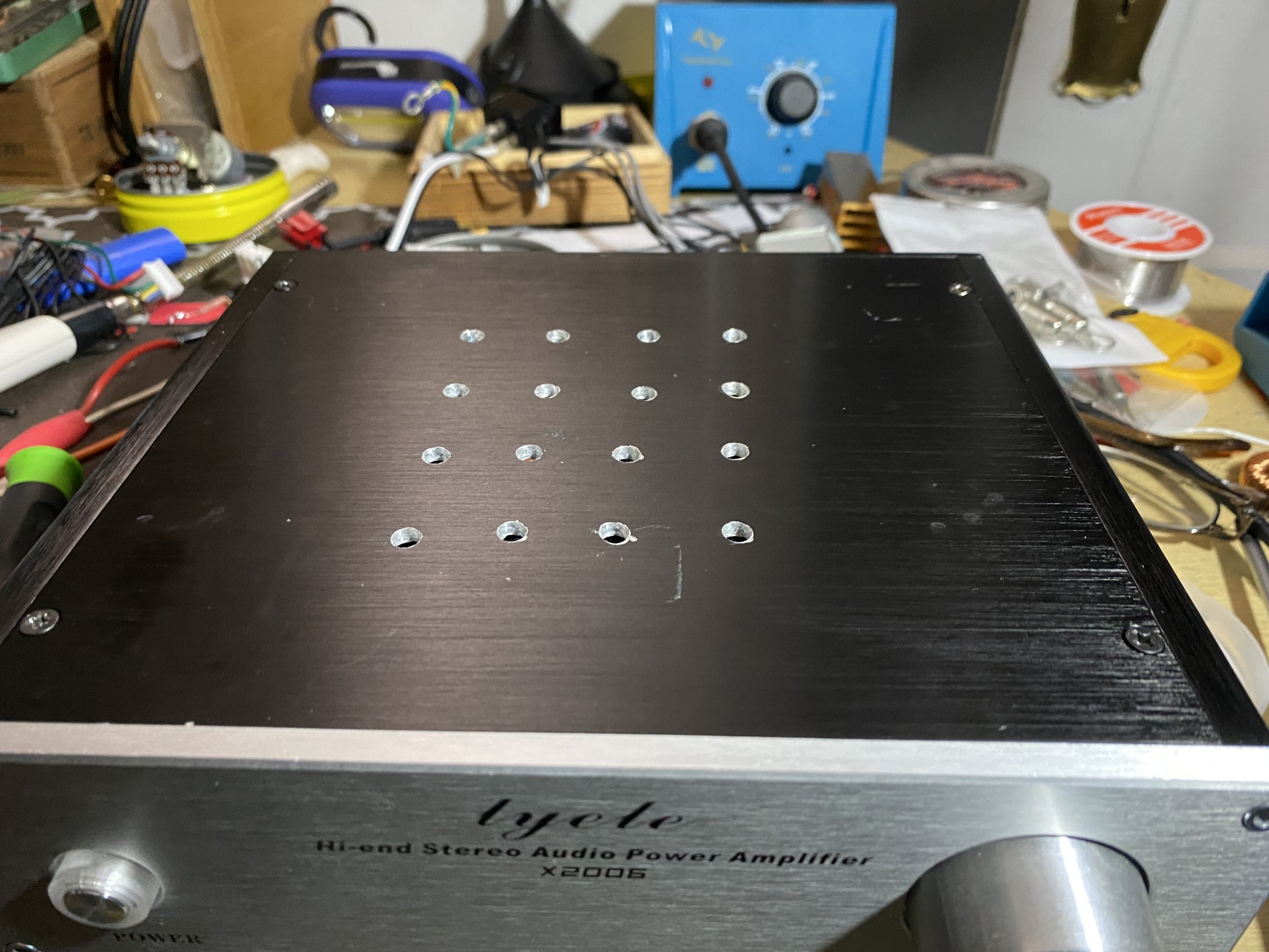

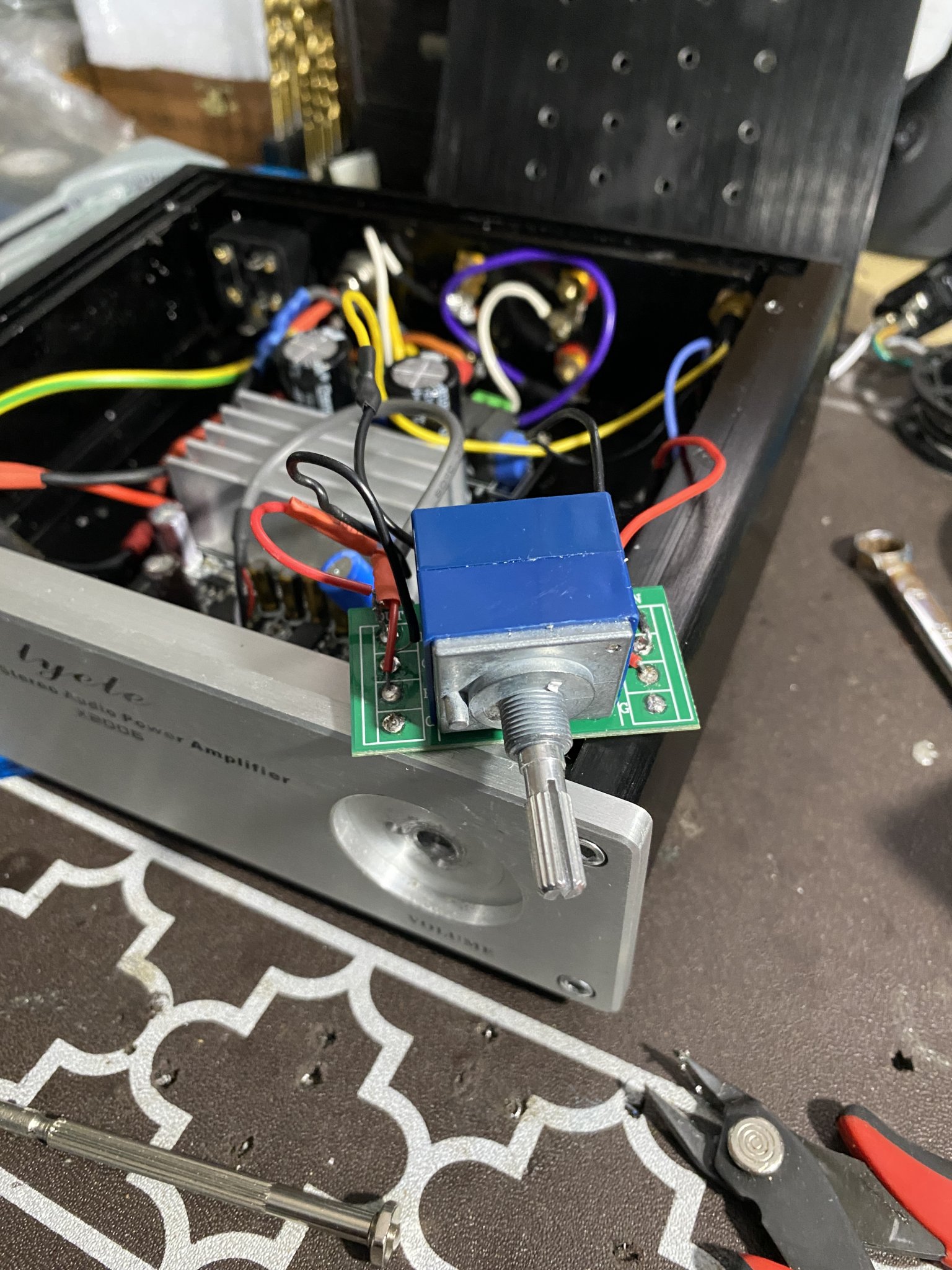

Be easy on me Im relatively new to this DIY amp but do have experince with electronics and refurbing/fixing vintage amps etc as well as career in Electro Mechanical field. So I Finished this build using a 30 dollar ebay TPA3255 and it sounds excellent, just added an Alps 27 Potentiometer, for a power supply i have an external 48v 7amp used in Networking and telecommunications, its a low ripple low noise supply by ICT comm series. I have a dc jack mounted to back of case wich then runs to switch up front. I added a 4uf cap across the reset Mute which stopped the pop sound turning on and off per posts I saw here suggesting it.I have that seperate as It wouldnt fit in this case easily and this case has been chewed up inside over the last few projects. Ive since aquired better tools to do this stuff the right way going forward like better drill and bits as well as Dremel and few other doo dabs to aid in fabrication. The Alps pot shaft was quitelong so trimmed that down to fit the vol knob on (Yes I deburred and filed it beofre installing case. All and All Im quite pleased with this and am loving the latest Class D offerings, however Im wondering if Id actually see a sound improvement with one of these more expensive TPA BOARDS like the 3e and few others to justify the price? I also built a icepower amp using the 50asx and am waiting on wiring harness and am bulding one using the 125asx2 board so Ive been a class D busy boy lately. Pics of my system for attention. Any feedback always appreciated. TY guys Ive learned a lot lurking here.
