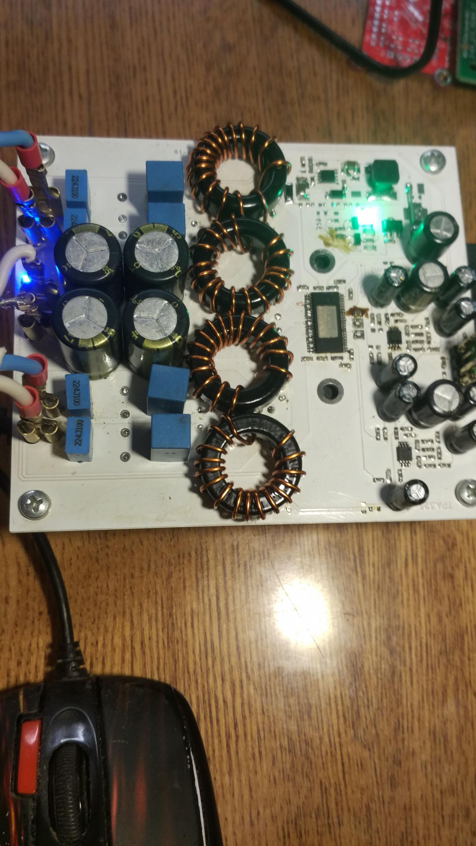

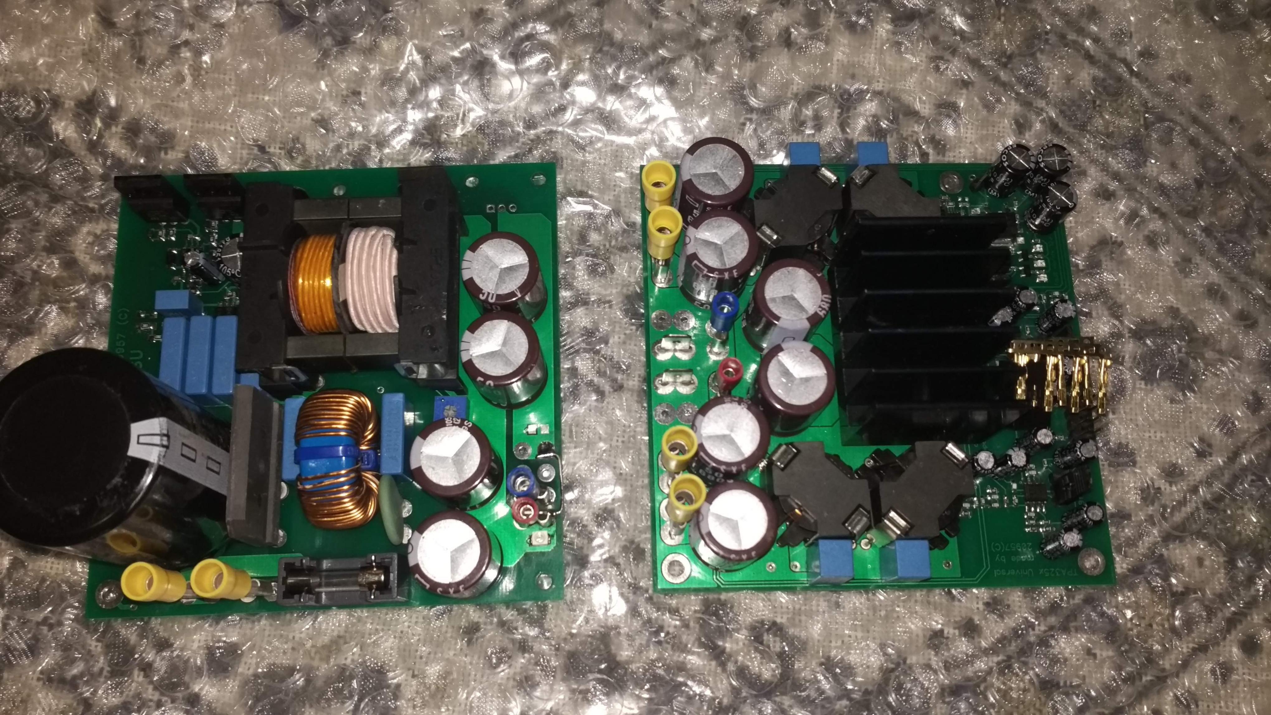

Hi, I developed 2 version amp TPA325x
Now build new version, are there any questions?
Gerbers after testing will be available to all.
Conditions:
1) Output inductors based on RM8 Epcos
2) 1st stabiliяer - LM5007 or use 12v output from PSU
Your wishes?
Sorry for my bad English))))

doctormord, FYI, not shielded LLC inductor or combo-trafo makes near impossible EMC compliance, and hence legal distribution. Picture irs20957 shows unshielded trafo and one winding of the common mode choke was placed exactly against of trafos gap, I'm ready to bet that conducted emissions test will be even better without that common mode choke.
