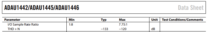

It's the ADAU1701 that loosing the SINAD in 3e audios amp.
28-/56-bit, 50 MIPS digital audio processor
2 ADCs: SNR of 100 dB, THD + N of −83 dB
4 DACs: SNR of 104 dB, THD + N of −90 dB
With nanoDIGI that I run it's at least over 90 dB low counting with ADAU1466 digital all the way from computer.

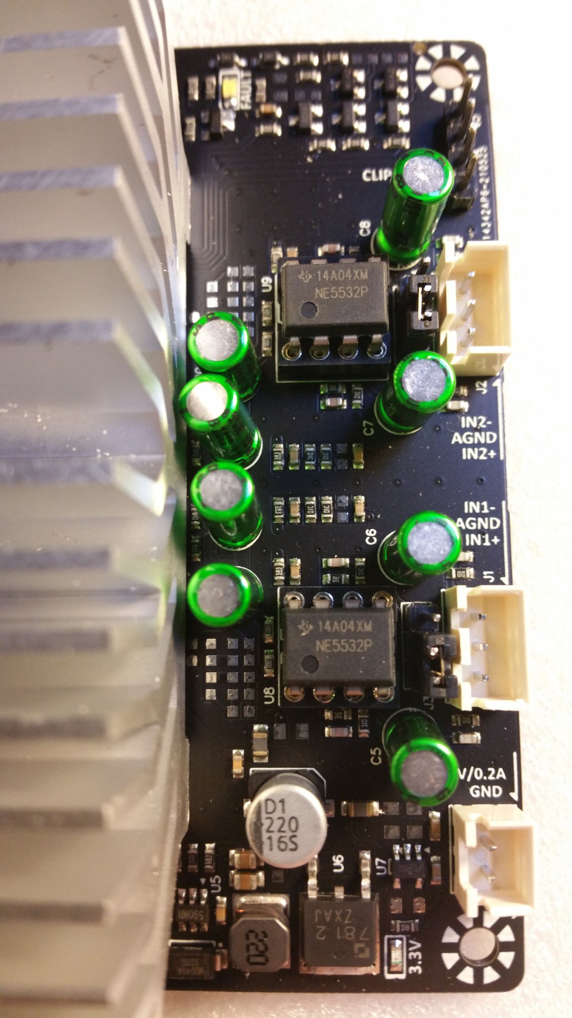

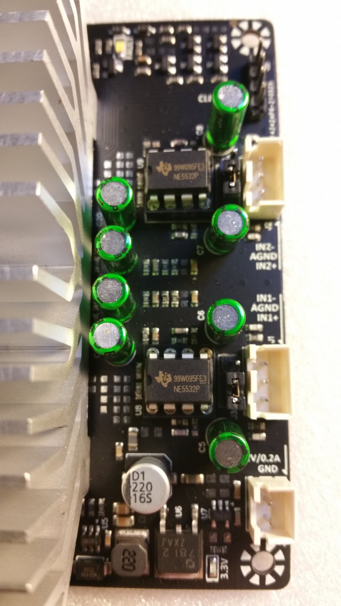

Hello everyone, hope you are doing well.
Preparing for the rest of my DIY adventures, I noticed a clear cosmetic difference on the NE5532P used on my TPA3255 3eAudio modules which were received at the same time.
Out of 3 modules, 2 are identical (see photo below), one of which was already used in a previous realization (here).
But on the 3rd module the Op-Amps are aesthetically different :
Would that imply that these are counterfeit? or is this a legitimate variation?
In either case, I would like to test Op-Amps other than the NE5532P. But I understood by reading a dedicated topic that the electrical/electronic implementation was dedicated to it and that compatibility with another Op-Amp was not guaranteed (can degrade the quality, induce distortions, etc.)
So, based on the previous pictures can we deduce a compatibility with for example an LM4562NA/NOPB?
Also, in order to determine the choice of Op-Amp, are there any usage limits depending on the voltage of the power supply chosen (36-38 V in my case but maybe 48V later) or then does the module limit the voltage automatically for the OP-Amp part?

NE5532 is a good opamp.
Of course, most certainly, I don't think otherwise and I am very happy with the amp already made. But that is not the question. I would first like to know if these are not fakes / clones and if I could possibly "have fun" replacing them with other things, just to see if I hear a difference or not, but trying to avoid doing anything stupid.
Oczywiście na pewno nie uważam inaczej i jestem bardzo zadowolony z już wykonanego wzmacniacza. Ale to nie jest pytanie. Chciałbym najpierw wiedzieć, czy to nie są podróbki / klony i czy mógłbym "bawić się" zastępując je innymi rzeczami, tylko po to, żeby zobaczyć, czy słyszę różnicę, czy nie, ale starając się uniknąć zrobienia czegoś głupiego.
You can always have fun 🙂 I don't think it has any effect on the sound. Your NEs look original,
Okay, thanks bendix.
If someone else can possibly confirm the authenticity of the NE5532Ps and direct me towards an Op-Amp which would be a priori compatible with the electronic configuration of the module. I see a lot of people just replacing the op-amp with another model regardless of what's going on around it, although in the end you don't really know which way to turn.
Thanks Chris, I had read something similar before and had no particular illusions about changing the Op-Amps. It's just that, not knowing much about electronics, when I realized that there were aesthetic differences at the level of the NE5532p of my modules (although received at the same time), I had a doubts about their authenticity. I imagine it is likely, during the time these chips have been around, that they have had to change the "encapsulation" several times for one reason or another. In short : there is no drama here !
