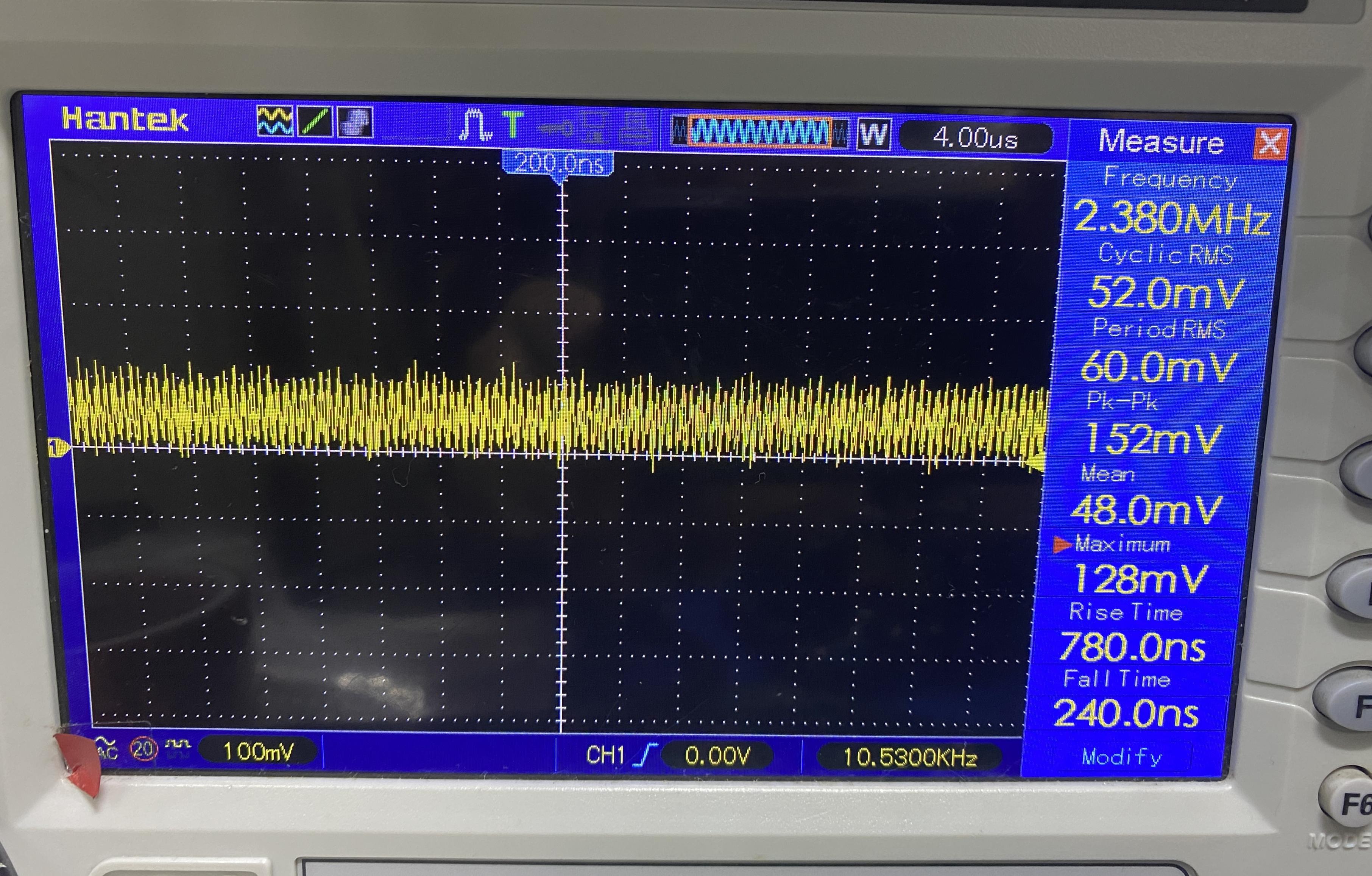

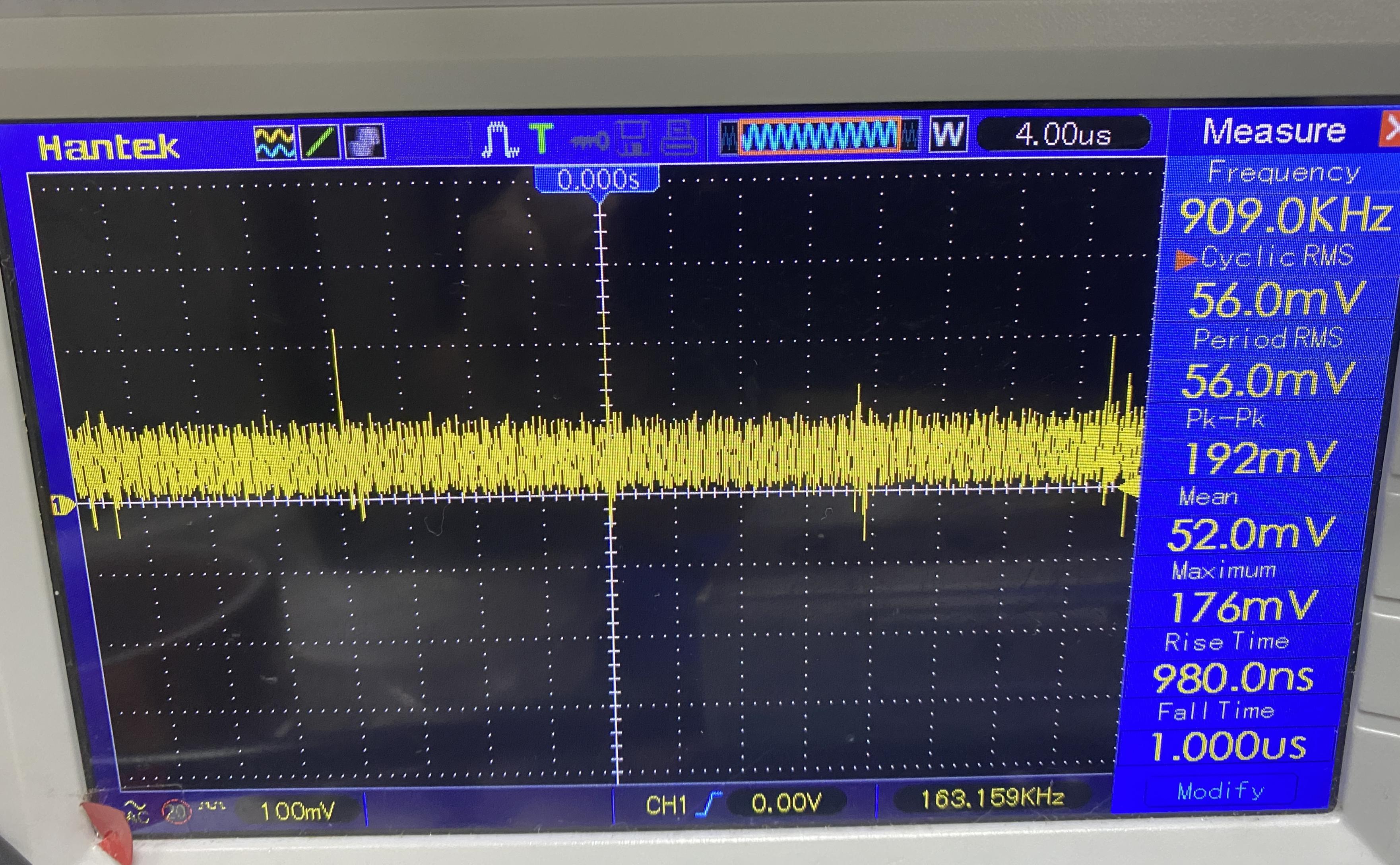

Here's the scope comparison of Meanwell LRS-350-36 vs SMPS300RS (I also own both).
They have the same ripple, except that the meanwell has a higher switching noise (65kHz) (192mV-pp).
Noise of Connex is only slightly higher than its ripple.
Meanwell also produces clean noisefloor on my TPA3255 THD measurements. Unlike my generic adjustable SMPS which has some spurious noise in 22kHz.
