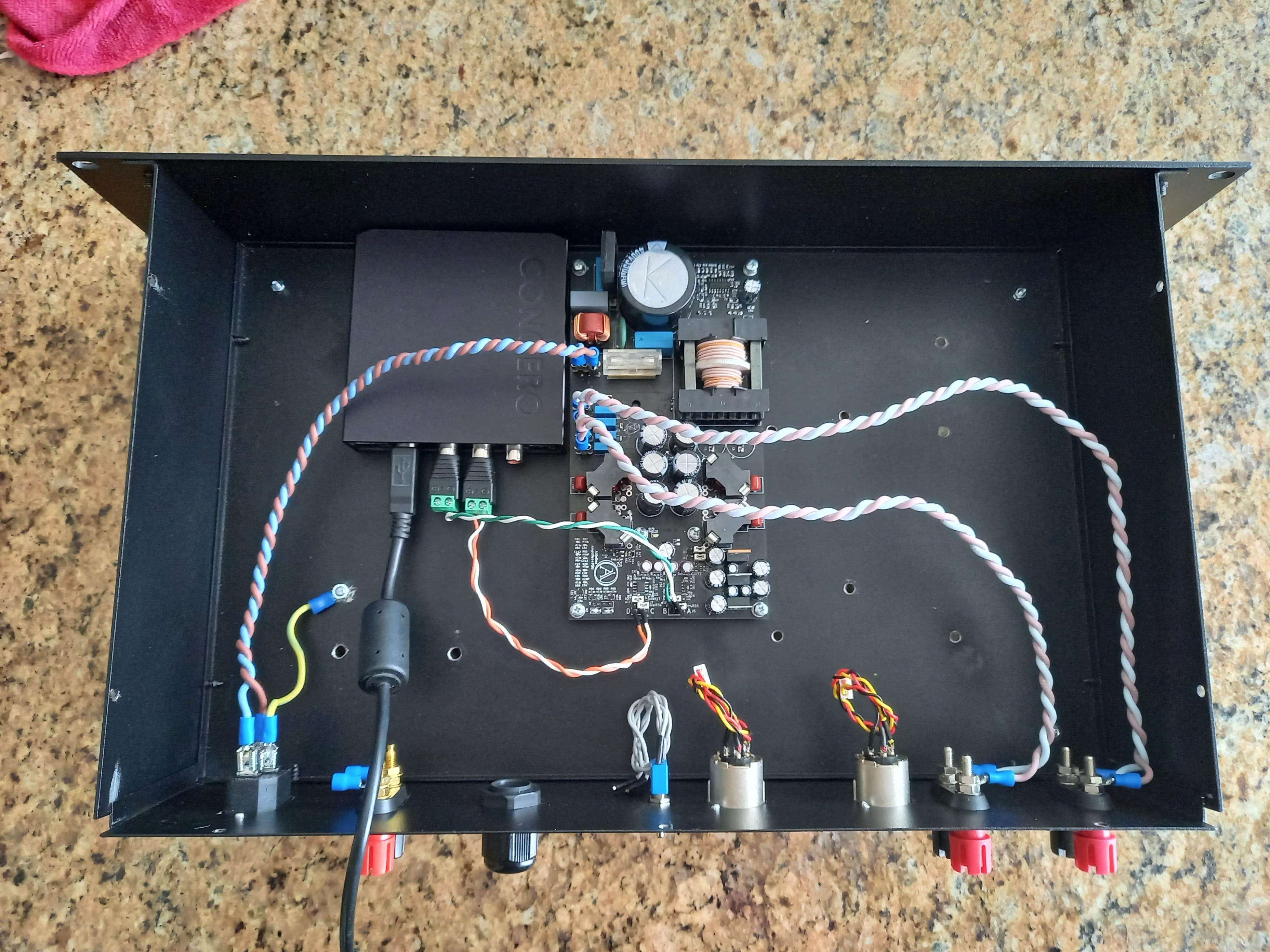

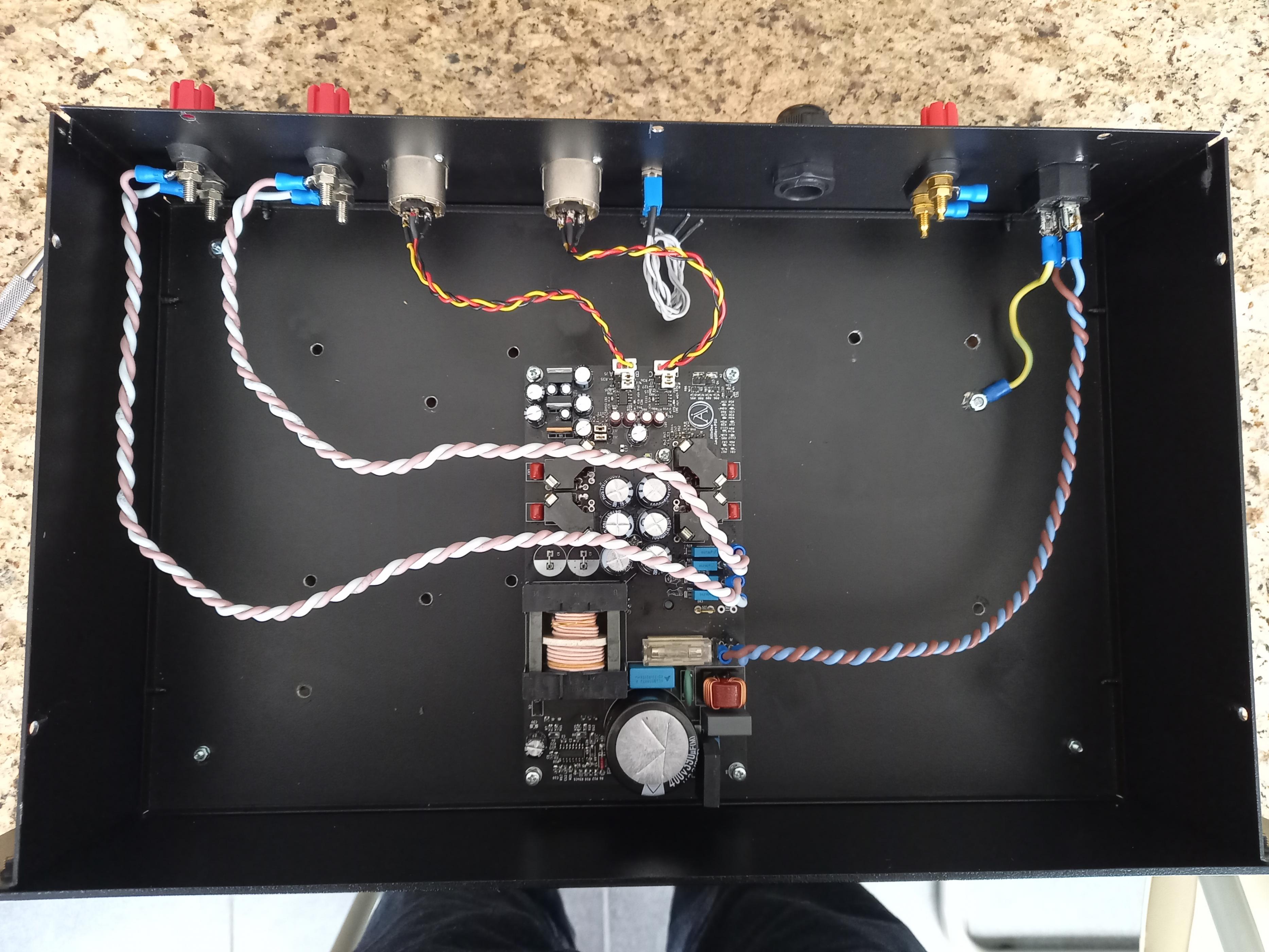

Yo amigo,
New TPA3255 by DrMordor
- Heavy duty alu case
- Alps pot.
- PET cables
- TPA3255 PFFB +
- TDK / Epcos Inductors
- OP Amps MC 33272
- Elna Silmic II Buffer caps
- Epcos main caps
- LLC SMPS PSU
Sounds just amazing ohhhh my god !

No)))Is this the very latest?
I did, my load is weak, but I got less than 0.003, 20 watts 20Hz-20kHz
WOW.. Dani! Nice!
So Many amps you are assembling recently!
Too much lol
I think I have tested most of best Class D amps )
WOW.. Dani! Nice!
Hypex Nc400 or Purify?
