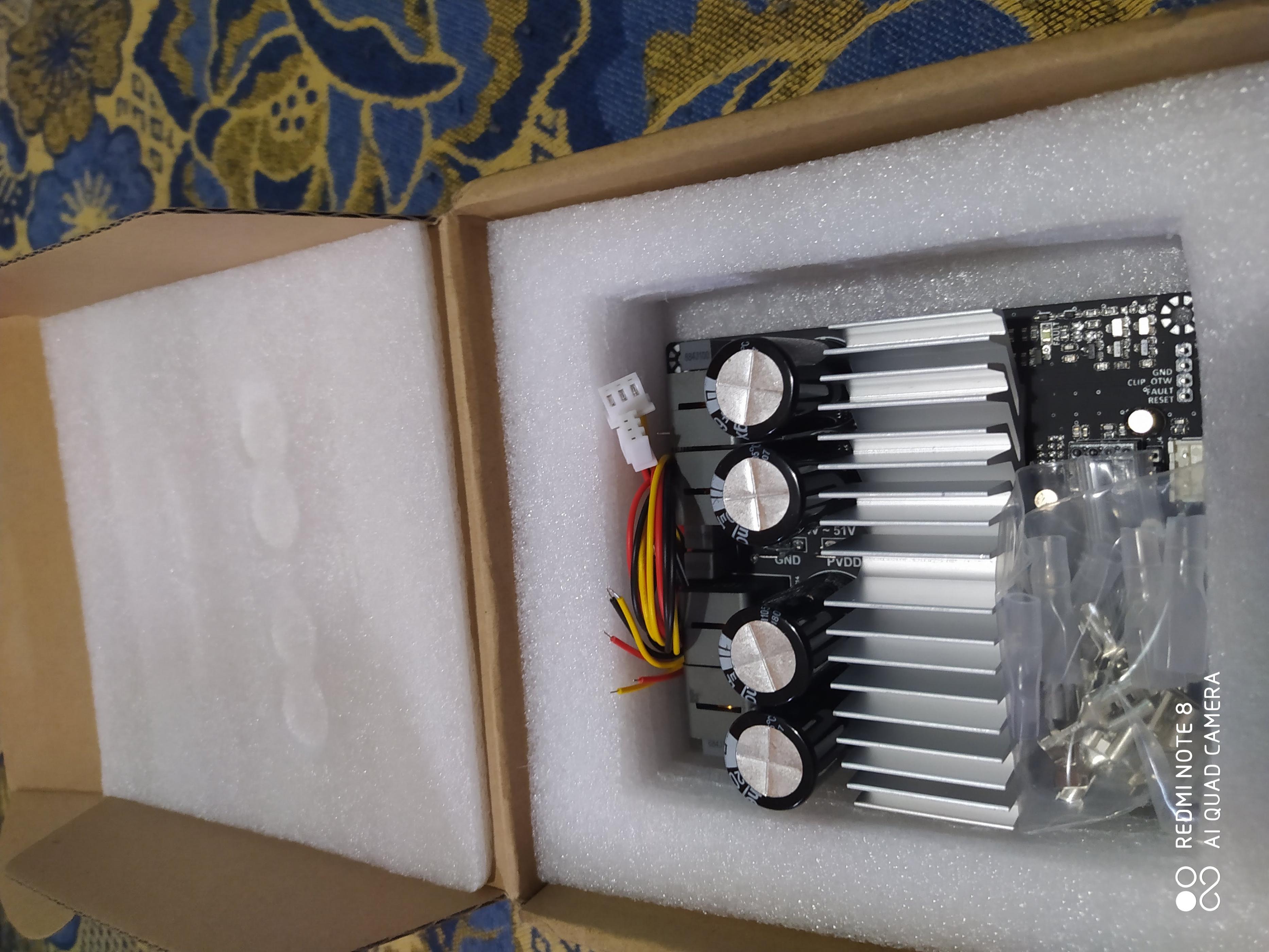

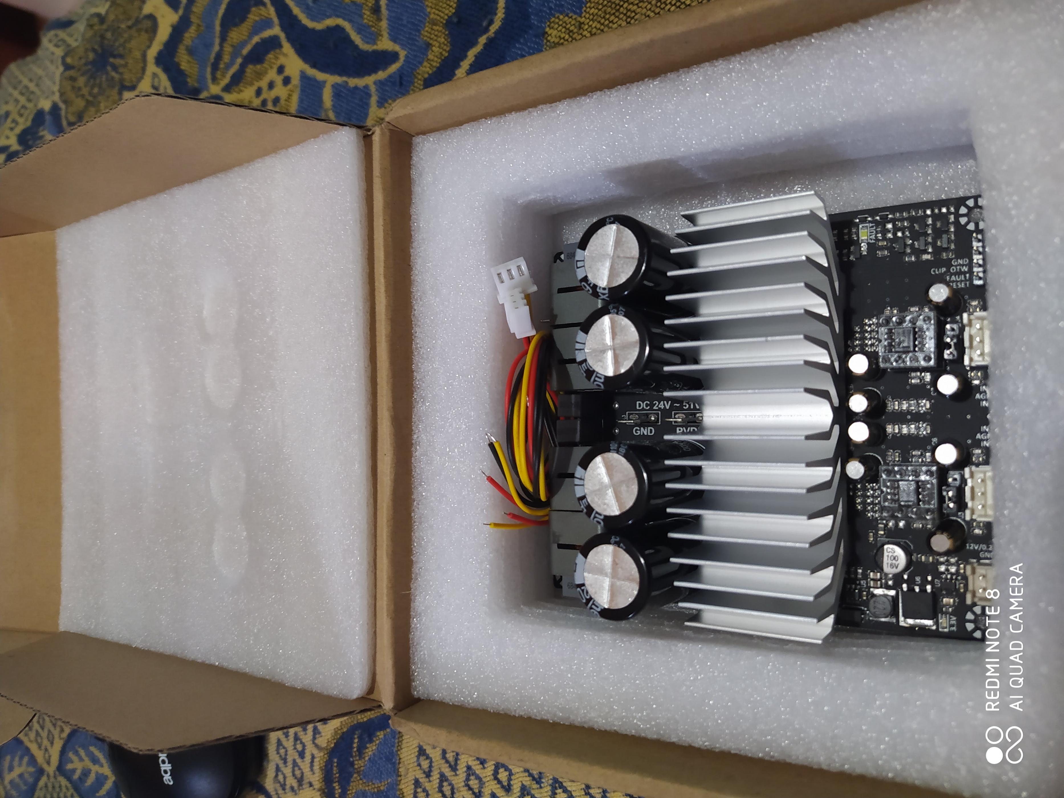

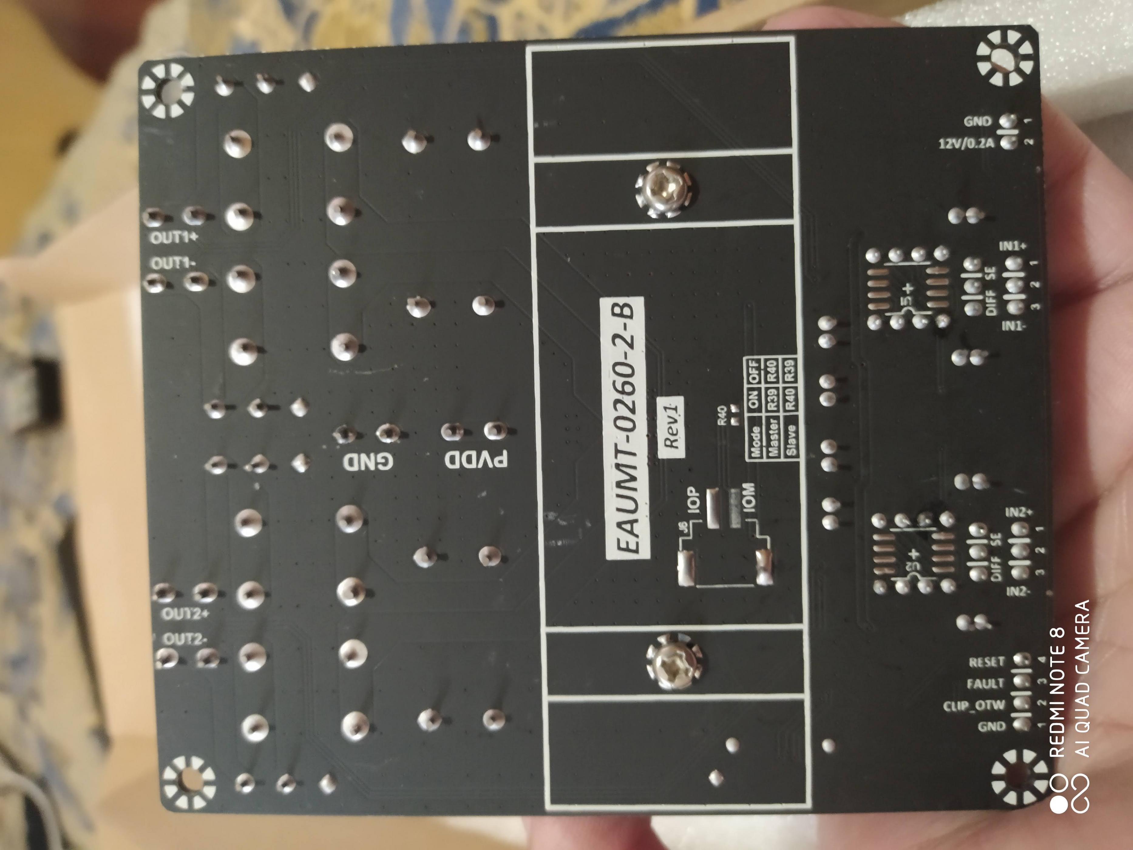

I have good news!
My 3e Audio EAUMT -0260-2-B has arrived!
I am very much looking forward to testing it, listening to it, comparing it with my reference AB amplifier and my other Class D amplifiers.
Greetings
Greetings
