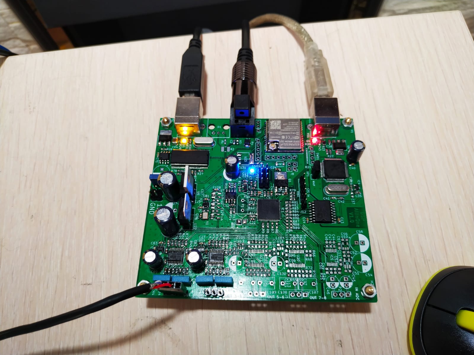

I use PCM1798, PCM5102, ES9018. And internal DACs ADAU1701's
Bested - 1th ES9018,2th PCM1798,3th PCM5102.
I have PCM1794 and AK4458 chips. I do DAC later.

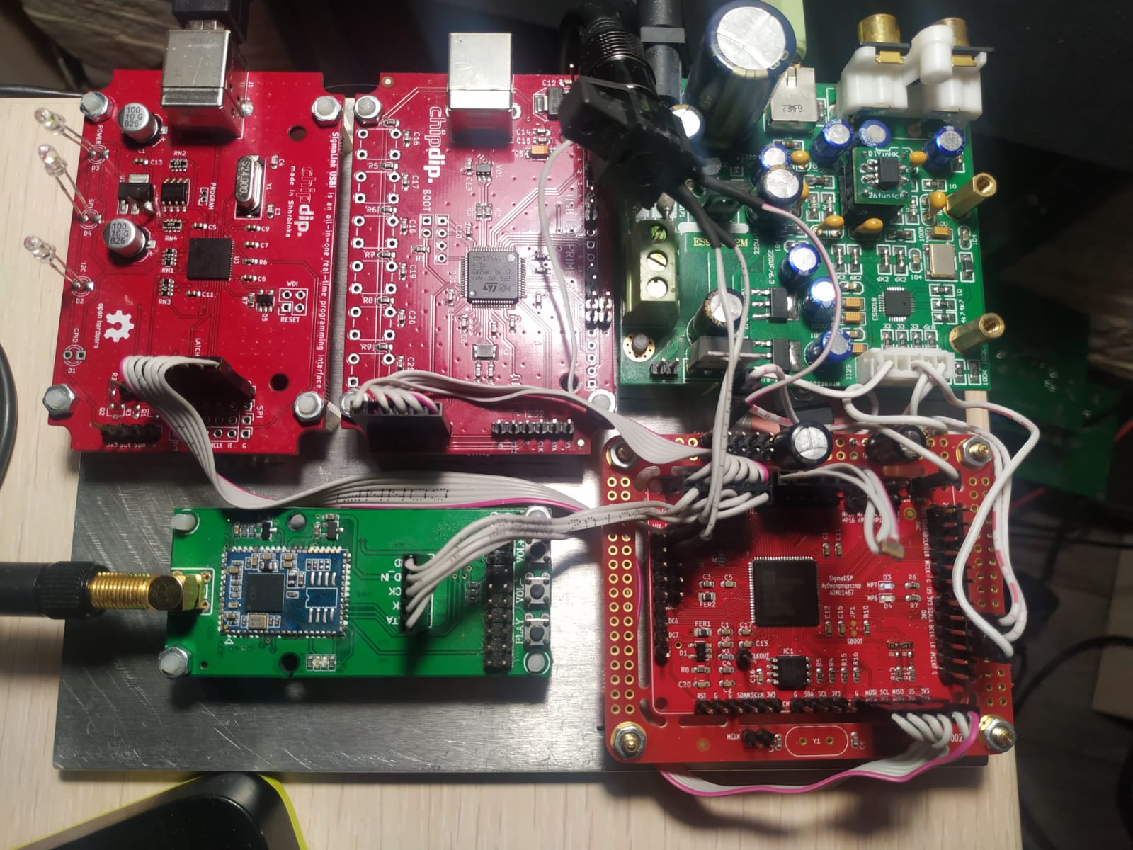

My DSPs selfmade ADAU1452, out DACs PCM5102.
And assembled from China DAC ES9018 and chipdip.ru parts as ADAU1467, USB-I2S STM32f446, Sigmalink programmer.

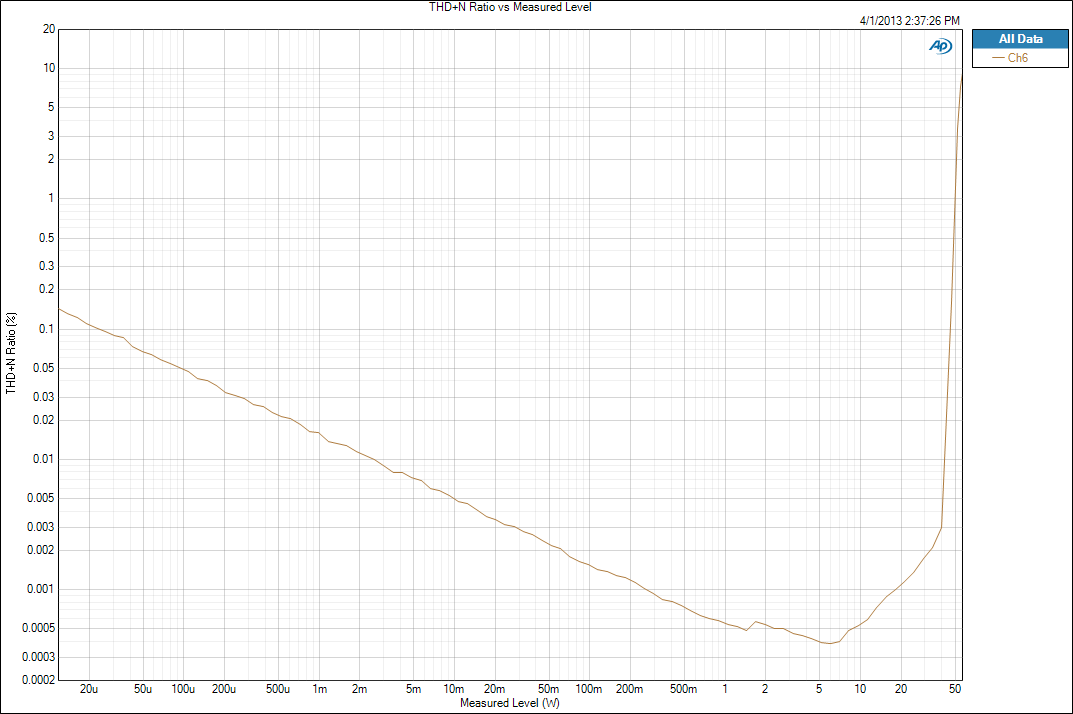

I'm with you 100% on the above... which is why I'm confused about your standpoint on PFFB.
The reason I've avoided class D all these years is 2-fold:
1. Output noise - almost all non PFFB implementations have clearly audible output noise when driving wideband transducers. Not an issue with subwoofers so much, but I cannot stand audible noise from an idle system. If you can't get your noise levels below the audible threshold then you're likely wasting your time with other modifications.
2. SINAD - Outside of subwoofer use, the reality for almost all amplifiers is that they do indeed operate in the mW to ~2W range for 99% of their operating time. Rare peaks and loud transients may very briefly exceed this, but most of what you hear is the amplifiers performance between 0W and 2W. Class D amplifiers are terrible in this area... falling short of even tube based implementations at lower power levels.
As an objectivist, getting a 6dB improvement in both the above for the cost of a nice op-amp (OPA1632 ~$1.15) and a few discretes (~30 cents) is likely the best value for money you will get in your entire system chain. For those less technical, 6dB sounds like "only 6" which is not a big number, but 6dB means half as much... half as much output noise, and half as much output distortion. Or to put it another way, any non PFFB arrangement has double the distortion and double the noise.
The next argument will be: "but you cannot hear the difference between 0.001%THD and 0.0005%THD." and I would agree with you. There are no loudspeakers on the planet with distortion that low, so claiming to hear that through even a good set of headphones with 0.05% THD is dubious at best. But that figure happens at 50W output into an 8ohm load! I don't know about you, but I don't listen to music at those output levels for very long... and when I do, I'm too buys playing air guitar to notice ;)
Where is does matter is in the >1W territory where you will spend most of your time listening critically. In this area we could be talking about the difference between 0.5%THD+N and 1%THD+N and that is absolutely in the realm of audibility.

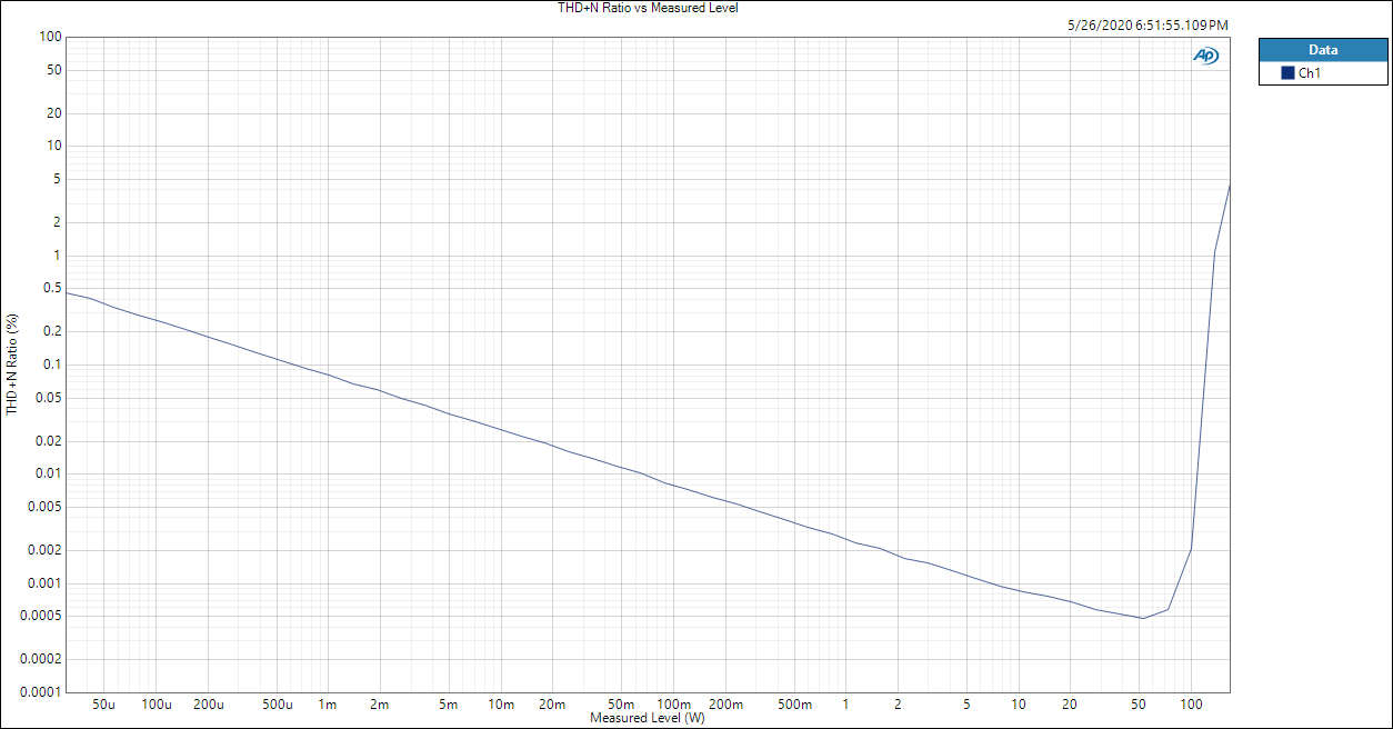

Attached is a plot from the monoblock TPA3255 I just finished with PFFB.
Also attached is a plot from my MPUHP 50W class A/B amplifier from a few years ago. Sure, the difference in peak THD+N performance is only 0.0004% vs 0.0005% certainly not audible, but it's everywhere else below 2W where the Class AB amp is a factor of 5x-6x better when it comes to THD+N. This is why I can't stand single-point distortion figures for amplifiers. They are largely meaningless unless you fully quantify the where/what/when of that single point.

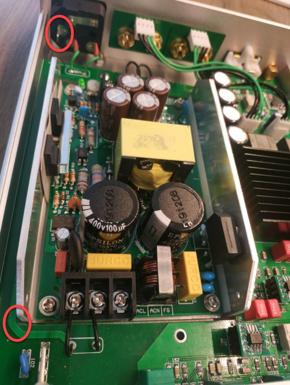

Can anyone spot the lethal double whammy in the attached image?
I'd be more concerned about that than the sound quality ;)
You are afraid it will catch fire lol :D
I personnaly buy an amplifier for its sound ... we can list all its faults it is sure...
It is not a $1000 amplifier amigo ) If you need $1 to set the ground, hummm ....
