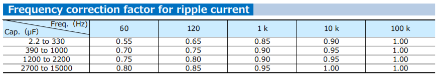

Note that ripple stated at 100 kHz is not applicable to supply caps. In order to calculate the ripple at low frequency (60Hz or below) , as a gestimate, multiply the 100 kHz ripple current by a correction factor .75 (average) to .66 (with safety margin) and you can get an idea of the ripple. Correction values are based on a Panasonic specs sheet and used as reference.
This matches voltage and capacitance to the TPA3251EVM supply caps. Will do a full 36 Volts supply and it has a very nice ripple current.

Frabor, yes of course, but the correction factors (frequency, heat etc.) should be pretty similar for caps with similar construction so that their relative ripple ranking remains the same 🙂
