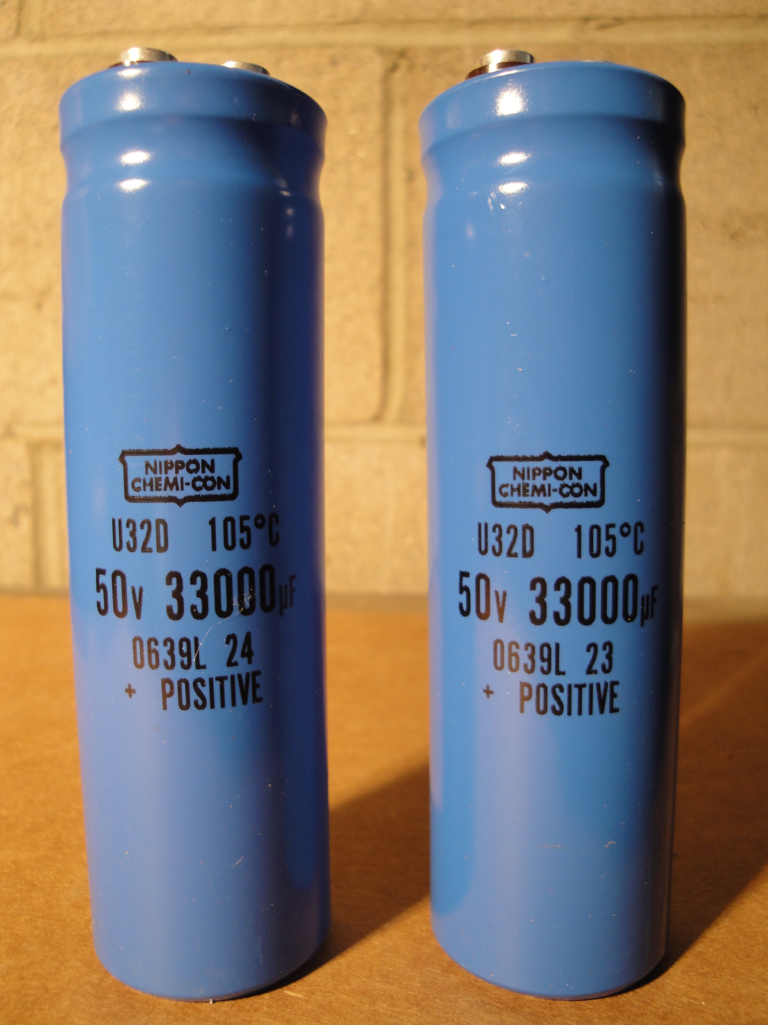

what are you doing for a power supply?
In my stash I found a lil XFMR 500VA with dual 25V windings and +/- 10% taps on the primary. a couple of 25A bridges and dual 33,000uF i'll be in chip amp PS heaven. switchers are for losers, ill have 5 times your current and better eff.
custom XFMR sampled from one of my old jobs
