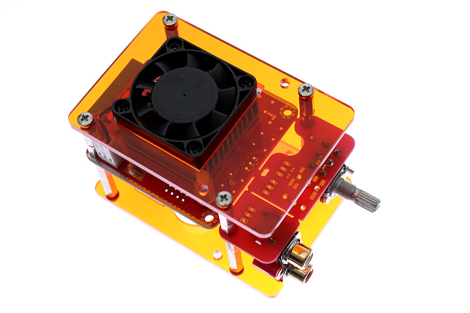

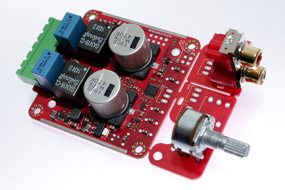

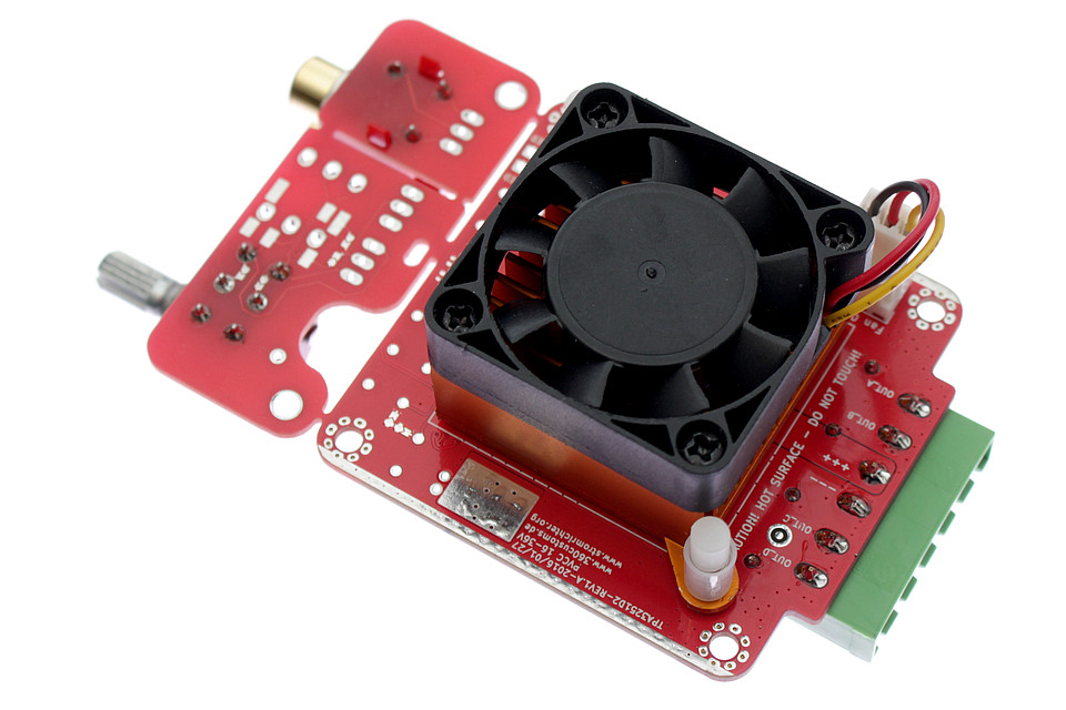

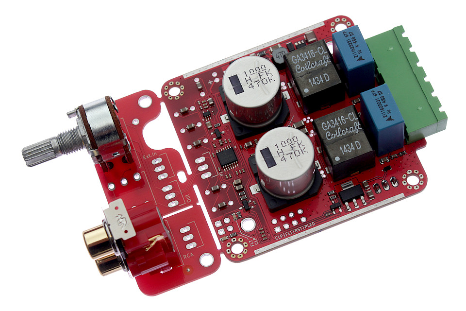

Tthat's incredible how small this tiny amp is on the photographs !
WHat is the value of the "big" blue MKPs ?
Does a 250V PPS smd cap could be suitable and precise enough here ? Or do you need just the lowest Tang loss possible with the cap you use here?
Thanks. The caps are 1uF 450V MKP choosen for low tang - right. I've had MKTs on the bigger blue pcb, worked as well without getting warm/hot. (1uF 63V WIMA)
But there's more heat/loss in MKT compared to MKP. Still waiting for the chinese CBB drops to test.
From the simulations, a 250V X7R would also do, but package size isn't that "crack-proof". (2520)
