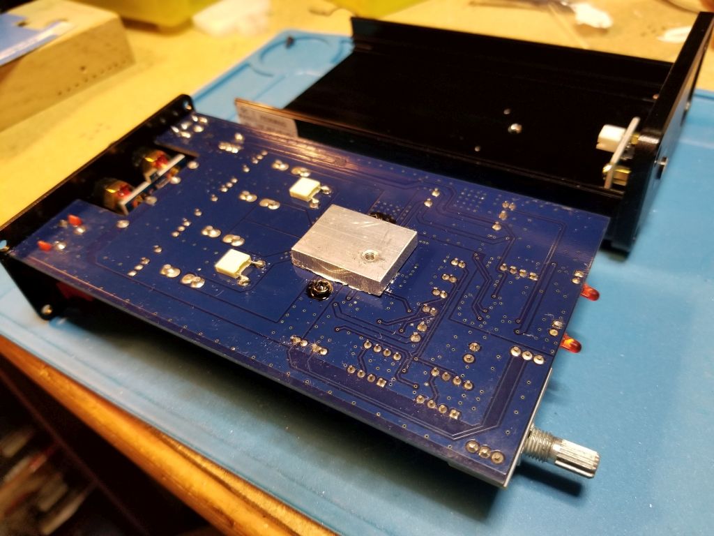

Thanks to this thread, I went ahead and modified my Amp as per posts by @chermann and @irribeo.
I replaced the LM317 resistor with another 0805 surface mount 3k6 and soldered the cap across it - as shown in pic 1. Pic 2 shows the extra heatsink and bypass caps in place. I cut a rectangle from an old (dead) PC PSU heatsink that was the perfect depth, then glued it in place with heatsink epoxy sandwiched with a silicone transistor heatsink pad to isolate it from the PCB. I cut around an existing threaded hole in the heatsink and used that to attach to the bottom of the case (took some very careful measuring to get the hole in the case correctly!).
Anyway, all works now, though not had time to do any real listening tests. Thanks again to all.
