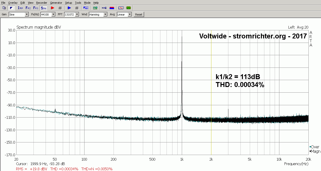

1# NE5532 - nothing wrong with them
Voltwide showed THD performance for genuine TI NE5532 in a test setup as so:

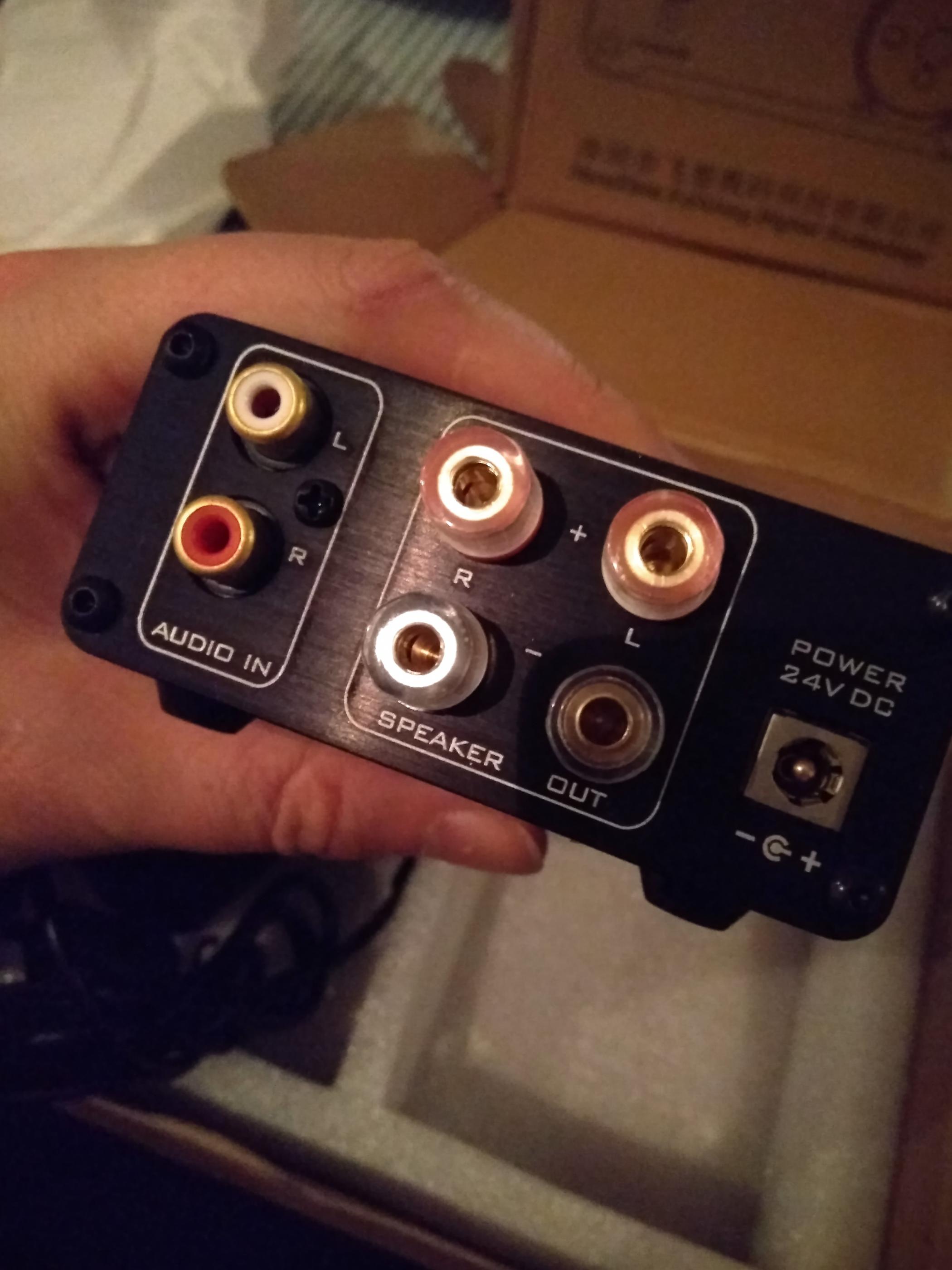

3250 Impressions
Running source content through ,Yamaha wx50 pre ,streaming pandora and tidal to 3250 to Pensils ,nearfield--- The sound was very good low to mids . Volume pot was very very sensitive . After I listened for a couple of hours, moved it to wifes office tv [ replaced a Lepai 2020] and she said , thanks, sounds good. WAF . I was hoping for a D amp to get me interested in amp building, modding, whatever. Maybe. This old man loves music, for my ears, good sound as described.
