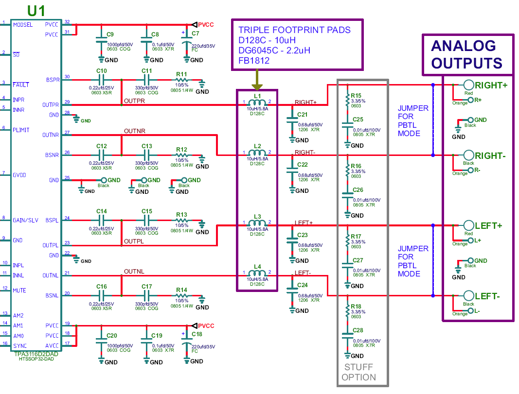

Look in tpa3116 thread. I had a fizz on
Piano notes that were forceful and fixed with output snubber circuit before L. 330pF and 10ohm connected to bootstrap to control hash. Sounds fantastic now - fluid vocals and clear piano strikes.

Look at how C11 and R11 are connected to the output pin before the inductor. This is the so-called "bootstrap snubber" and is an optional circuit on the TPA3116D2. Many boards made use the standard circuit which doesn't have this, but the TI EVM board has it. I have used both ways and it make a big difference with hash or fizz sound on hard percussion like piano or sibilance from certain female singers. It is not a standard implementation on the 3123 but I don't think it can hurt.
Here is how I implemented it on the back of my board by scraping off varnish to expose ground pads and used existing bootstrap cap pins poking through:
I used 330pF 100v ceramics from AVX and 1/4 watt 10 ohm metal film resistors.
Thanks xrk971,
Sorry for the late reply, only 2 years late, but life sometimes gets in the way and I'd all but forgotten about this thread.
What you suggest looks doable for me so now I'm back on board so to say I'll give this a shot. The second 3123 board I alluded to earlier sits in my gubbins draw along with others, all waiting for me to get around to fixing up, but the 3123 really did sound pretty good and so deserves another crack.
