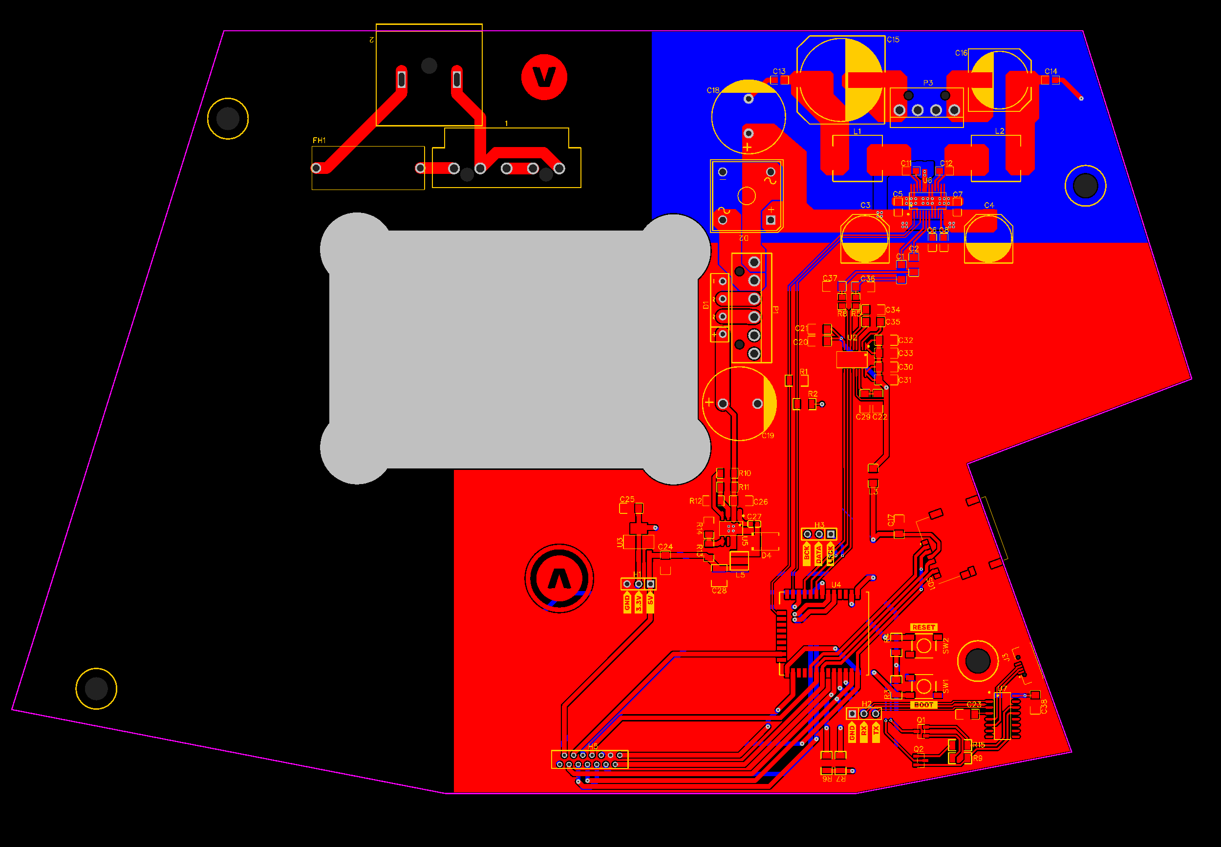

Problem 2: This is the big one. Most of the PCB is under the speaker canals and has a maximum height of 12mm. Not many components come in under 12mm - just resistors, ceramic/film capacitors and DIP packages really. Large caps, regulators, heatsinks, connectors, diode bridges - none of these will fit. Anything over 12mm must be crammed into the back of the unit or the lid won't fit. I measured this wrong (the cavity is a very odd shape) and so the lid isn't even close to fitting. As such, I need to completely rearrange the PCB to make it fit.

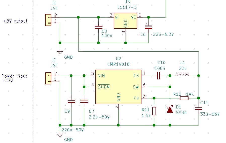

If you have trouble with the size and heat dissipation of PSU, you should move to a switching one :
Replace 7805 by either a LM2596 on your pcb or on a Ali/Ebay module : Module d'alimentation Ultra petit LM2596, BUCK cc/cc 3A reglable buck module regulateur ultra LM2596S interrupteur 24V 12V 5V 3V | AliExpress
or better use a more modern chip such as LM14010, it costs nothing at LCSC. It provide a clean 5V and run much faster than the LM2596 : 700kHz vs 150kHz.
Picture are diagram and PCB. For 5V values of R11 and R12 should be tuned.
Diode bridge pin could be folded or you can use low profile ones (square / flat)

Thanks Chris,
Here's my updated PCB design. That large heatsink at the back (this is the only location with good airflow) is for the reg. Even still, I'm not sure it'll be enough once the display starts drawing power!
Because of this, I was thinking the same (switching reg) and was already building a board around a switching reg. I was actually considering the LT1376 which comes in a 8-DIP and requires few external components. It's rated for 1.5A@5V and switches at 500kHz. I haven't done much with switching regulators until now, other than a small step-up for my Hypnic power controller.
I couldn't find the LM14010 you referred to - is that a typo?

That is cheap, and for a switcher the application seems pretty simple. My only reservation is that it's only rated for 1A. Since the ESP32 and display can (potentially) draw 500mA between them (OK, that's the display with all pixels on and the ESP32 transmitting WiFi) that doesn't leave a lot for the SD card, ATTiny, passive components, DAC, etc. Especially since the 3.3V regulator will be running from this supply, further reducing efficiency. The LM2596 is 3A and the LT1376 is 1.5A. These may end up being more suitable simply due to power draw.

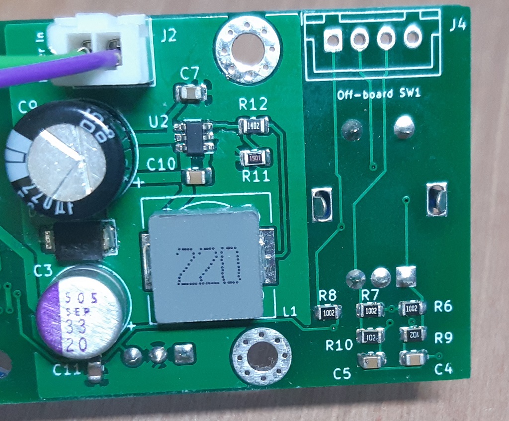

The schematic is largely unchanged, except for the removed pot and the new 5V regulator (I went with the LMR14020 - the big brother of the LMR14010)
However, with the newly understood space constraints I've had to modify the design significantly. My dream of through-hole components is now largely gone. The entire MCU section and both the 5V and 3.3V regs are all surface mount so they can fit in the main body where height is an issue (12mm max height), as well as some of the amplifier sections - although these are for footprint reasons. Space is very tight and the DAC consumes a significant amount of the available space.

So, latest PCB to go into production (probably later today). The placement of the DAC module is a pain, so I've decided to go all-in with bringing the PCM5102 onto the PCB instead of using an off-the-shelf component. I will admit I've not soldered a TSSOP package before, so the PCM5102 will be a little adventure. I have a hot-air reflow station but this is my first time working on something so tiny!

I've put together the SMT board - the new regulators are working well, I added the ESP32 and flashed it with no issues - got the display working, too.

OK, I think I've figured it out.
After re-measuring everything, I've realized that the input voltage to the LMR is nearly 20V - much higher than expected and the circuit is off because of that. Switching regs are fairly sensitive to input voltages and require different components to offset output ripple - I suspect the ripple is pretty high on my output. This also makes sense as the PN532 NFC sensor is very sensitive to ripple and it's likely that's what's causing it to malfunction (i2c). This would also explain the noise on the I2S lines.

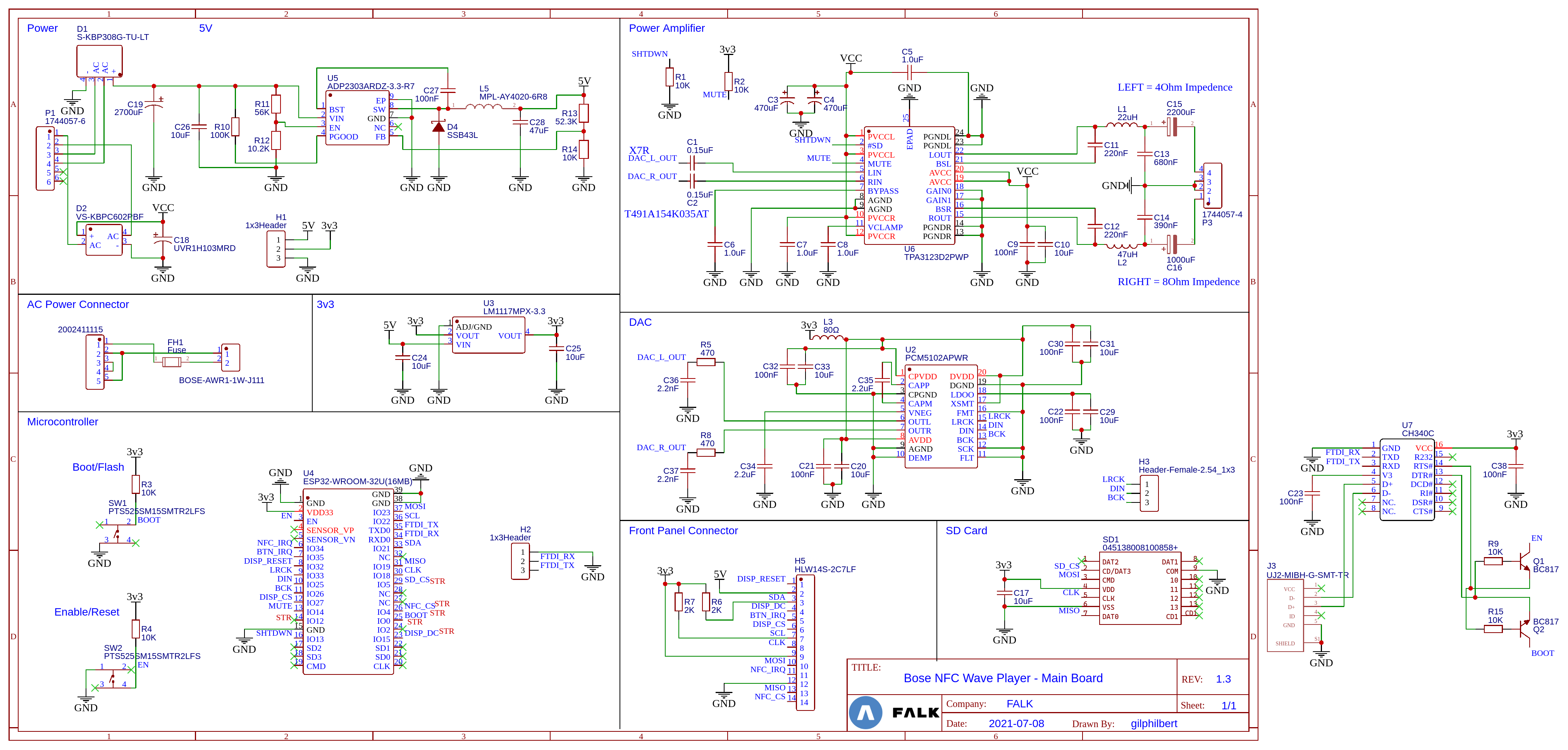

I finally have the whole thing working - which is awesome, but it sounds pretty terrible! A ton of research last night made me realize my mistake(s), which are coming back to haunt me. I really must learn to read datasheets thoroughly.
  • After careful measurement, the left speaker is 4Ohms and the right speaker is 8Ohms. That's fine for the old class-AB that was in the old PCB, but Class-D requires a little more tuning on the output for this setup
  • The output filter is wrong for the 4Ohm circuit (no low end)
  • The DC blocking cap wrong for the 8Ohm circuit (no low end)
  • The input capacitor I'm using is a film 1uF, but going through the datasheet, this can be much smaller - 0.15uF would be fine for my gain setting. The 1uF value isn't a disaster (this sets the frequency cuttoff to ~7Hz with a gain setting of 20), but the datasheet specifically calls out tantalum or ceramic caps for the input capacitors
I've also discovered that without a pull-down capacitor on the amp's shutdown circuit, when I put the ESP32 into deep sleep, the shutdown pin floats, so the ESP can only go into light sleep, not deep sleep. Muting the DAC is a bit of a pain - timing it is very difficult as it's dependent on the sample rate of the stream. Switching to muting the amp would make far more sense as it has a static duration for mute/unmute (100ms).
Finally, since I'm trying to get a little better sound from this amp (and my power supply is a fairly low 12V), I'm stepping up to the TPA3122's bigger brother the TPA3123. It's basically the same chip, but it's in a TSOP package and the ground plane requirements are a little different.
You'll notice on the new schematic that the output filters are different on the left and right channels, as are the DC blocking caps - this matches the different speaker impedance ratings. The input capacitors are now 0.15uF tantalum caps, and there are pull up/downs on the amplifier controls.
I'd really appreciate some feedback on everything, especially the ground planes. The amplifier's ground plane is on the bottom layer as recommended by TI. The rest of the ground plane is on the top layer. The two ground planes intersect at the ground pin of the bridge rectifier for the digital components (D1).

A little extra detail on the components for the TPA3123:
The other caps are all MLCCs - high quality ones, especially for C11, C12, C13 and C14.
Thanks in advance for any suggestions / corrections
