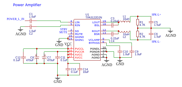

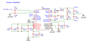

Schematic
The values are lifted from the datasheet's diagrams and tables.

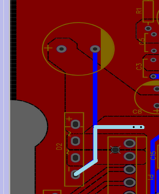

PCB
Since this is part of a much larger board, I wanted to make sure this was right before I went ahead with it; any suggestions/comments would be greatly appreciated!

Schematic
PCB
- The TPA3122D2N amp (U1) is serviced by two different ground traces; GND and AGND (analog ground). These are kept separate through the DS1801+ digital pot (U3) and DAC (H4 and H5) and are joined on the left, just below the filter capacitor, which is currently unlabeled. This is recommended in the datasheet on P14 (PCB layout). Ground traces are all in blue, AGND is identifiable by the pair that run down the length of the filter circuit below the amp.
- All non-electrolytic caps are TDK ceramic capacitors (X7R rated). Electrolytic caps are all Nichicon.
- The radio doesn't produce tons of bass, so I've used 1uF ceramic input filters but I'm happy to change these for electrolytics if recommended. The datasheet doesn't mention proximity for these, I have put them either side of the IC.
- The inductors are Murata 18R223C with 2.4A ratings
- The datasheet doesn't specify whether to connect the -ve terminal of the speakers to AGND or GND (power ground); I went with AGND.

Hello,
Did you test on perfboard with Enable and Shutdown correctly set ?
About PCB, I just roll an eye on it, but you have to use much wider traces for power, gnd, speaker, etc.. wires. About GND is power ground related to the output (speaker and PVCC) and AGND is input signal (input and AVCC). Try to separate PVCC / AVCC and also GND / AGND.

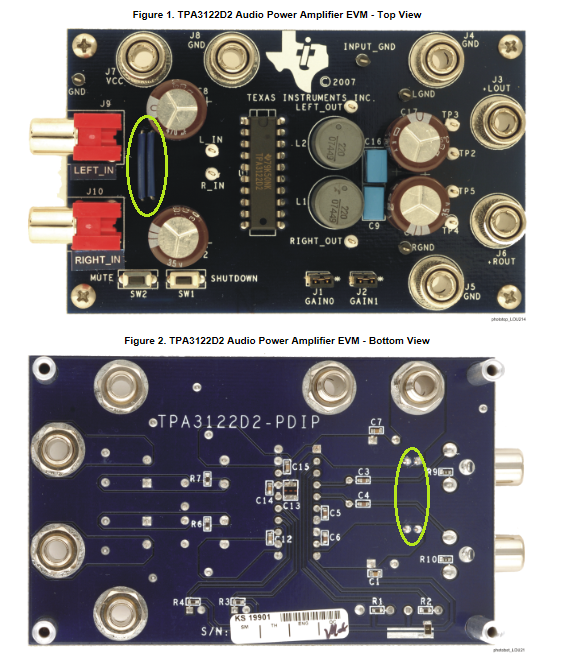

TPA3122 EVM should give you some insights : https://www.ti.com/lit/ug/slou214a/slou214a.pdf?ts=1621191104111&ref_url=https%253A%252F%252Fwww.ti.com%252Fproduct%252FTPA3122D2

I studied that well and was surprised they seem to have broken some of their own datasheet rules, from what I can read of the board. The high frequency decoupling capacitors are not particularly close to the IC, and I can't tell how the power to pin 10 is delivered, there doesn't seem to be a trace for it.
Ground seems to be split by input and output, with a single join point at the bottom of the board.

New pcb…you’re fast!
About DS and EVM: I agree, it’s pretty difficult not being able to rely on documents which are supposed to be reference documents.
About pin10: this is single side pcb, so they use straps on component side, see pic.

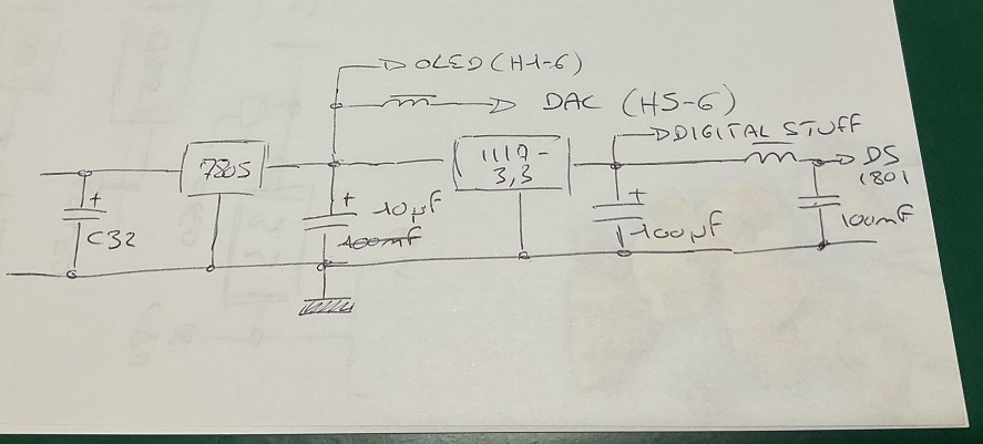

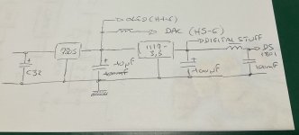

I suggest the following schematic for power distribution. 7805 will certainly produce some heat, but 1117 won't. You can also cut your 2 reservoir caps by half. (I admit this is not a very common advice here in DIYAudio...😛)
Impedance of the choke is 1kΩ @100MHz, not DC nor low frequency. See this video : #84: Basics of Ferrite Beads: Filters, EMI Suppression, Parasitic oscillation suppression / Tutorial - YouTube, w2aew videos are great !

I've added the power circuit you suggested. It's a simplified version of something you suggested previously. I think I have a few 7805's around here somewhere anyway, so it won't cost me anything to add it anyway.

These are the updated schematics/PCBs. The SD card is now wired the correct way. I upgraded the inrush capacitor to 10uF (this seems to be a general recommendation) and I removed the smaller heatsink for the 7805. Otherwise this is unchanged.
The copper pours for the outputs are still present. EasyEDA just doesn't like to draw them when exporting to PNG.
