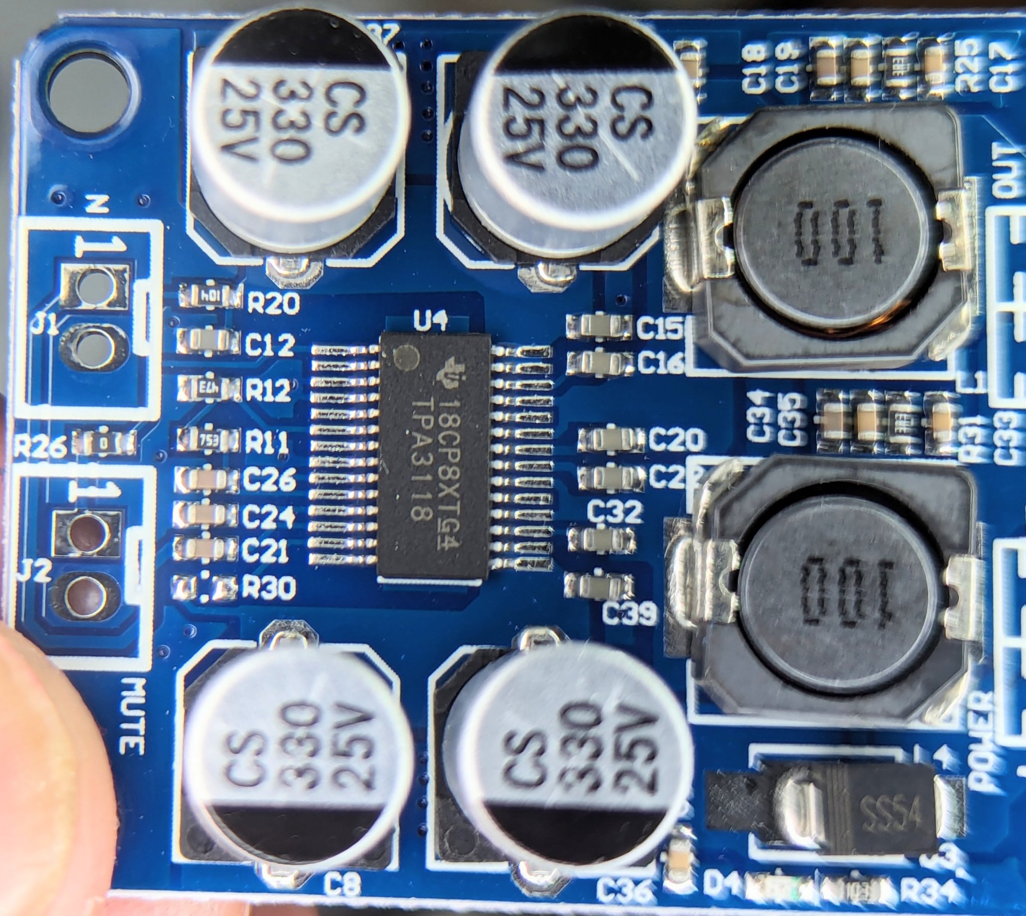

For gain-setting resistors on TPA3118 (BLUE) PCB:
Can we just stack (up on R28( parallel 39k resistor to get ~20k? Likewise, if one were to stack an 82k resistor onto R28 inn parallel, could we get ~26-27k ohms(rather than removing and replacing)? I am loathe to remove & resolder SMD resistors, (fearing damage to pads)but it seems a simple matter to solder another on top. Thanks & best wishes .

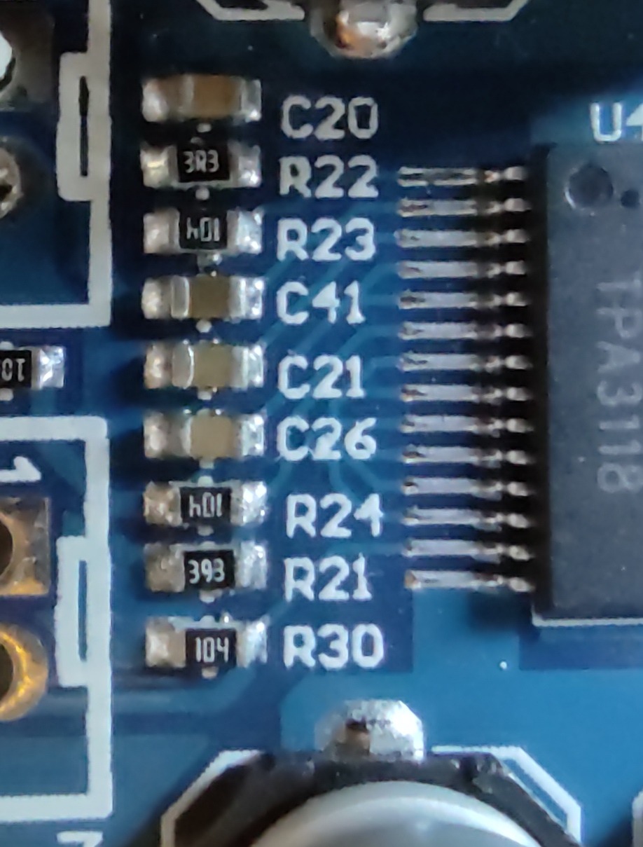

My board has a slightly different resistor numbering.
Gain Resistor values..."
Mine is also different from the above boards. Anyone have a similar board and know which is the gain- setting resistor to remove for 20dB gain?

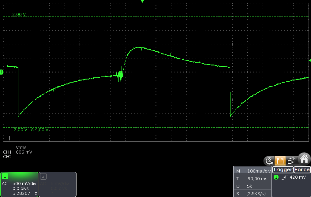

I have the pop noise about every second, too.
Before I change the gain resistors, I made a picture with an oscilloscope:
Gain Resistor values: R1 47k, R2 100k
I plan to bridge R1 with another resistor to get around 20k -> 26dB.
What if R1 is below 20k does that simply reduce the gain further?

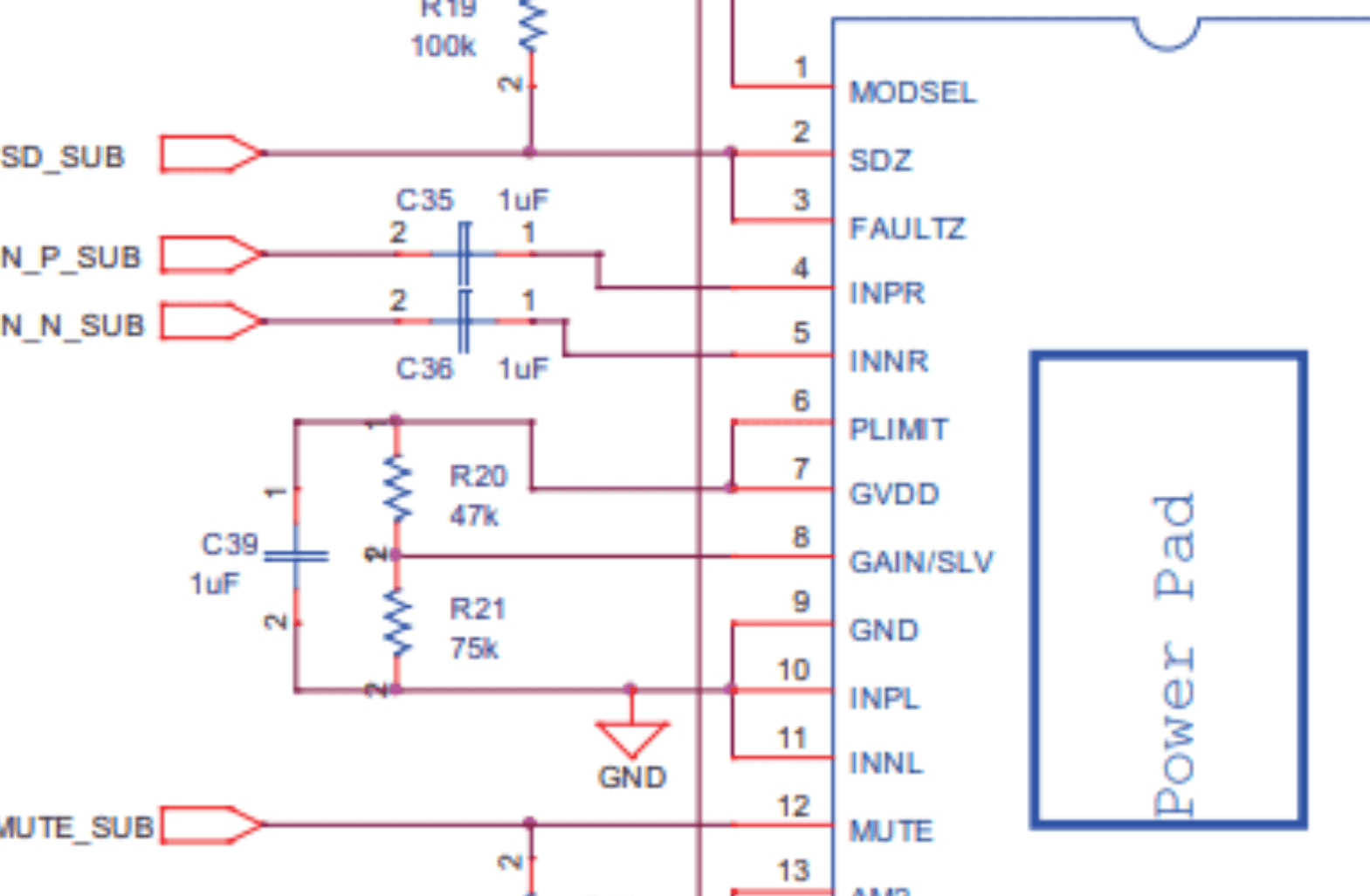

After studying the pinout diagram for the Tpa3118 amp It appears that R11(75k) and R12(47k) on my boards are equivalent to R20(47k) & R21,(75k) in the pinout diagram.
Does this mean I can lower the gain (to 20dB) by removing the 75k resistor(R11)?
Or am I missing something?

These boards have a counterfeit chip onboard, as you can see from the different pin count compared to the real tpa3118. I have a couple of them but they had a different component layout, so I can't be sure if removing the 75k resistor will reduce the gain; my boards had pin 5 and 6 tied together and those could be connected to ground to lower the gain.Sorry for the duplicate postong above(my phone's acting up)

If the chip has remained the same as mine, then it should be equivalent to a tpa3110, therefore you could check whether pin 5 is connected to ground or not, and Chech which voltage is on pin 5 and pin 6 while the board is on.

The original tpa3118 has a 32 pin package (see TI datasheet).
The chip in the image of your post #28 has only 28 pins.
