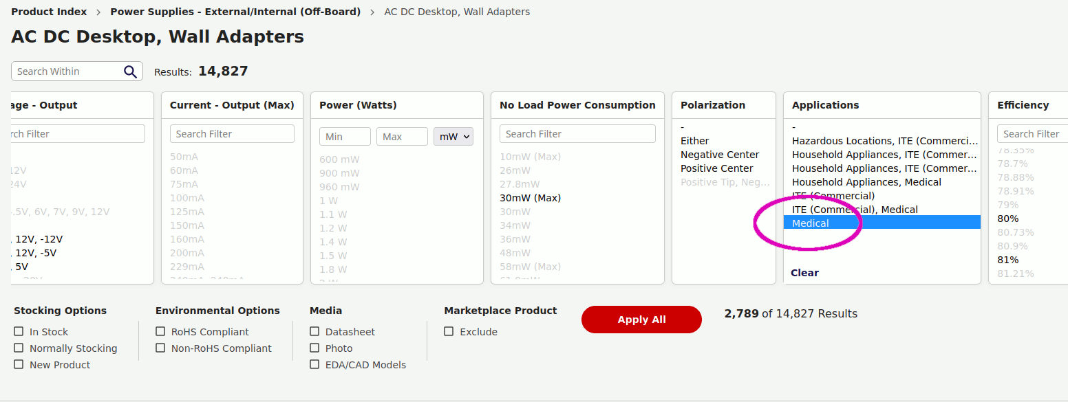

I note that Digikey stocks lots of "medical grade" power supplies (see attached image). I doubt hospitals will look favourably on patients being subjected to 60V rms AC at high impedance. Safety concerns aside, that would wreak havoc with ECGs and other medical electronics that reads skin voltages.
So I suspect these medical grade small SMPS have grounded ouputs. But I'm not sure of this. Can anyone confirm?
