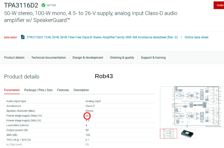

1) Texas Instruments lists a MAX voltage of 26 volts for the TPA3116D2 chip, I'd personally run it at ~90% so roughly ~23.4 volts.
2) The CCM250PS24 looks to have about +/- 3% voltage adjustment, you'll need to adjust it almost all the way down. Please use your multimeter.
