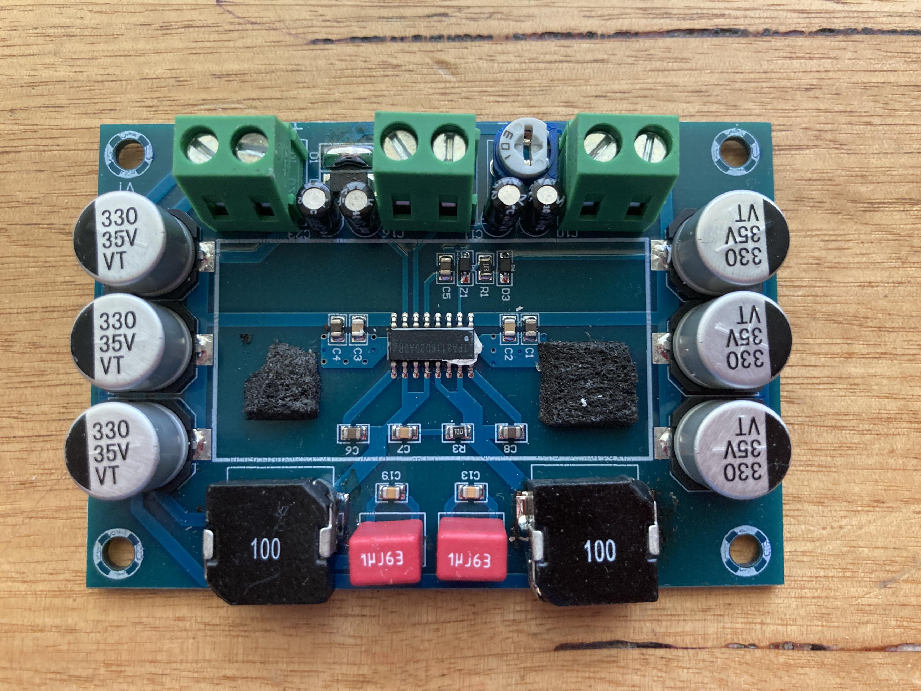

This is a PBTL. Which means two bridged amps in parallel. It can push some serious power into a 2 Ohm loudspeaker. At 24V into 2 Ohm with 1% THD 120 Watt.

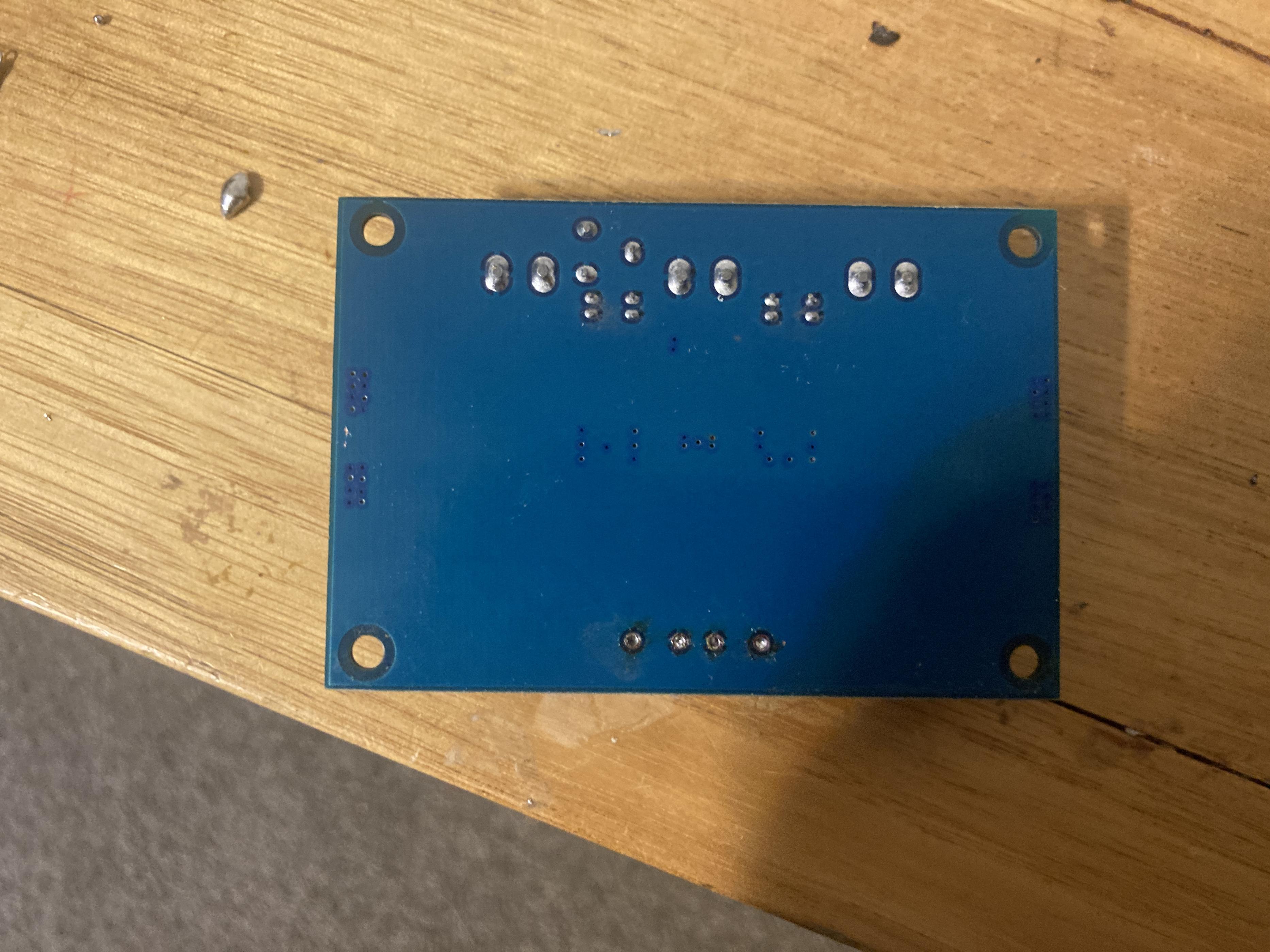

Can you post a picture of the rear side?

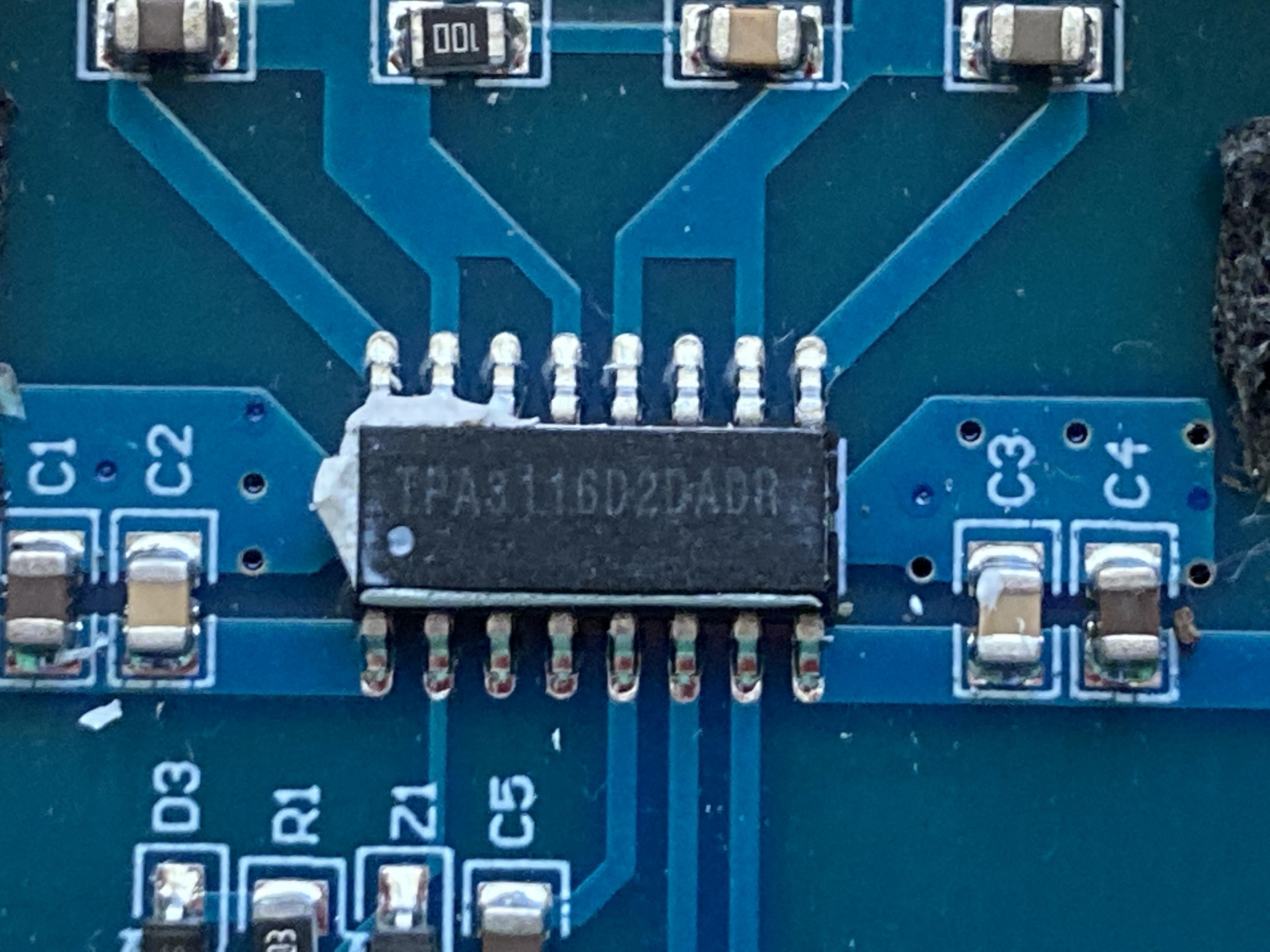

Seems, apart from the normal "Chinese fake anything mentality", they are running out of genuine chips they have to import, in more than one sector.

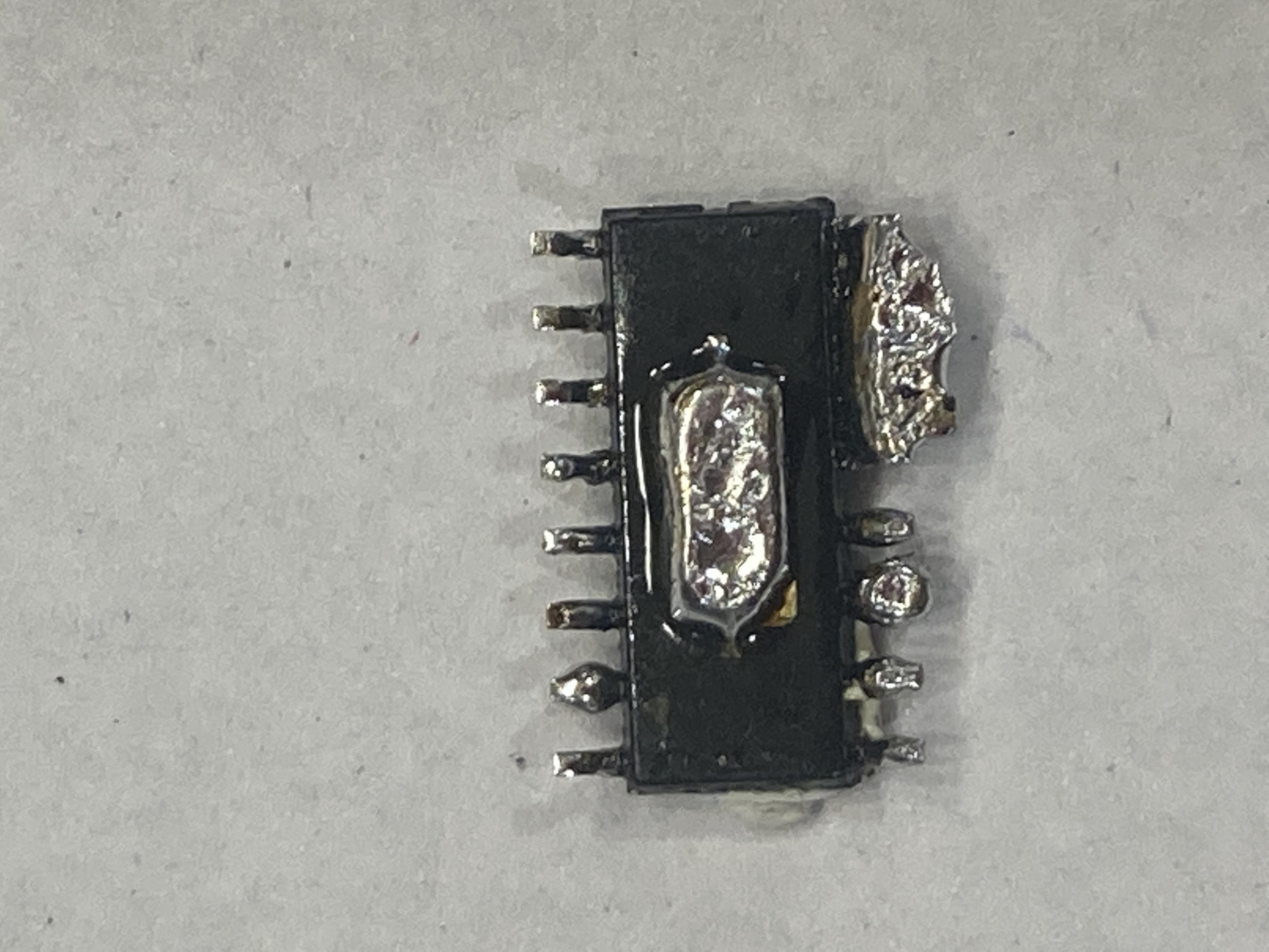

They still can not copy the newer, mixed technology chips, that is why the use this easy to identify Fake chip, which has only a fraction of the TPA3116D2's contacts. Just putting the "magic number" on a cheap IC will not make it the right thing inside...

Any idea what chip this is?

It is a PAM8403. A 3W chip.
https://www.mouser.com/datasheet/2/115/PAM8403-247318.pdf
