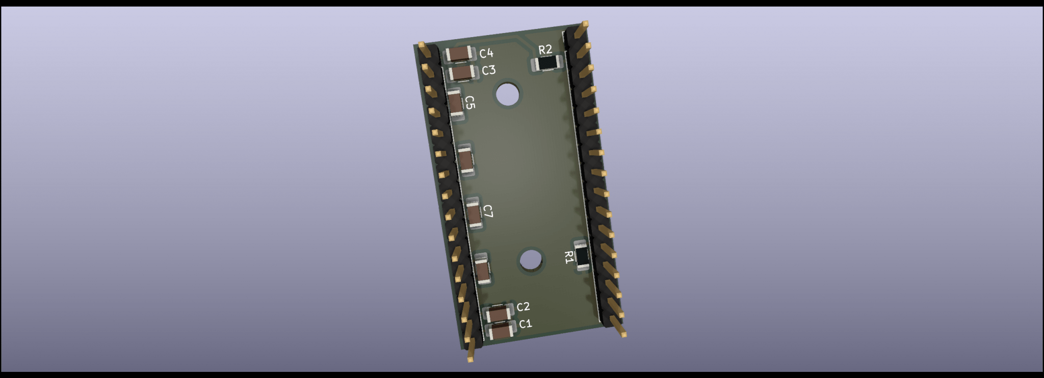

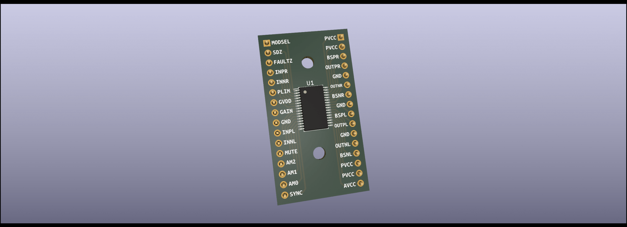

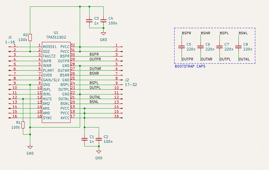

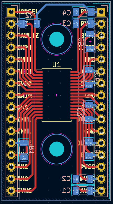

I wanted to play around with the 3116 and I couldn't find any TSSOP breakout boards, so I made one my own. I'm sharing the project if anyone wants to order boards themselves. There's not much to it except for some 1206 bypass caps.
