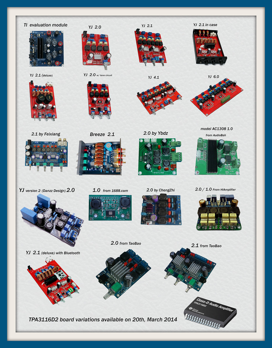

There are many pre-made TPA3116 PCBs available. diyAudio member KJA 2013 was keeping track of them. Latest picture with all known boards from post #2249:

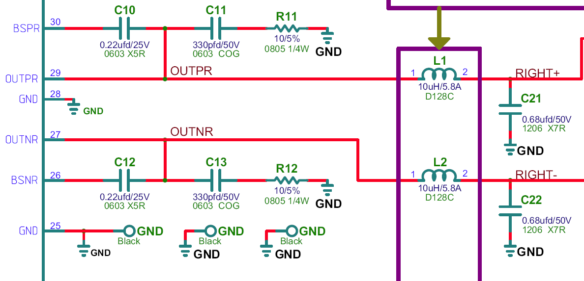

[h=Bootstrap Snubber Mod]%3[/h]

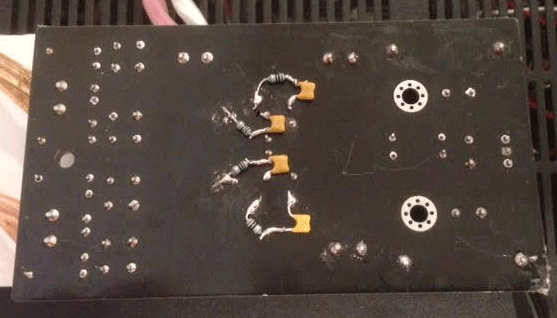

In post #3823 on 13th July 2014, xrk971 described a successful bootstrap snubber mod. Here is the snubber schematic:
And here is a pic of xrk971's work:
See the post for more information.
Later, in post #3845 on 14th July 2014, skylab posted another picture of a successful mod:
Another note: thin film resistors may be preferred for this mod.

[h=Available Boards]%2[/h]
Source: #4658 / xrk971...Wire wound resistors will change inductance of main filter. I use thin film resistors...
