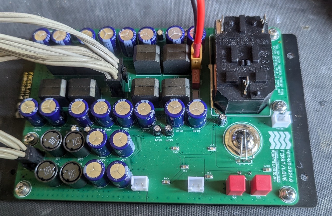

Efore MFA160 24v6a Heat doesn't seem to be the limiter. It gets hot though. Sometimes the psu goes into protection first. So I think its the current protection on the amp and psu are a close match.

IF TI suggests 3.2 ohm minimum load for a single 3116 and 1.6 for two in parallel (just read the datasheet), Logic/Math says you need three in parallel for 1 ohm.

The discussion appears to assume a perfect power supply. With such a low impedance load, I wonder if the power supply is limiting the output current and protecting the amplifier?

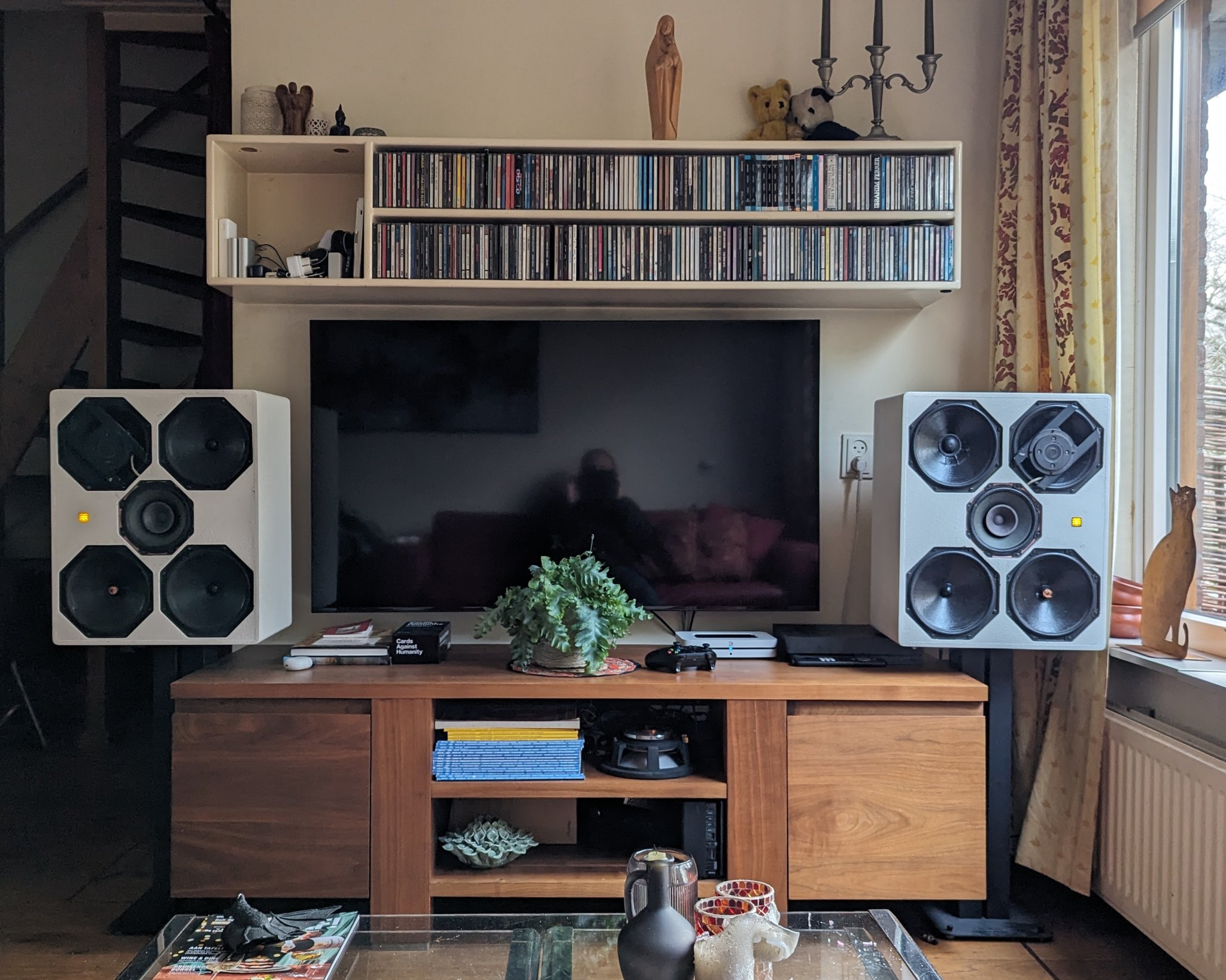

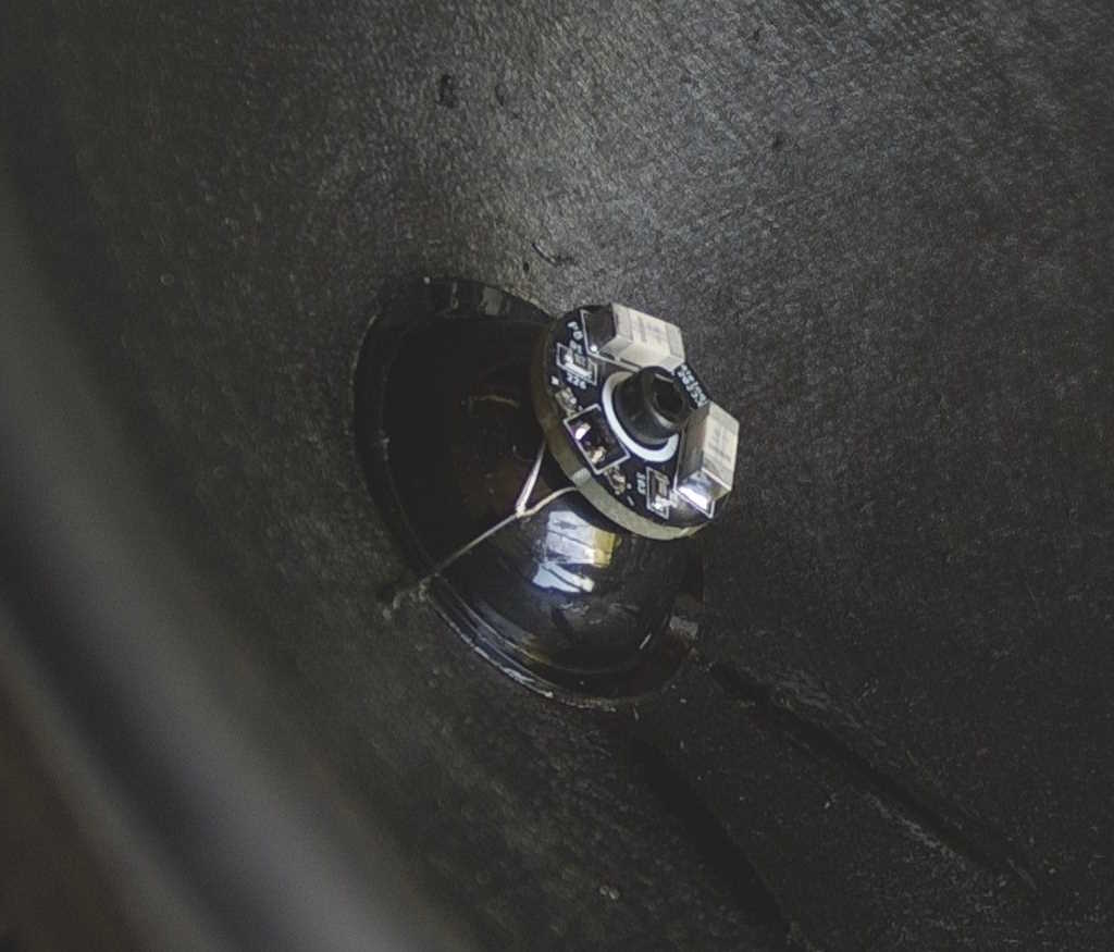

No, 4 vintage 4 ohm AD8066 philips woofers which are setup in a 1:3 master-slave config with the master being servo controlled .
The AD8066 master driver equipped with a StarBass accelerometer :

I eventually choose to go with 4 separate 3116 pbtl amps to drive each woofer individually:
In party mode the 4BMH6D module consumes upto 26A @ 24V which is equal to what it would take on a 1 ohm load.The discussion appears to assume a perfect power supply. With such a low impedance load, I wonder if the power supply is limiting the output current and protecting the amplifier?
Fair point. But thinking broadly, there are three resistances in series here. There is the internal resistance of the power source, the series resistance of the amplifier and the one ohm speaker. So if at maximum output, the combined resistance of the power source and the amplifier is (for the sake of argument) a mere one ohm, then half the power is being dissipated there instead of in the loudspeaker. Wouldn't it work better to use one coil of the speaker and present a 2 ohm load?In party mode the 4BMH6D module consumes upto 26A @ 24V which is equal to what it would take on a 1 ohm load.
