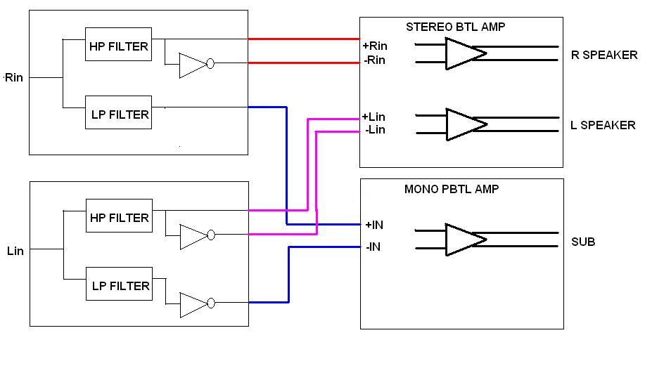

Thanks buehgermeiste, a diagram will be great but I'm unsure that I want to tackle balanced operation, I have enough difficulty in try to understand single ended which is how my 12b4 preamp is setup,
