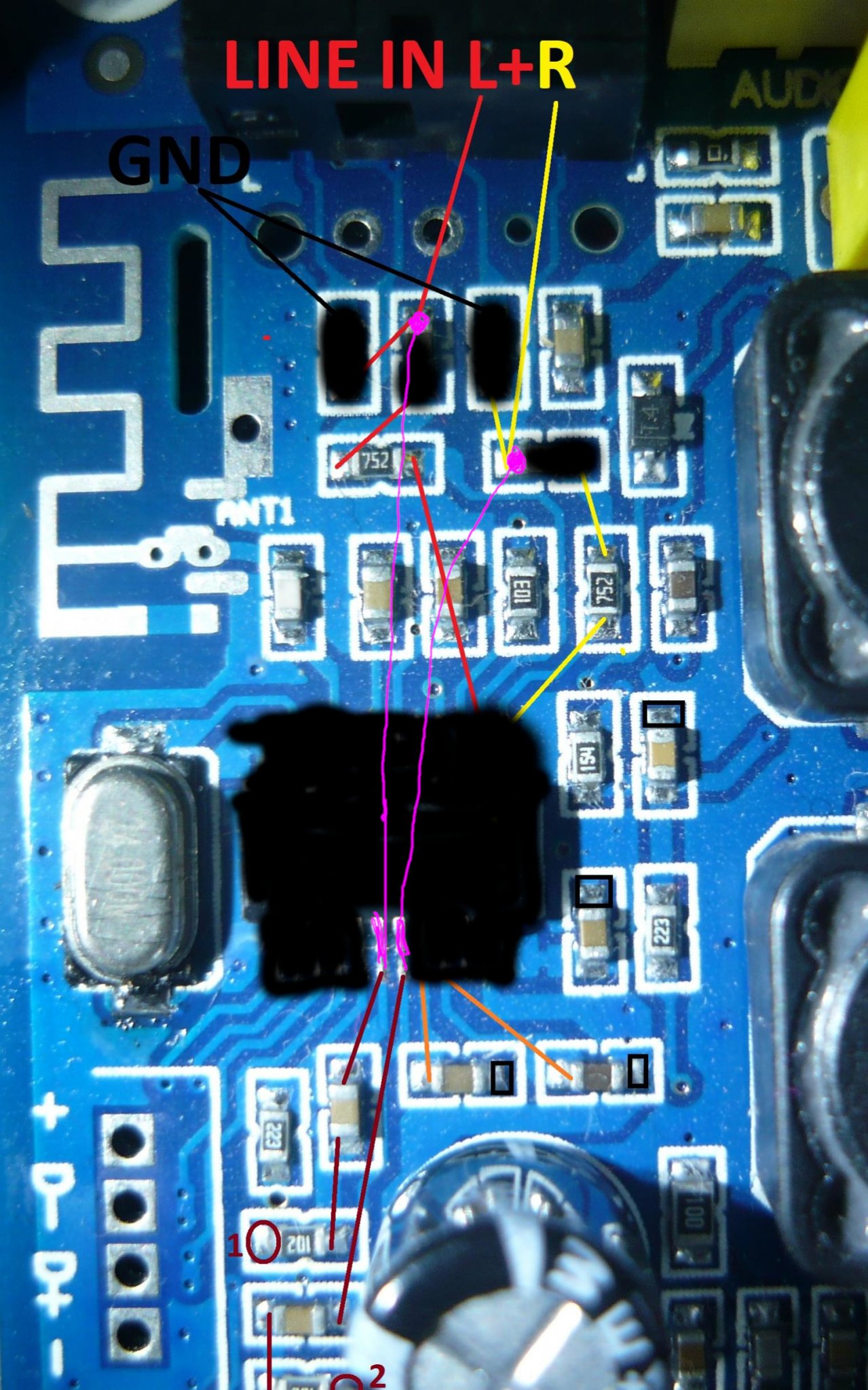

Anybody got the diagram for this TPA3116 bluetooth board?
Trying to run its built-in bluetooth module through an isolated power source because I believe that's the main source of the hiss while playing through bluetooth.
And if there is any common good mods for it I would greatly appreciate it!

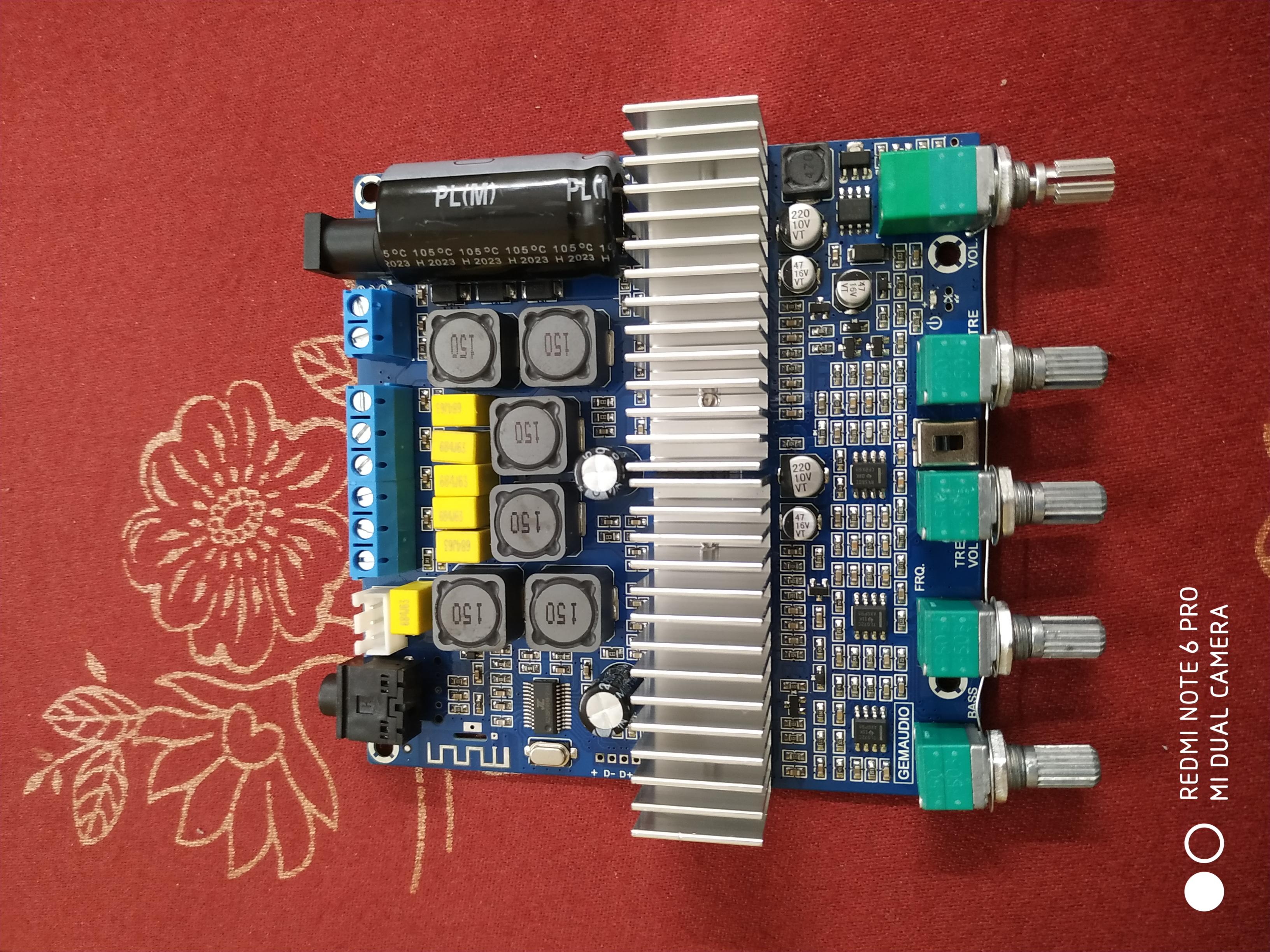

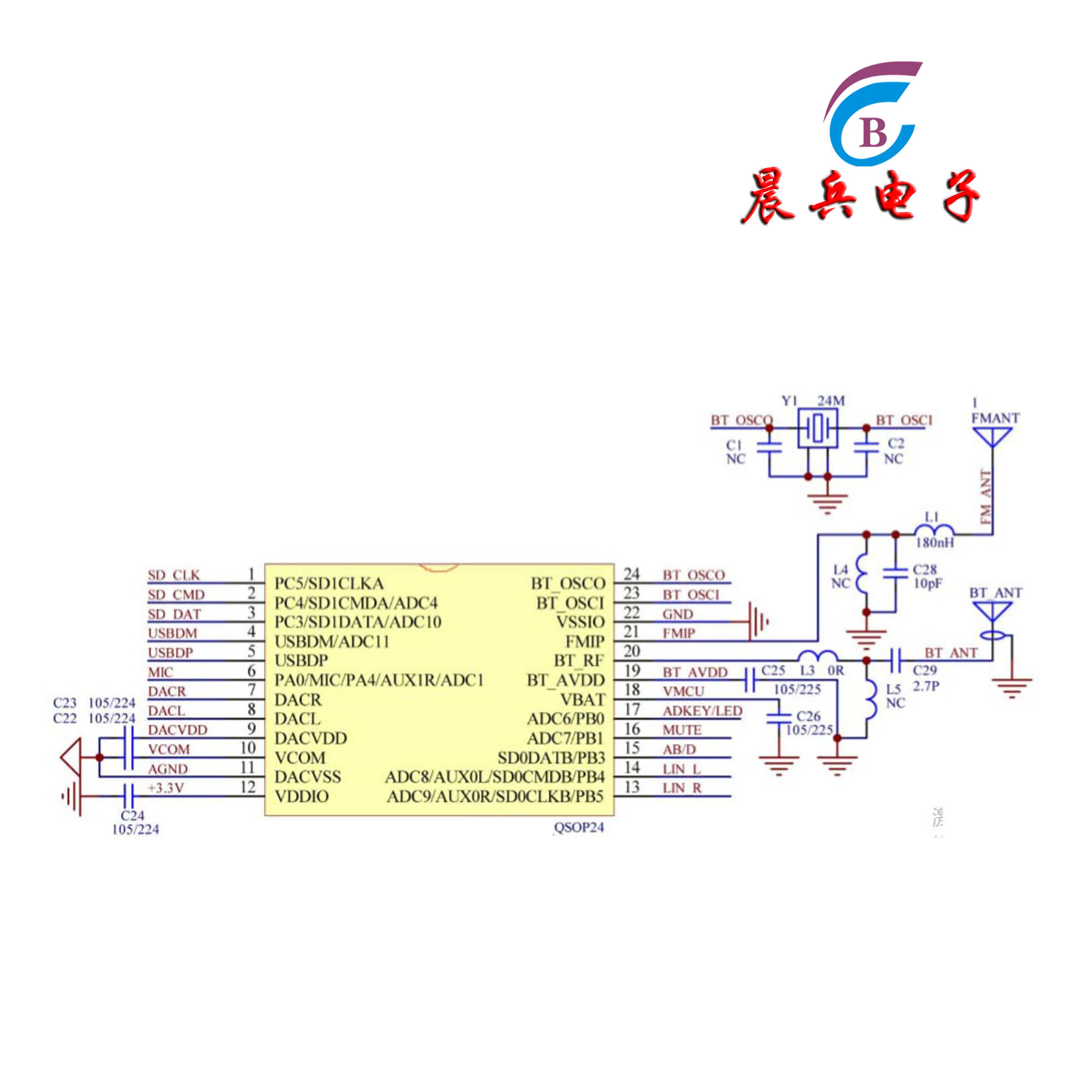

Hi, this is JL bluetooth chip, here iam attaching a picture of JL chips. Iam also using this Class D amplifier, present I have no issues with hiss noises from this boards. Output are clean even the bluetooth section is on and not playing any songs via phone. What's your amplifier board brand name, myself iam using GEMAUDIO board. This amplifier is very silent. Best Regards JP.

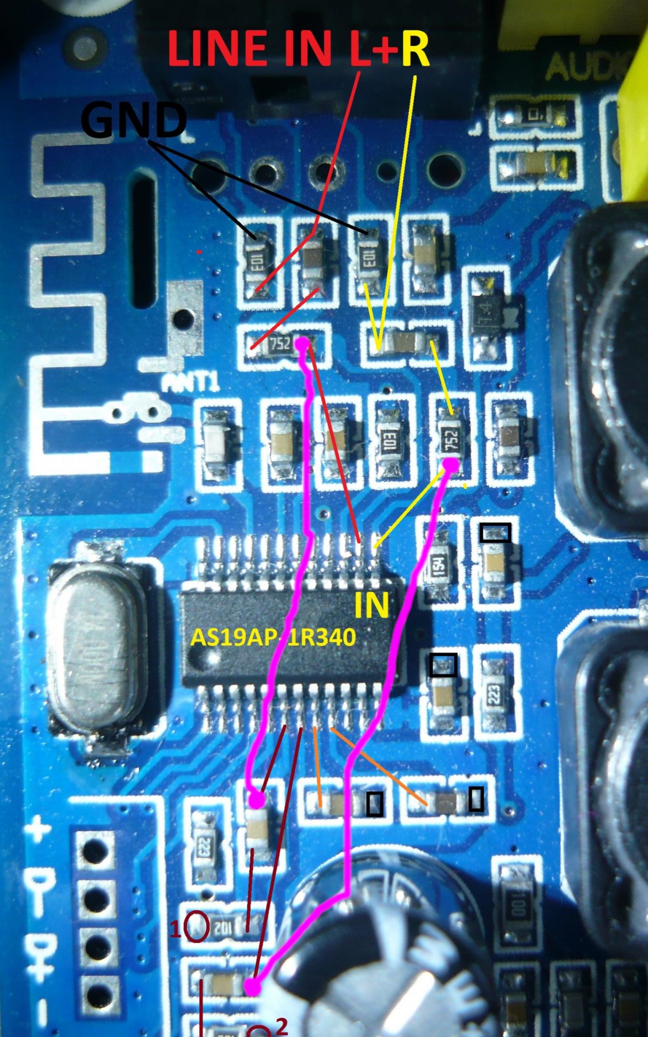

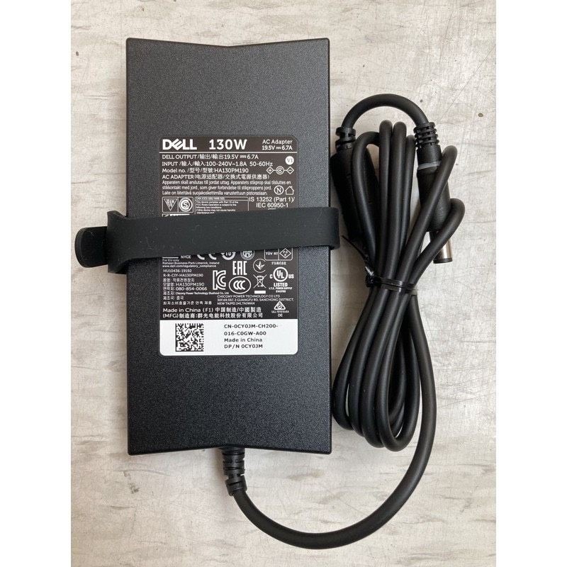

I also have get same board six month ago . And did a lot of mod on it .
The board may hiss when use different adapter . Finally with Dell Notebook adapter (19.5V/130W) then it quite on my side..

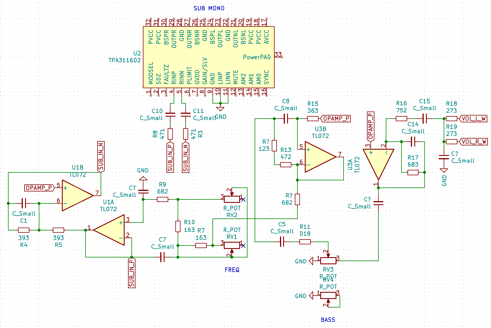

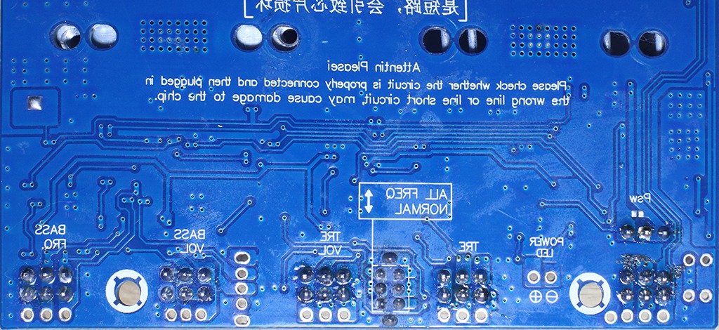

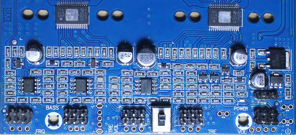

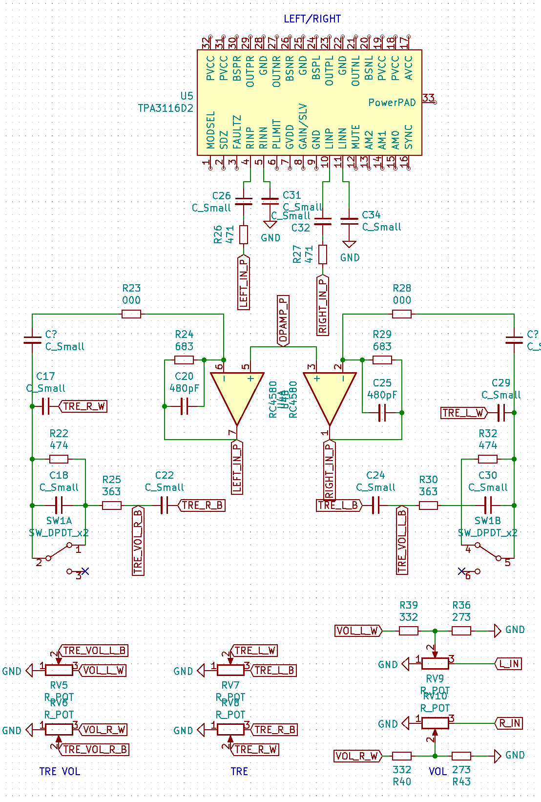

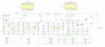

Here are some diagrams get from forum (Thanks forum !) related the board. Hope it have some help.
Some diagram is "early version of board" schematic not full match the one you have ,but some part still could reference
