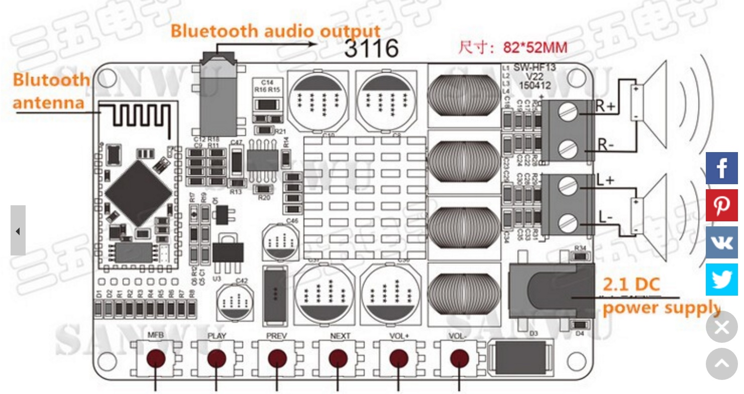

Amp is also (originally?!?) available with TDA7492P. I've seen versions of the board advertised both with and without the 3.5mm jack though.

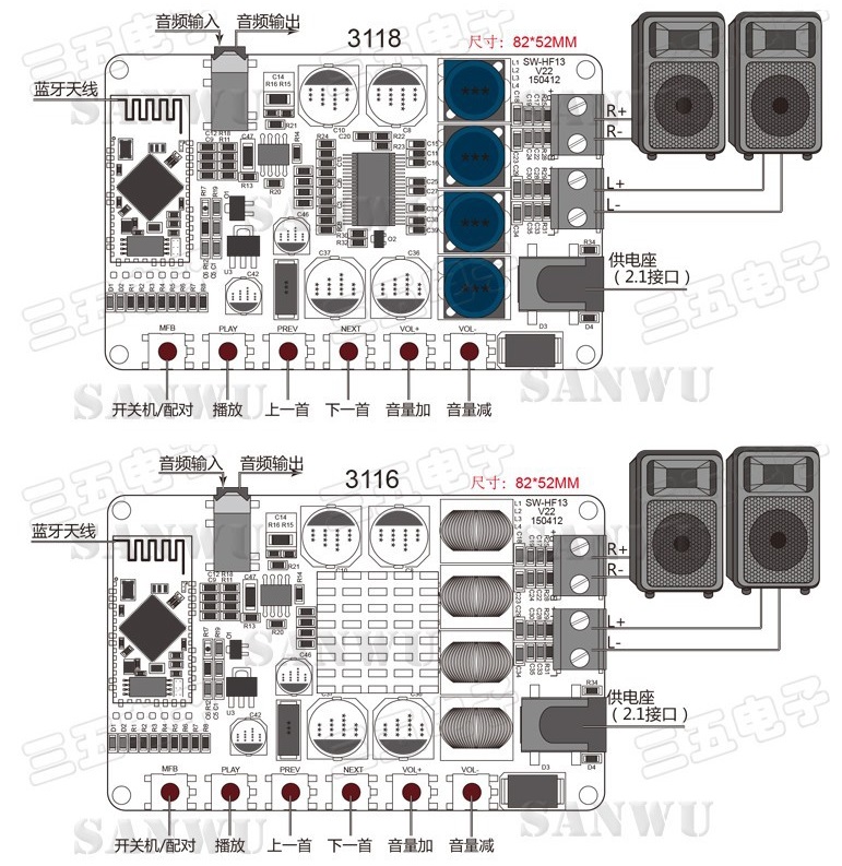

English diagram for the 3.5mm enabled boards implies the jack can be an input or an output. At a guess, it's an input unless something pairs...
Yet on alieexpress an (english) drawing shows it is just an output for 3116, for stm 7492 same seller shows it is both an output and an input, so probably only thing one could do is ask Sanwu, they have shop on Taobao, search tpa3118 and you'll see an ampboard offered by them, they probably also have own shop Aliexpress, you can try there too if you can find them.
That's the thing - it doesn't take over when aux is plugged in. It acts like an output when BT is connected. It only sends sound coming from AUX to speakers when amp is making its startup and pairing sounds. in every other case its silence.

If you read "Use:", down toward the bottom of the ad, when BT has paired the analog input should be disconnected.

The MFB should only be pressed to activate the BT and start the pairing when there is no analog input.
Holding the MFB button down for a couple of seconds switches off the BT and the analog cable can be inserted. The MFB, I would say is just BT on/off and has nothing to do with powering up the amplifier
