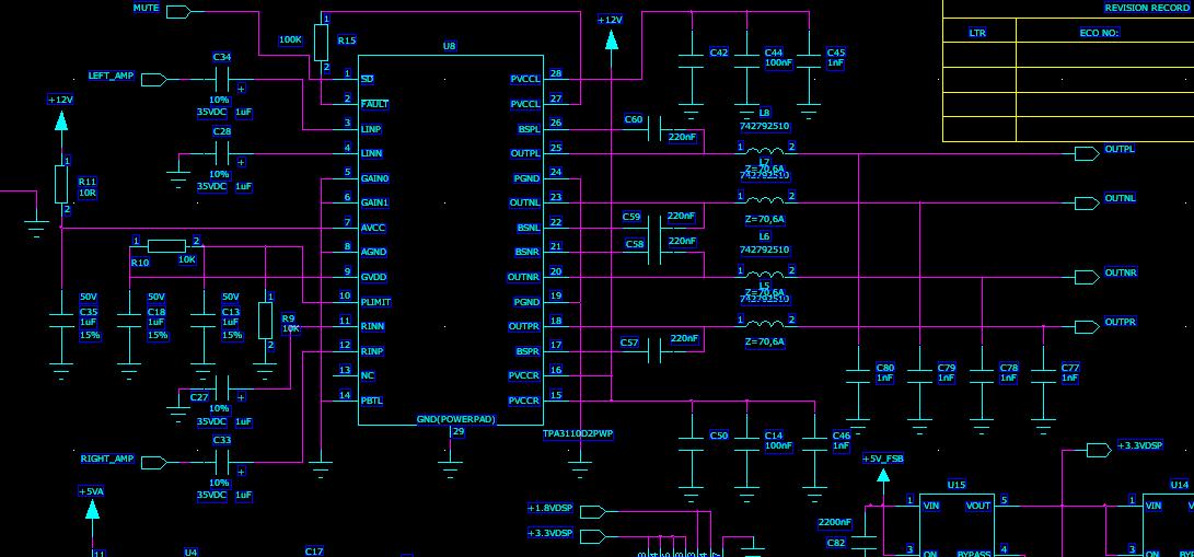

Hey out there,
This is my first class D amp project, it's built around the TPA3110D2 IC from Texas Instruments (d/s here) I have essentially used the schematic right from the d/s (fig. 37), with a few embellishments from the evaluation module schematic (evm d/s with schematic here) (i.e. gain control jumpers, adjustable power limit, a ferrite bead on the power supply, not really sure what that's for...). All that aside, the compound schematic I came up and am using for this project is here. I'm powering the unit from a 14.4V NiMH battery pack (12 D cells) and the audio source is my mp3 player (iPod.) Currently, the amp is set up to drive a pair of 4 ohm, 100 W rated power speakers. (4 inch)
My problem is this:
The amp only seems to work at low volume. As soon as I turn the iPod's volume above a third of it's capacity, the amp starts to auto-reset for some reason. After sniffing around on the internet, I am starting to wonder if it is shutting down due to over-current protection as a result of using low impedance (4 ohm) speakers. Does anyone out there have any knowledge of what might be going on here and what I need to do to remedy it? If I had a pair of 8 ohm speakers sitting around, I would have tried that, I'll keep my eyes and ears open for a cheapo pair.
Alternatively, this post leads me to believe that I may be forcing the amp into thermal shutdown. However, according to the d/s, thermal shutdown is not reported on the FAULT pin of the amp, and whatever is going on with my amp definitely is.
THANKS!
-CHAD
PS - As a side question, if you were going to build a class D amp from scratch with similar exterior component parameters, what amp would you go with? Again those parameters are: 14.4 V Battery pack power supply (somewhere around 2000mAH) and either a single mono or a pair of stereo 4 ohm, 100 W rated power speakers.

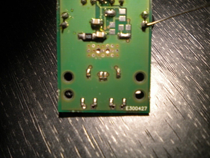

this is what worked for me the big vias are a little les than 1mm.
now i only use solder paste and reflow soldering for smd, less work and cleaner soldering.
Rik

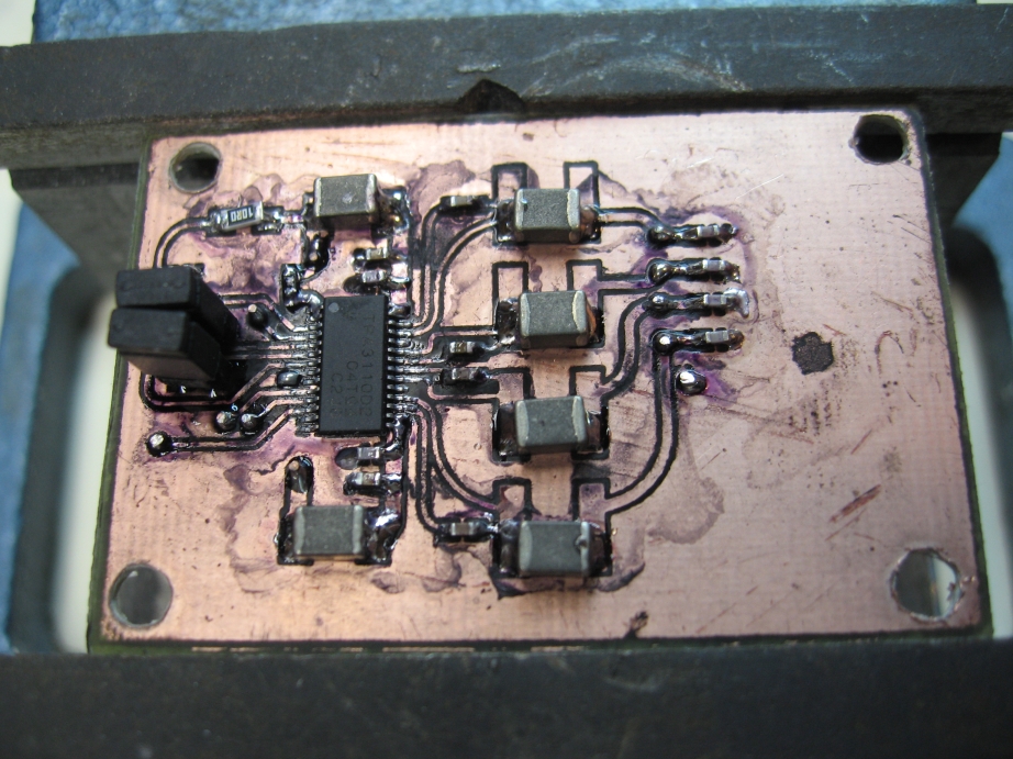

Trouble aplenty
Good news: I got my new work space set up.
Bad news: I seem to have built a dead TPA3110D2 amp. The bigger vias seemed to do the trick to get the powerpad soldered properly. Unfortunately the amp just doesn't seem to want to power up. I can't even get pops or cracks out of it. I've checked and double checked the connections between and to the pins on the amp. I had to fix two shorts and replace a 10 ohm resister (on the AVCC pin #7), not really sure how I burned that up... Maybe there's something I'm missing. Hopefully I'll figure out what that is soon.
I built two test amps previously around the TPA3110D2, and while I didn't perfect them, I could at the very least get them to try...
-Chad

Okay, up and running now. Thanks Nigel, I double checked the data sheet; the over current protection appears to be handled entirely internally. It was all a boneheaded mistake on my part due to a fairly shoddily etched board (I ran out of some of my materials and decided to try to make due by making on-the-fly repairs to a poorly etched board.) The culprit ended up being that pins 9 and 10 (GVDD and PLIMIT respectively) were shorted to ground. Sorry guys, newbie mistake... fittingly so.
The proper grounding to the powerpad made all the difference with the auto-reset. Seems to be all cleared up. Thanks again Sonnya and Rik. The TPA3110D2 is a dandy of a little chip, I look forward to using it in some future projects now that this kink is worked out.
