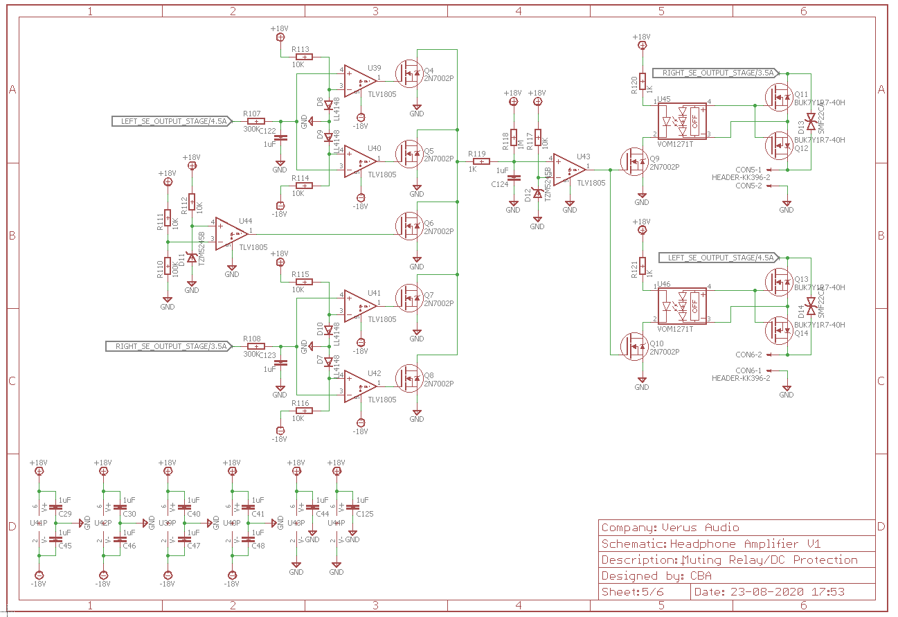

Some inspiration.
Positive rail detection(could detect negative rail as well, but positive rail collapses first due to higher current draw), DC offset detection for each channel, Turn on delay circuit, Solid state output relay.
It works, no turn on/turn off thump, pop or plop.
You wont hear anything at all when turning your amp ON or OFF, providing you have no sound playing, just silence.
Solidstate relay is the way to go.
To make it simple, drop the DC offset protection and just go with the Positive rail detection, Delay circuit and Solidstate output relay.
