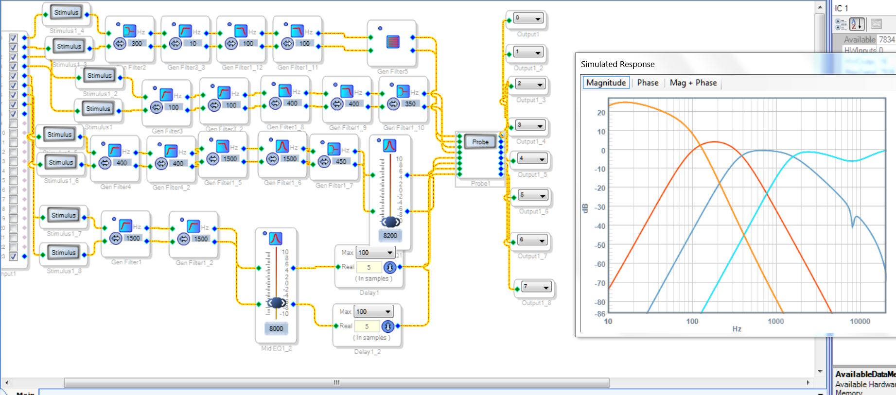

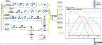

RE DSP, the sigmaDSP chip that the minidsp is built around is fully capable of handling 24bit/192 khz. What happens though is that the number of computations it can process per time frame decreases proportionally as the sample frequency increases. So if you're pushing the limits with a 48khz system, you'd need something 4x more powerful to handle 192.
The minidsp chip uses one of the lower power sigma chips, the advantage is that it comes with A/D D/A conversion built in, so makes for a very affordable 2 way stereo DSP. Although in absolute terms the A/D D/A converters are very low quality as far as top notch converters go. But then the basic minidps board only costs $99, so you can't expect ESS sabre or PCM1792/4 quality converters.
I've been experimenting with the daddy of the chips, the ADAU1442, in analogue devices purpose built software allowing you to program the DSP without any coding knowledge. Currently I am using about 1/3 its processing power running 24/192 over 4 stereo channels. As you can see in the attached image this uses quite a lot of xover building blocks too so there's plenty of power left available for other things.
I am currently designing a PCB for the ADAU1442 and intend on seeing just what it's like. If the TPA USB interface ends up being what I want I'll probably be buying one to feed into the DSP board.
It might be worth TPA considering such a board themselves. I think there'd probably be a decent amount of interest in a similar ADAU1442 DSP board, with I2S inputs and outputs. Just another board to add to the mix 🙂
In the interest of quality though, the ADAU1442 has an extremely flexible way of handling the various clocks, so I'd imagine very low jitter should still be on the cards, if it's configured right. That however I will try and find out for myself.

Sigmastudio certainly looks great. Is it possible to use it with 'retail' boards, or just the eval boards?
It depends on how handy you are with the DIY and how the retail implementation has been designed.
AD manufacture a board specifically for interfacing the DSP evaluation modules with sigmastudio. The board is basically a USB to I2C/SPI converter. If you could modify the retail unit so that you could get access to the control pins, then I am sure you could directly control the chip via ADs USB-I2C board.
SigmaStudio is free on request from AD, but they didn't want to release the firmware programmed into the USB to I2C converter. Naturally this means I'd have to buy theirs, if I want to guarantee success. It isn't outrageously expensive @ $99. Note that AD don't allow a company to provide SigmaStudio along with their product, the company would have to write their own software.
Sigmastudio will output the code that's actually used to program the DSP chip, in both hex and binary. So I am sure it wouldn't be too much trouble for someone competent at micro controller programming to write their own program that could upload the hex file to the DSP chip. Currently I know zero about programming, but I have a project coming up where I intend to learn!
The brilliant/interesting thing about the sigmadsp chips is that they aren't hugely expensive. I think the ADAU1442 will cost me something like £15 each? And to make a board with I2S inputs/outputs would require nothing more then the DSP chip, a few caps and resistors, a crystal, a voltage regulator, a E2PROM and the headers. So it's cheap and small seems perfect for TPA board 🙂
If you're intending on buying a retail product, to use with ADs USB-I2C module I will say a couple of things.
The 1442 can operate either with a micro controller sending it the code, or on boot it can grab the code from some E2PROM memory. The E2PROM memory isn't built into the chip and has to be provided separately, but once in place it will allow the chip to self boot, without the need for a micro controller. (Instead of the micro sending the 1442 the code on boot up, the 1442 grabs the same code from the memory instead. You have to select what boot mode you want to use by altering the state of one of the 1442s pins.)
You would have to make sure that the retail product is configured in the correct way, or that you could modify it to be, otherwise it'd be a pain to use. Do you know of any retail products that work around the sigma chips besides the minidsp?
