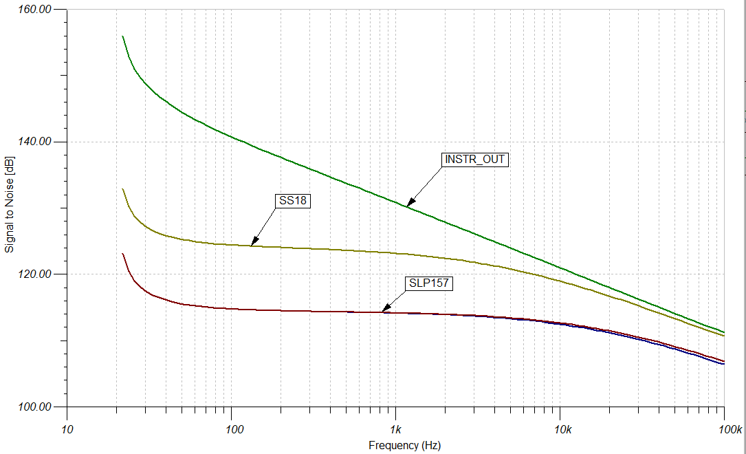

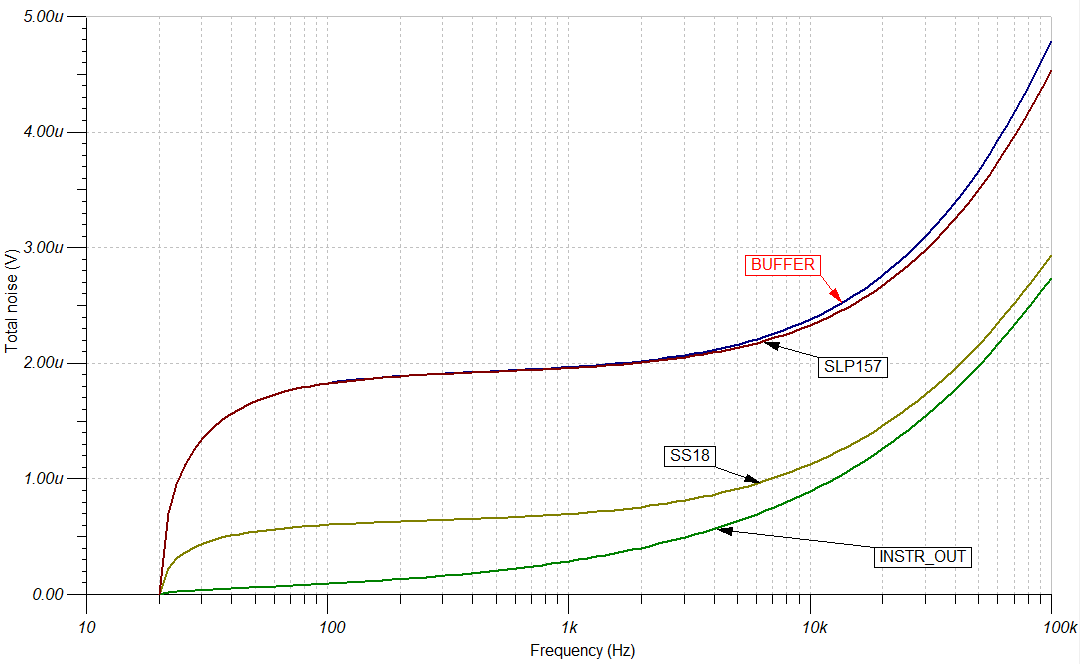

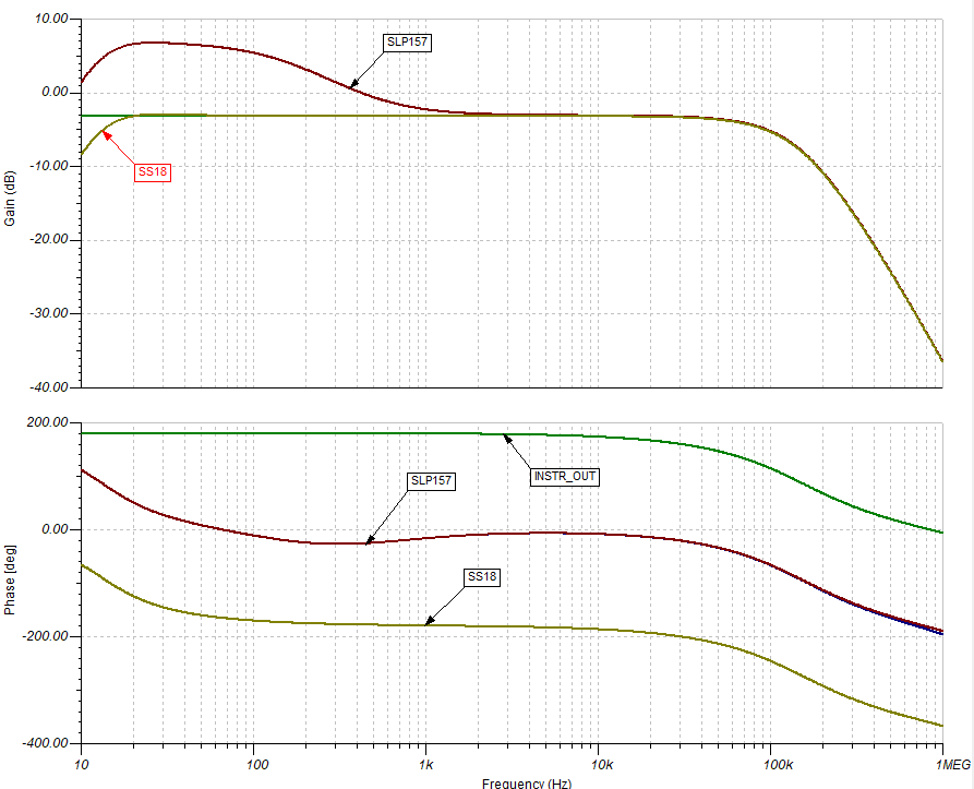

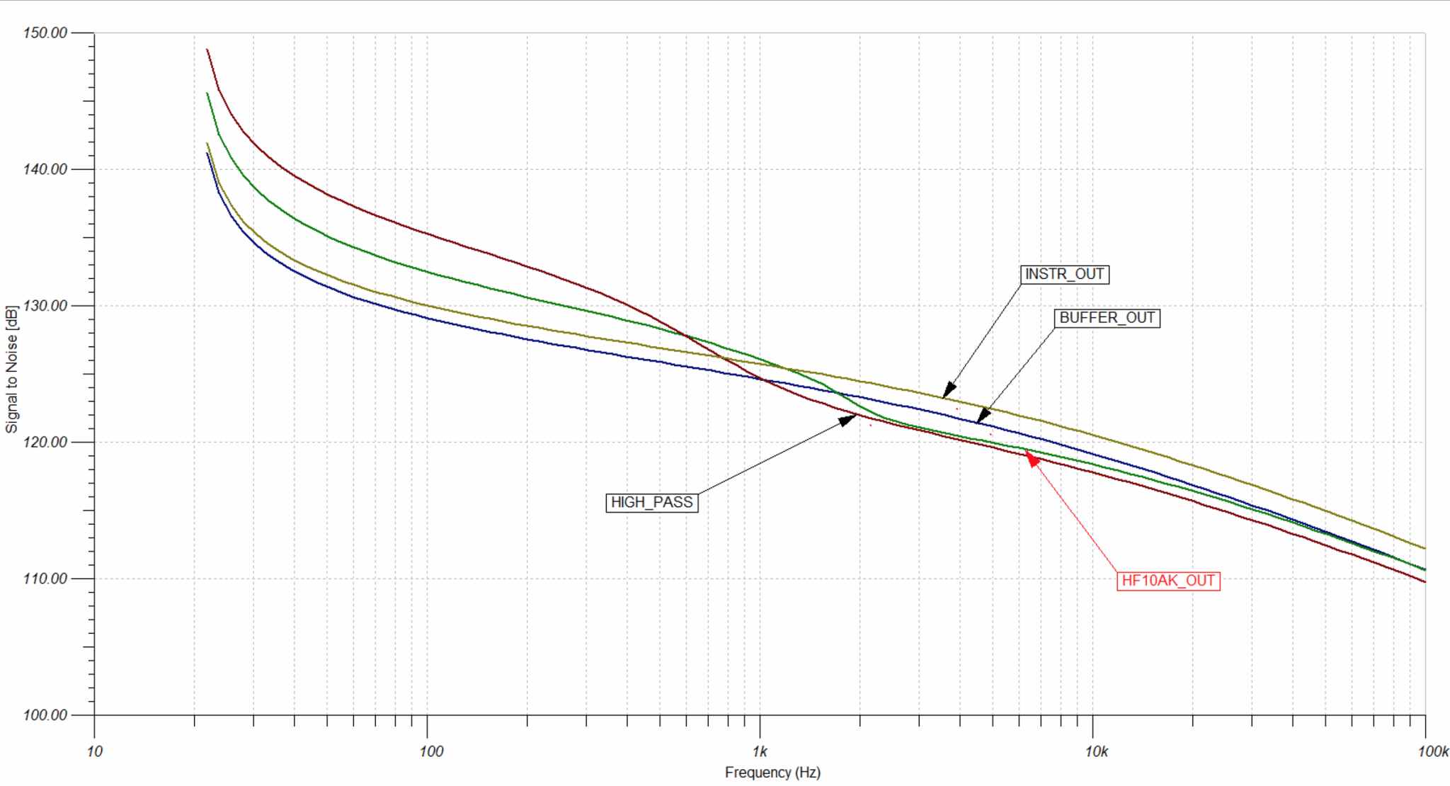

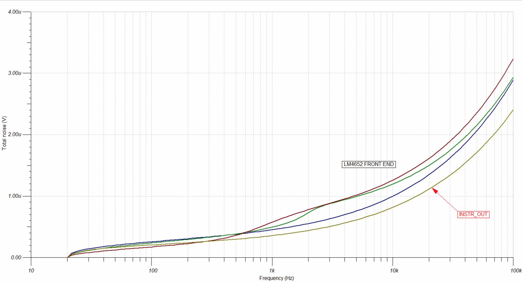

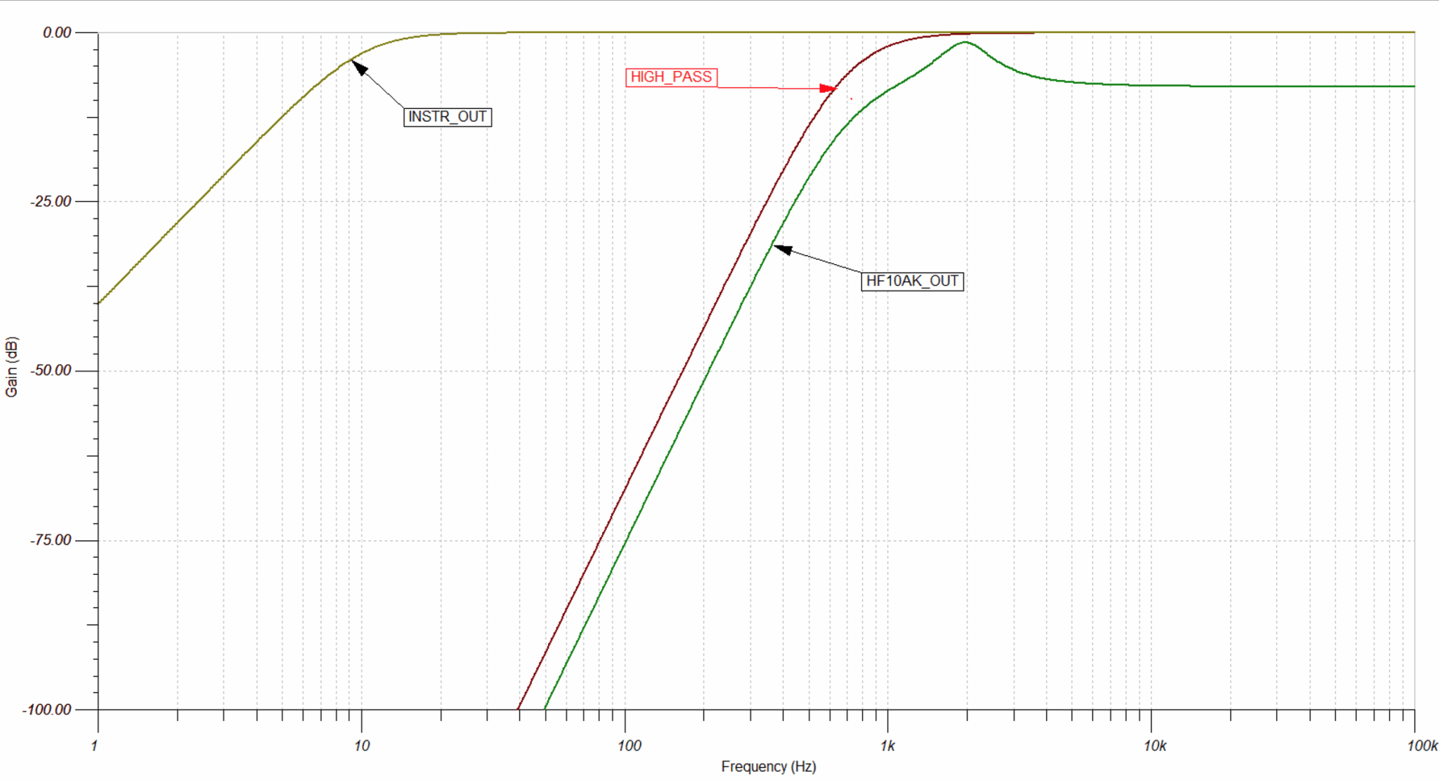

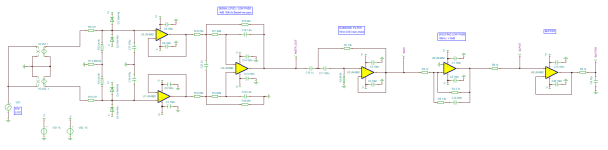

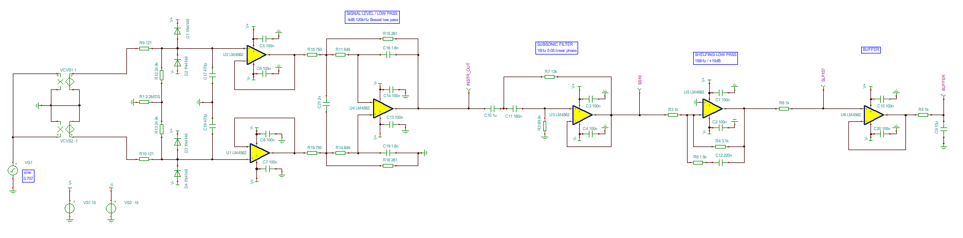

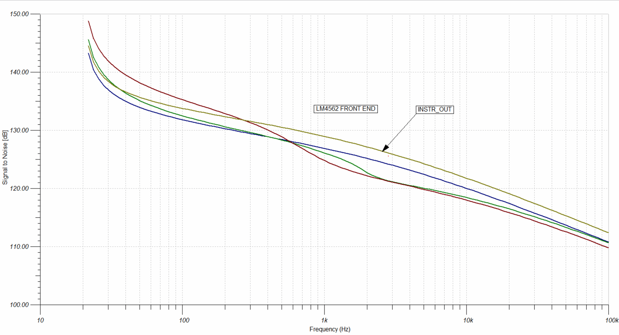

I am working on an input stage to marry with my latest speaker design (12P80ND + HF10AK).
Here is the input stage thus far.
Simple balanced instrumentation front-end, high-pass filter for subsonic filtering, and a shelving low-pass filter.
The signal chain may be quite long after the buffer downstream to the woofer and the cd.
I'd like to maintain a transparent signal, if at all possible.
Attached v1 of the TinaTi.
