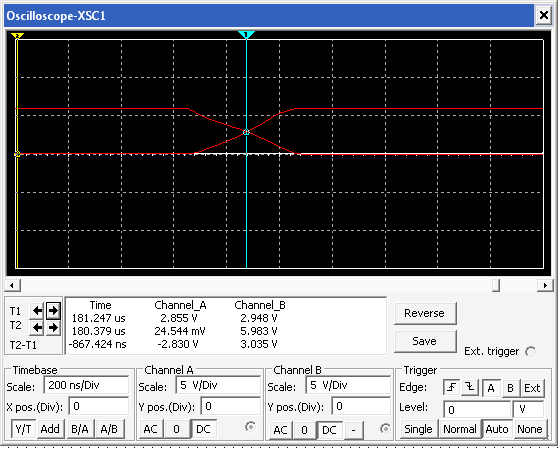

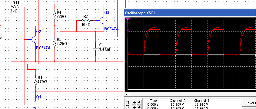

Hey all, I just invented smth but i am scaried because these two voltage dividers give 6v and if oscillation stops, both fets gonna hell conducting ..
another possib. is before oscillation starts and actually this means its impractical to use 🙁
any opinions ?
i tested it versus normal wiring but not tested versus real totem pole.
anyway it is totem pole itself but uses internal transistors 🙂 and saves 2 bjts
tommorow will find out if there is a difference between 1.5$ mosfet driver and a totem pole for free 🙂

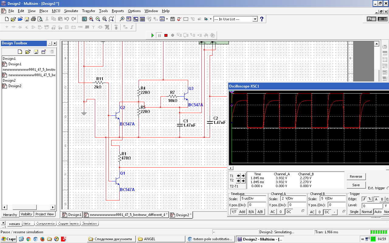

I see totem pole not solves both fets conduction and I realized that if I use 6v instead of 12 for the fets, the cross point where fets conduct will not be 5.6v but 2.8 and they are not gonna conduct at 2.8 🙂
I think 6v is enough for good fet saturation
