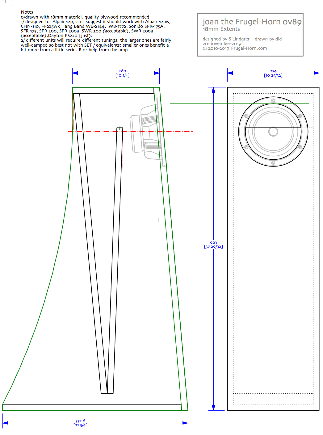

Thanks Dave for the kick back first of all. Also I would be willing to go a little higher for the price on drivers. I've been looking at the Mark audio drivers and would like your thoughts about the pluvia or Alpairs, would they be a better driver than the CHN line. Also I noticed that there are a couple different variations on the frugal horn speaker cabinets (XL...MK3...etc). Which one do you recommend for the drivers. Thanks again for the info. its much appreciated.
The A11ms is very good. But much pricier than CHN110.
If your budget is $100/driver you can almost reach the A11ms.
There are 4 memebers of the Frugel-Horn family, FH-Lite, FH Mk3, FHXL, and Joan. A11ms goes in XL, CHN110 can be fitted in XL, but is better in Joan.

Would the chr120 work in Joan or do they require something larger? If the 110s work better in the JOAN then i might just go with those. I saw the plans Allen provided for the JOAN i believe but I didn't see the measurements for the internal boards. Also Dave where/how do i do the donation for the plans?

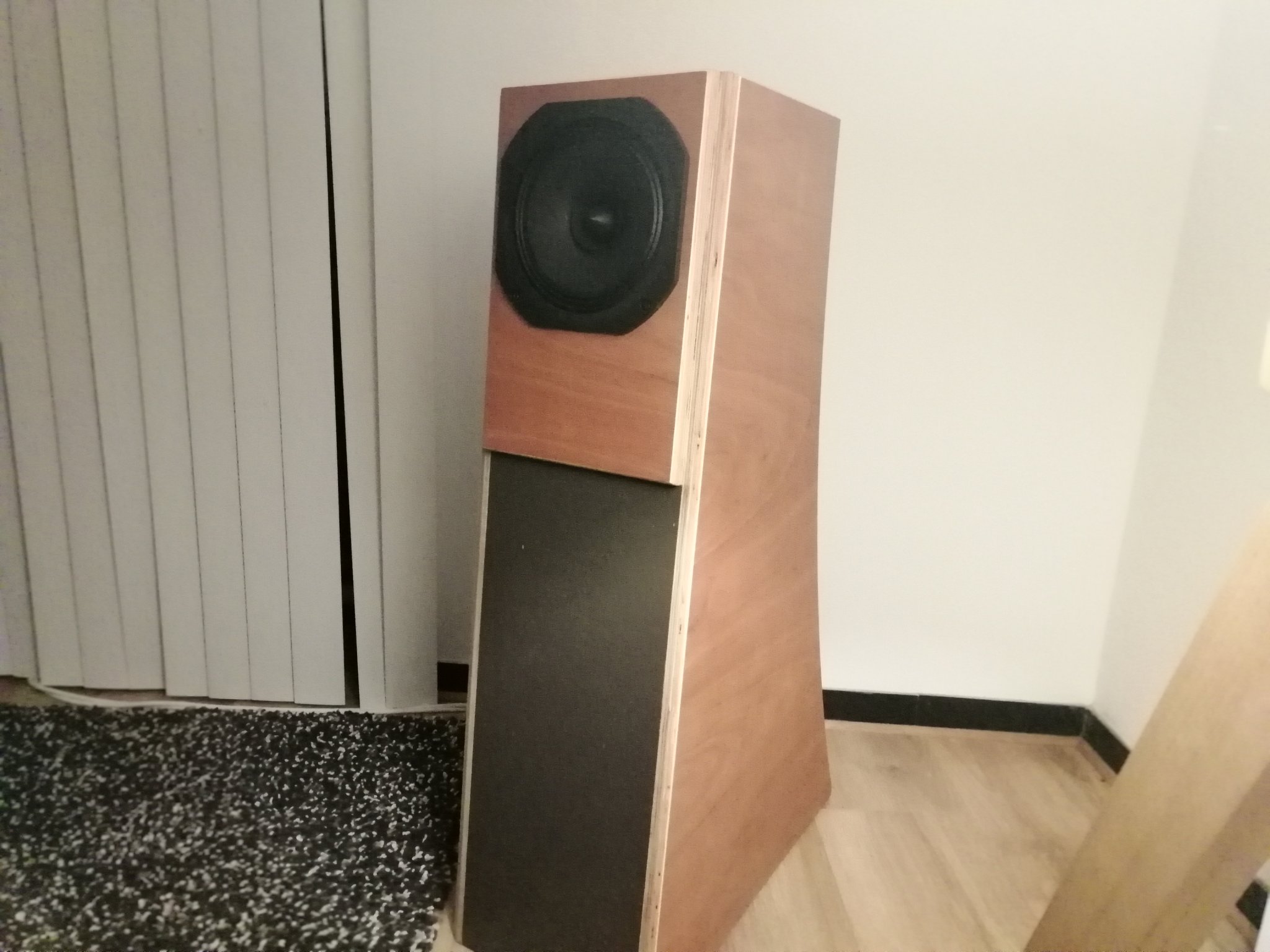

Thanks yves and that fh is great looking....did you double the baffle under the driver or is that how the Joan looks?...sorry if that’s not the right term but I’ll check on the 10p also
Hello, I had to add it because the hole that I made originally was for a Lii silver 8, when switched to the chr120 the hole was too large so I had to use a baffle, now that I changed again for the EMS driver I had to enlarge it again... 🙂
