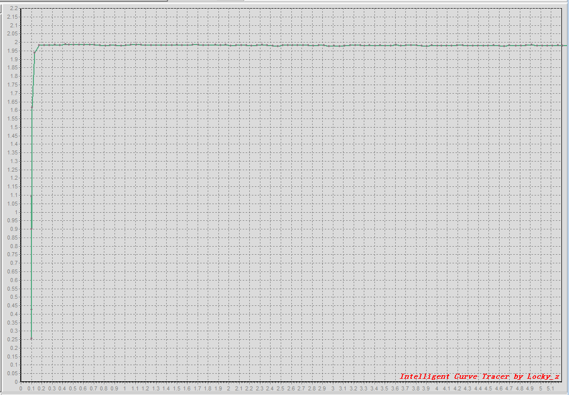

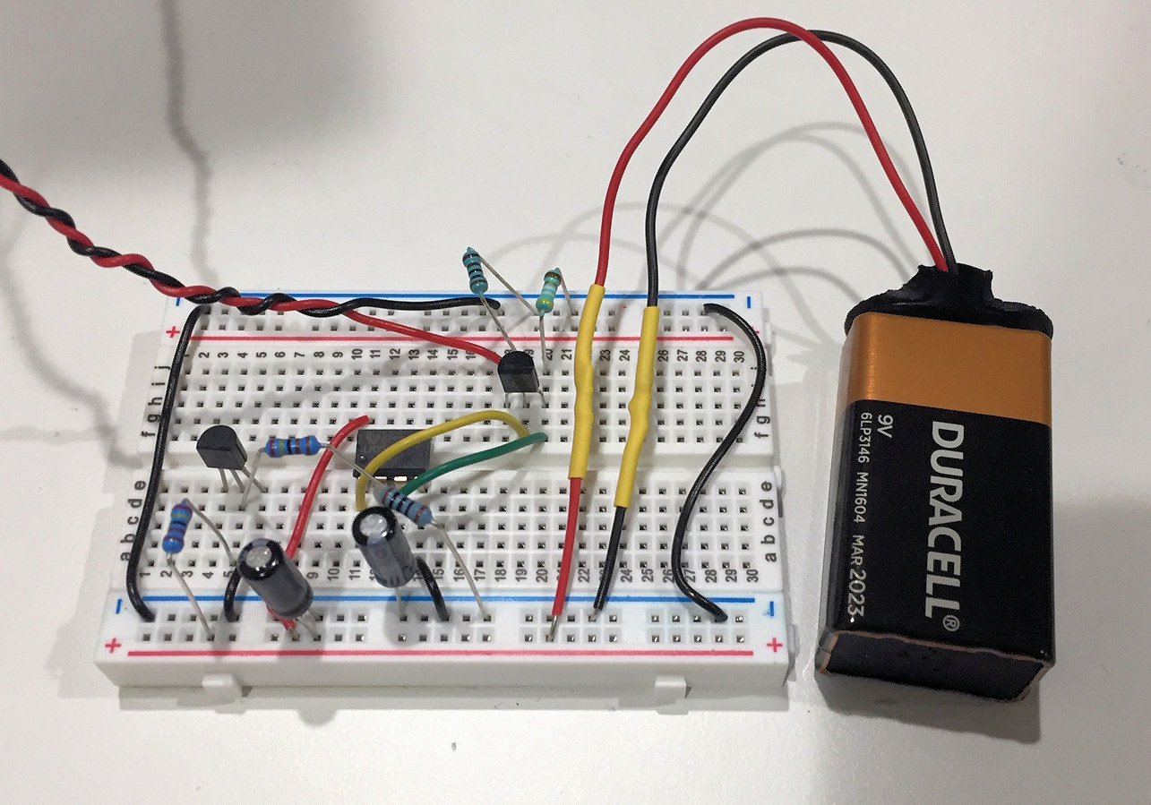

Here is a constant current source made with silicon devices (BC337, LM358) whose output current remains a constant 2mA, all the way down to 0.15 volts.
_
