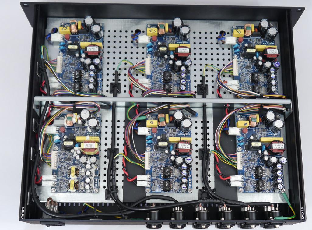

So what would I want to use to "turn down" the amp power? I have way too much available power for the application that I'm starting with. (although it will be excellent for future projects)
Is there a good way to limit power output, without degrading performance?
I don't want someone to damage my speakers, if they aren't familiar with the equipment. I need to put it in "valet" mode, so to speak...

I don't have experience with your particular amplifiers but with the minidsp you can control the gains on both inputs and outputs, lowering those into a sweet spot should keep your speakers from being over driven. It's what works for me. Good luck!
That might be it. The board has 3-pin connector for a mono potentiometer to do the job. The pot could be installed behind the amplifier or some other secure location.

If he means IDE/ATA cable, I would use it only for input wires. For outputs something thicker.
Would that affect sound in any way? Introduce any kind of unwanted noise or interference?

But I think the potentiometer isn't directly connected to any of the inputs or outputs, so it probably is noise-free.
I'd be getting the board to go inside the box, not a prepackaged module. Also, this will now be an 8-channel amp.
We're building a custom enclosure.
